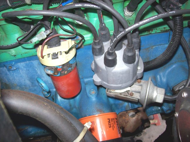

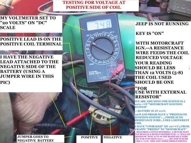

LET'S TRY "KEY ON" (NOT KEY AT "START")AND THIS TEST BELOW (SEE MY 1st PIC AT THE BOTTOM) YOUR RESULTS MAY VARY.

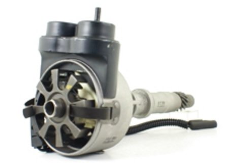

DO YOU HAVE PRESTOLITE IGNITION OR OTHER? NOT KNOWING WHAT YOU HAVE OR SHOULD HAVE MIGHT MEAN YOU HAVE SOME OF YOUR IGNITION SYSTEM WRONG.
MY 3RD PIC IS OF A PRESTOLITE DISTRIBUTOR FOR A 304, NOTE THE 2 PROTRUSIONS ON THE FRONT, THEY ARE PLASTIC, ONE SIDE HAS A VACUUM HOSE CONNECTION
IF YOU HAVE A MOTORCRAFT SYSTEM, THERE IS NO PLASTIC FRONT, THE SIDE WITH A VACUUM CONNECTION WILL HAVE A METAL BELL ON IT. IT WILL LOOK SIMILAR TO MY SIX CYLINDER DISTRIBUTOR IN PIC 4

Ok so I did the test in pic 1 and I get no voltage on the + of the coil. What's that tell me?

Well I did some more checking and I found a wire unplugged under the dash and now it runs fine. Thanks for the help I'm sure I'll need it again
