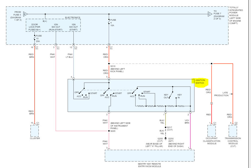

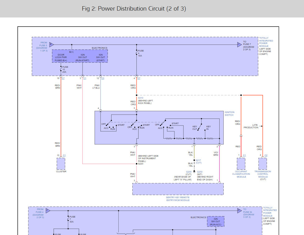

I looked through the schematics and was able to find one pic related to the ignition switch. It is listed under power distribution.,
Take a look through it and let me know if it helps.
See pic below.

This does help some, my car does not have power locks and the pnk/lt blu wire is not there. The only thing i can think of is that they changed the wire color.
1. red/org is +12.
2. pnk/wht is ign sw out??? acc not sure if this is right .
3. it's pnk/lt blu this wire is not there it's a violet wire this is the wire they maybe changed the color on??? but if it's right this would be my start wire.
4. blk/yel is ground.
Does this look right i don't want to break my car or start a fire with it?

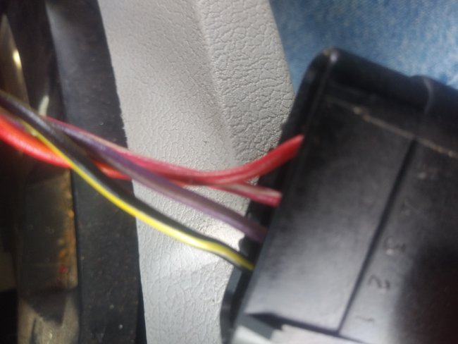

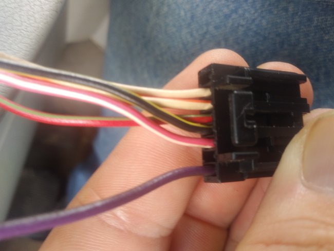

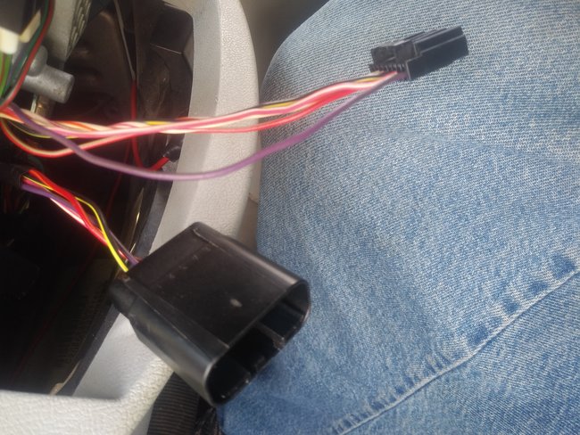

yeah, they have made a miss of things and i don't know what i want to do as of right now can't pull the key cylinder out it's stuck 100% so that's out. oh, i did take some pics of some of the wiring for the key switch wiring and the Sentry Key Module wiring that violet wire goes from the key switch to the Sentry Key Module. i say violet more like a purple wire to me I'll try to add pics of the wire connectors for both key switch and Sentry Key Module.
Aug 10, 2022 at 6:54 AM
BRANDONW2022
  • 11 POSTS
okay, here are the pics i have this way if you guys want to see maybe i'm doing something wrong.
Aug 10, 2022 at 7:01 AM

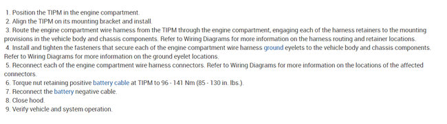

  • 55,433 POSTS
Sure, we can help you out. To me it sounds like TIPM, which is common. Here are the wiring diagrams you need. Just in case I have added how to change the TIPM out which is easy because it-self learns. Check out the diagrams (below). Please let us know what happens.
