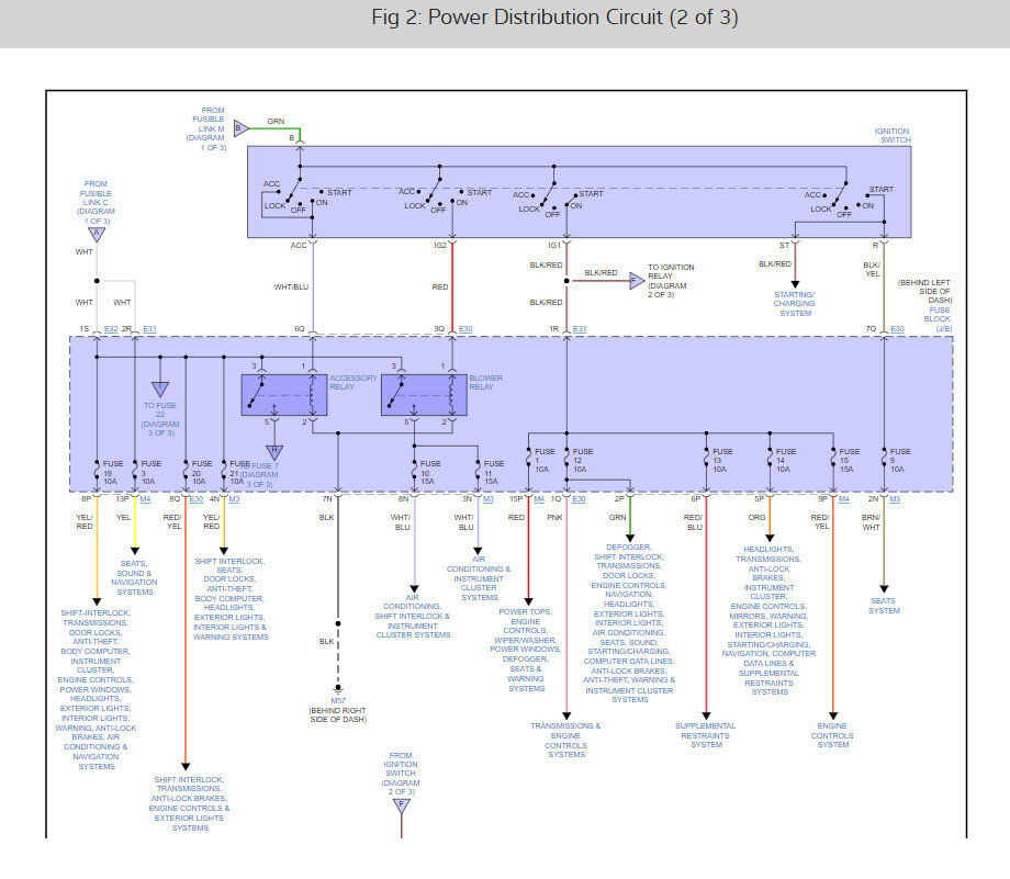

ignition switch wire harness diagram needed?
2004 NISSAN MAXIMA
170,000 MILES • 3.5L • 6 CYL • 2WD • AUTOMATIC
BRANDY78
I'm having to replace the wiring on my ignition switch. The wires came loose from the harness connection. i don't know where what color wire goes back where in my harness.

Yep, here are the ignition switch wiring diagrams as you have requested, and I have included a guide on how to test the wiring as well.
Check out the images (below). Please let us know if you need anything else to get the problem fixed.
