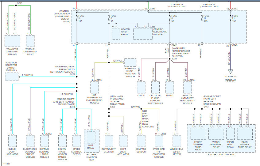

My ignition switch was pulled out and I was cranking it with the tumbler due to my key being worn down.. the wires were pulled out and I can't figure out how to put them back in. I looked up diagram but I'm not getting the same wire colors and places you put them as the internet.. I'm currently without a ride due to this..

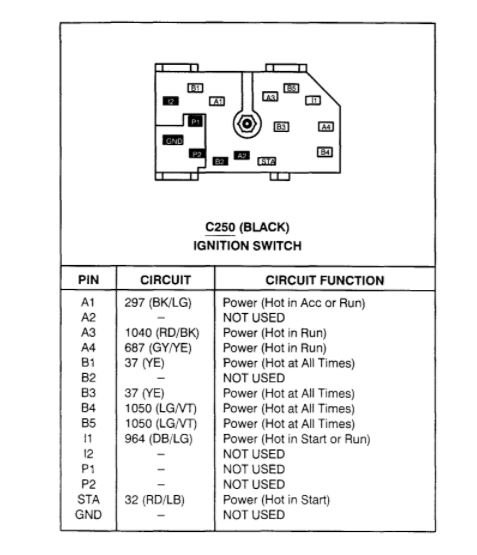

I attached the connector diagram for the switch.
Is this what you need? What color wires are the ones you need to find a home for?

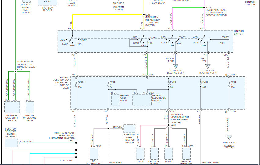

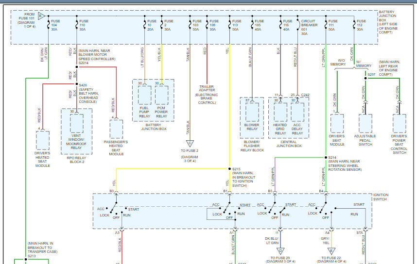

Here is the ignition switch wiring diagram you requested. Here also is a tutorial for you to view for wiring testing:
I've attached below the ignition switch wiring diagram for your SUV. I've cut the picture into 3 pieces so you can view larger. Hope this helps and thanks for using 2CarPros.
