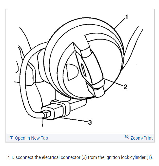

It sounds like to me that the tumbler in the ignition switch has worn out. You should if you go at it jiggling the key and making sure the steering wheel doesn't have any tension on it at least get the key out. Your probably looking at changing the whole ignition switch or at least the tumbler and key.
Tom
Mar 22, 2021 at 10:53 AM
  • 55,433 POSTS

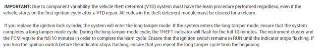

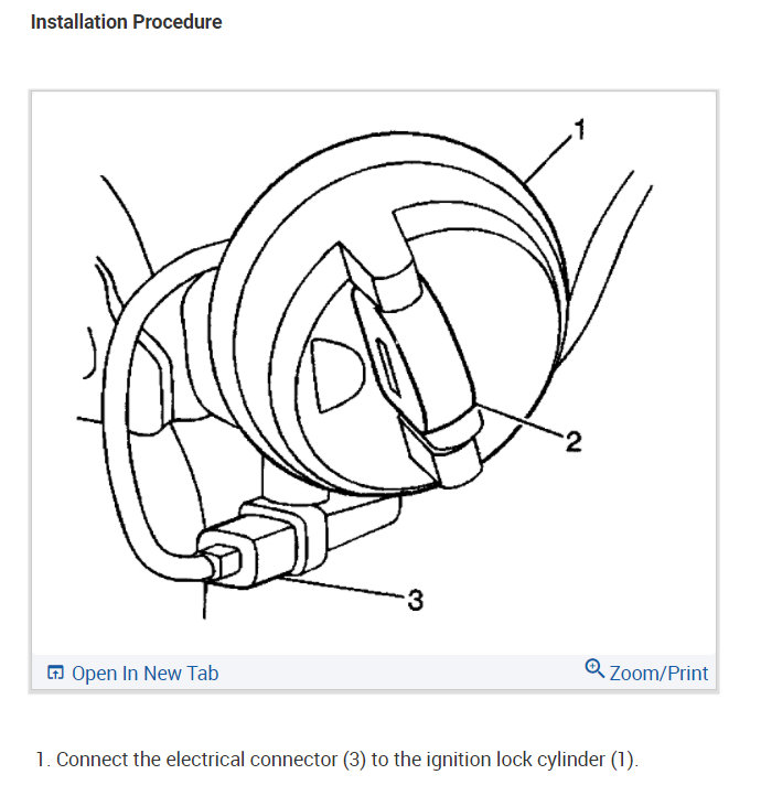

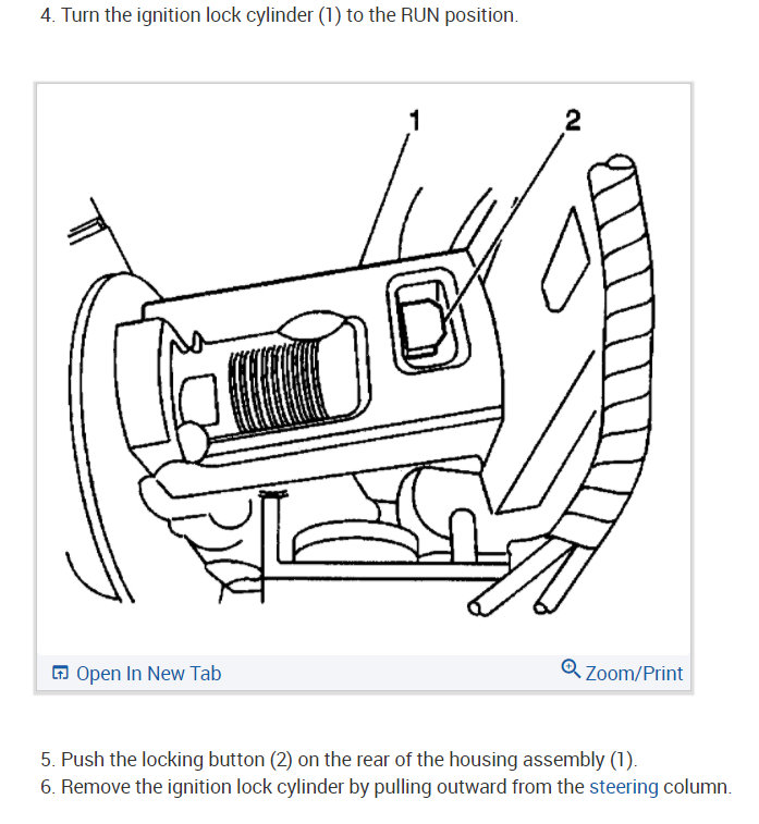

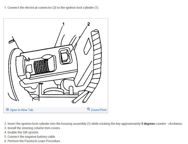

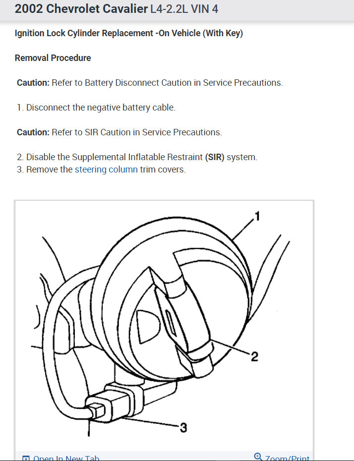

Here is how you change the ignition switch-tumbler out in the diagrams below. Check out the diagrams (below). Please let us know what happens.
