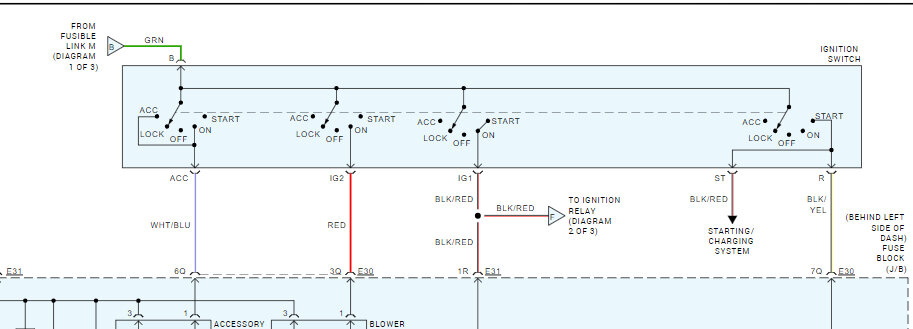

someone please help, I'm so frustrated. i have a problem with my ignition switch. The issue started when the clip that connects to the back of the ignition switch was broken so when i went to replace it, it broke completely away from the wires. I've had to rewire connectors and attach the wires to the back of the ignition. having trouble getting the wires in the right place on the 6 pins of the switch. I'm working with the female side to the male side of the switch. Please help me figure out where they go. Can someone send me a picture or diagram please? thank you

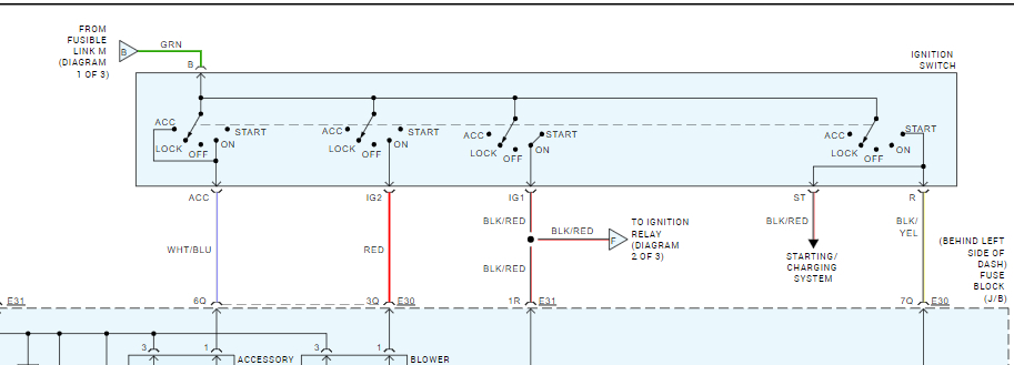

Can you please upload an image of what you are trying to do? Also here are the ignition switch wiring diagrams which will match the terminal identification on the switch or electrical connector. Check out the images (below). Please let us know what happens.

if i have 6 pinouts on the ignition switch key side 3 on top 3 on the bottom inside the clip which color wire goes to which pinout.

Please look at the ignition wiring diagrams above to show where all 6 wires go. The ignition switch electrical connector should have small IG1 and ST and B on it. Can you upload an image of the problem so I can help?
