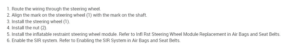

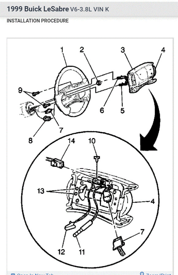

Hello, I'm just looking for diagrams to put the new ignition switch back in. My boyfriend has it close. But there's been a span of time since he took it out. So just need a diagram of parts of where they go when putting the steering wheel back on.
Thanks,
Brandy Clements
Apr 19, 2022 at 8:03 AM
  • 110,244 POSTS
I attached the directions for reinstalling the steering wheel. If you need other information on the switch, let me know. Also, please confirm if it is the ignition switch (electrical component) or the key lock assembly (where the key inserts) that is needed.

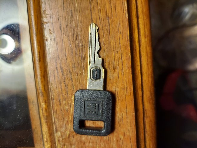

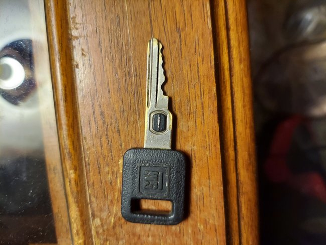

Ugh is right!!! I'm praying its simple fix. But I'm going to send you a pic of my original key really quick..
Apr 19, 2022 at 12:19 PM
BRANDYCLEMENTS
  • 6 POSTS
This is our old key.
Apr 19, 2022 at 12:27 PM
  • 110,244 POSTS

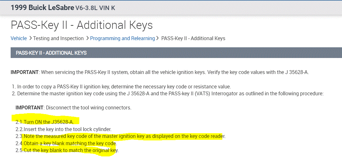

Yes, that has the register; thus, it has the pass-key system. I'm sorry. I wish I had better news.
Even if the new lock cylinder would have come with a resister key, it still would have needed programmed.
If you look below, it explains how to simply add a "new/additional" key. Don't lose your original key. It is needed to be able to reprogram the new resister key that is cut to fit the new lock cylinder.
Let me know what I can do to help.
See pic 1.
