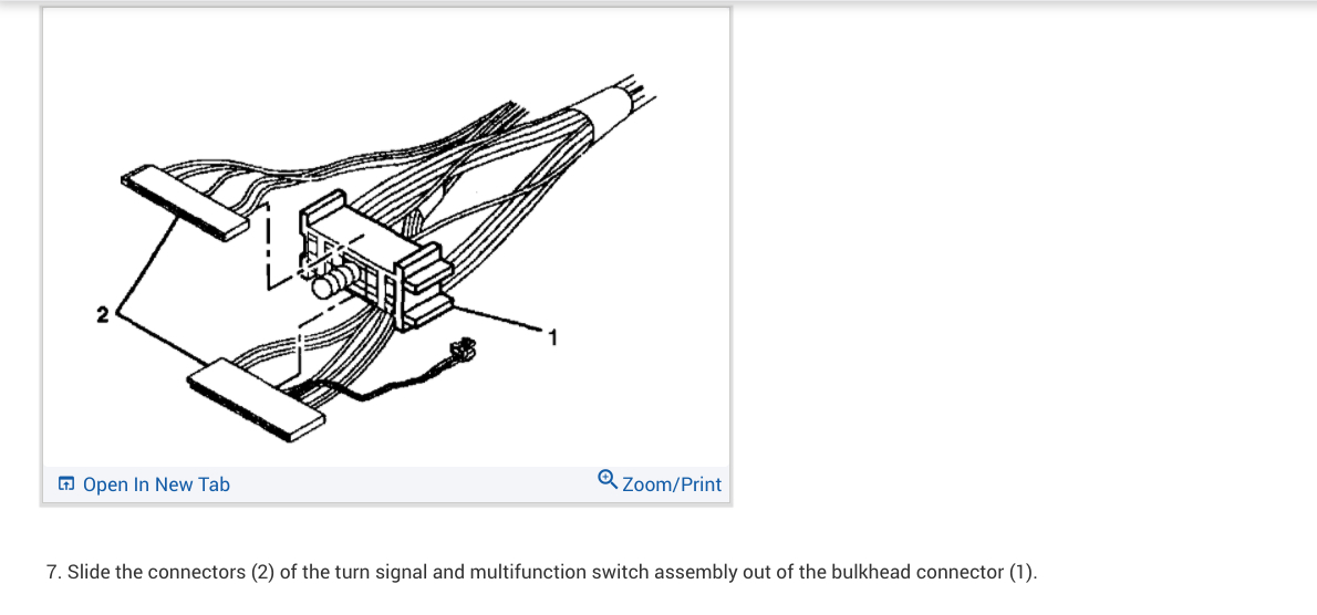

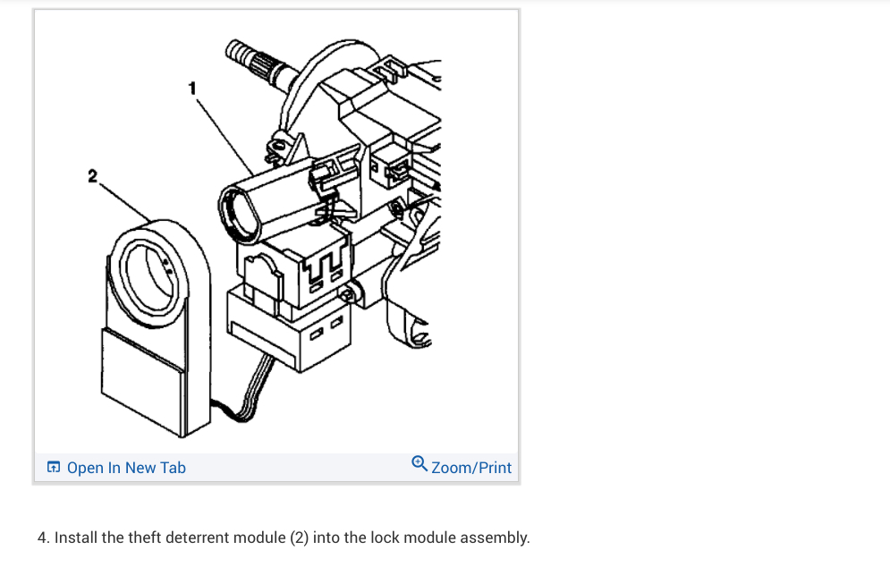

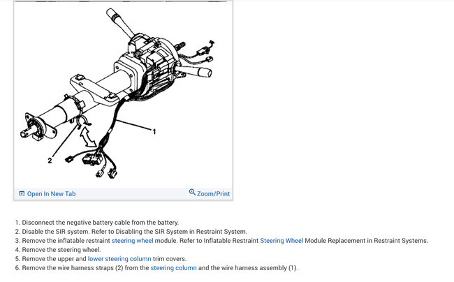

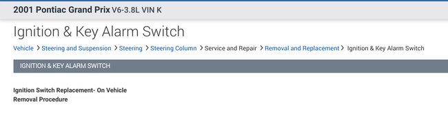

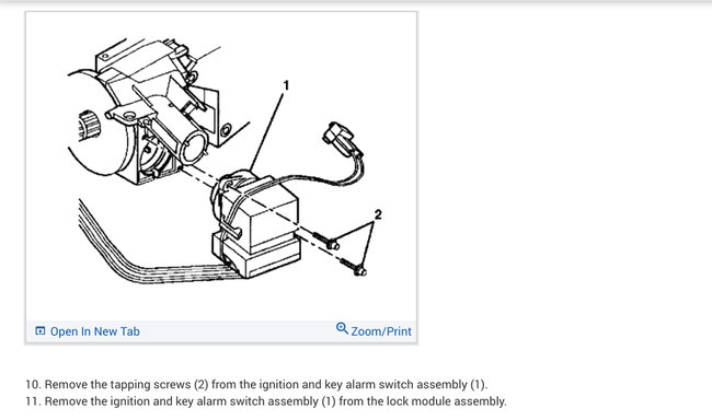

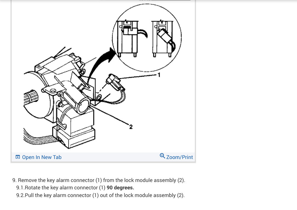

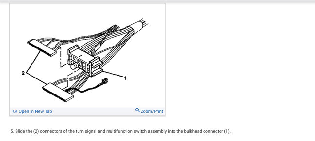

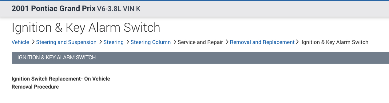

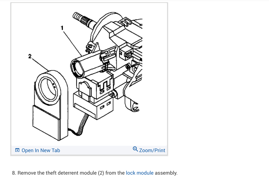

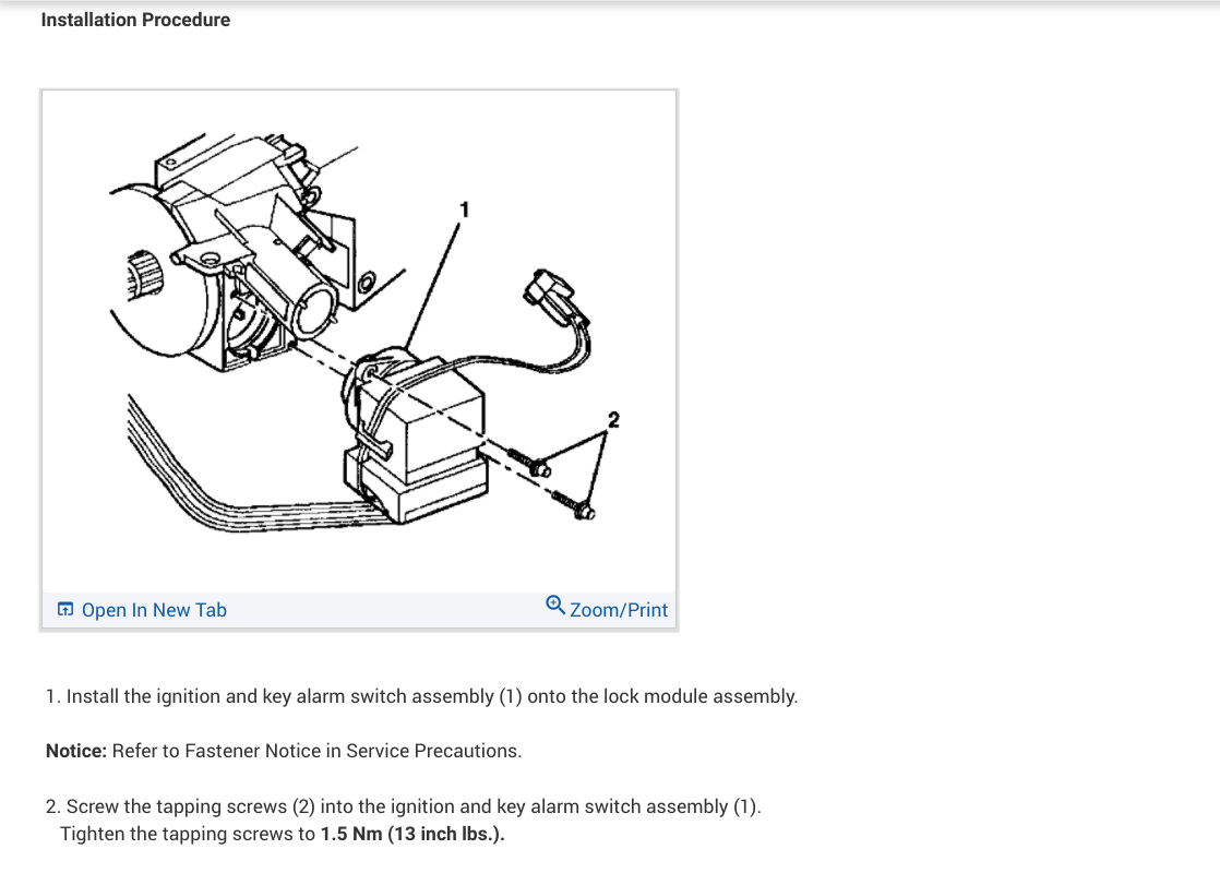

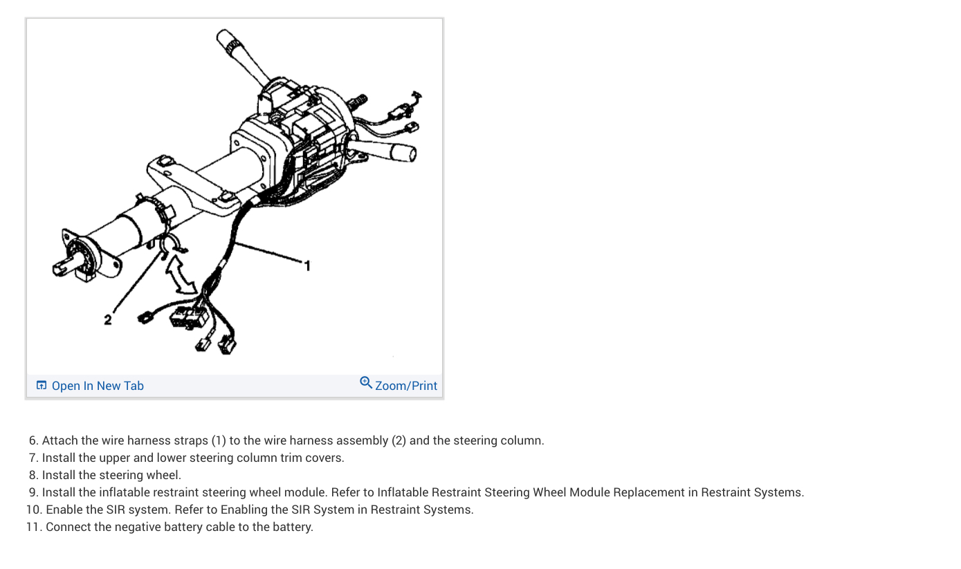

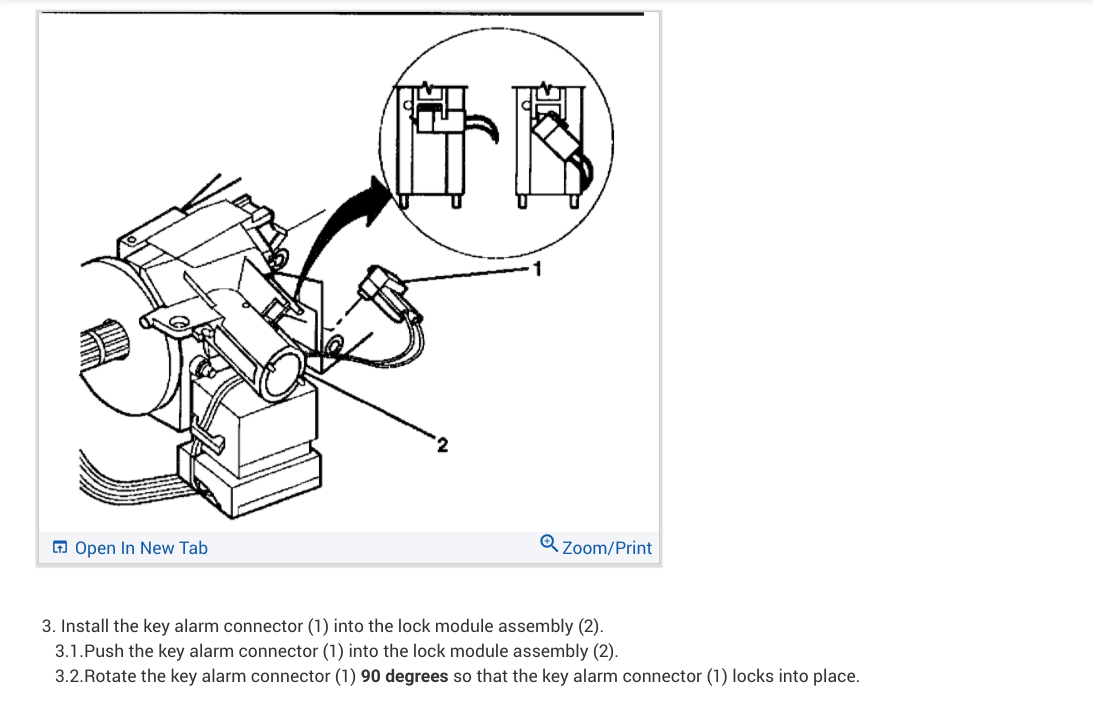

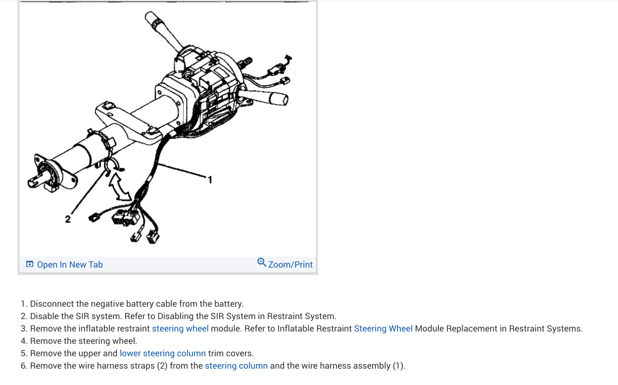

After pulling key cylinder what are steps to remove ignition switch. seen video showed steps up to that then it stopped.
Jan 6, 2020 at 11:50 AM
SCGRANTURISMO
  • 4,897 POSTS

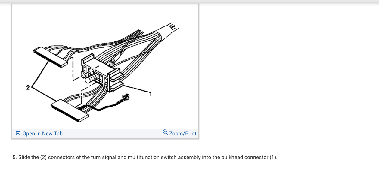

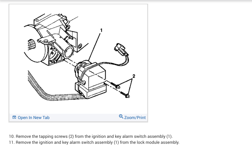

I have included the instructions from the vehicle manufacturer for the removal and installation of the ignition and key alarm switch for your vehicle. Please go through this guide and get back to us with how everything turns out. I hope this helps.
