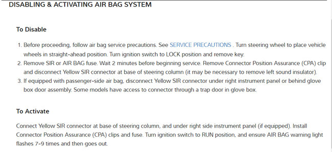

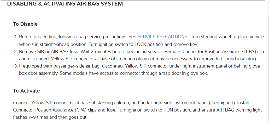

Ignition switch replacement
1996 PONTIAC FIREBIRD
146,000 MILES • 5.6L
HAR64
Remove and replace ignition switch.

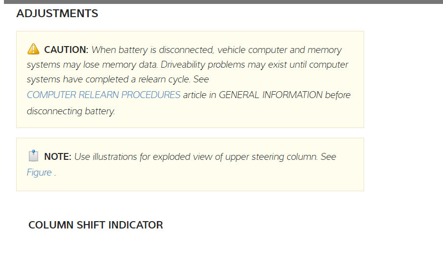

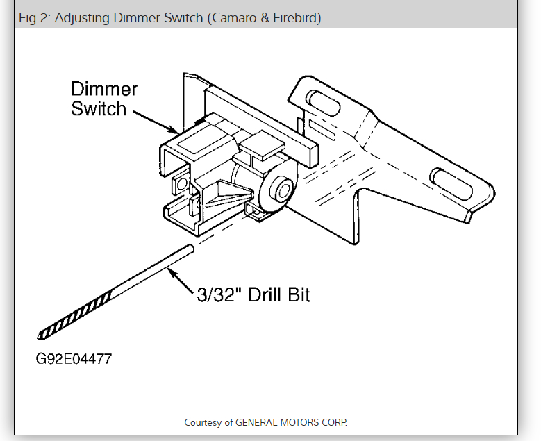

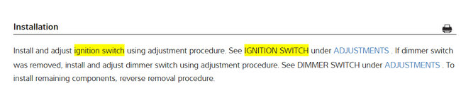

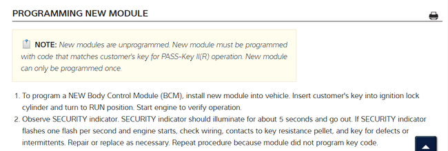

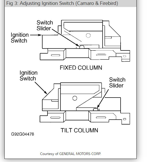

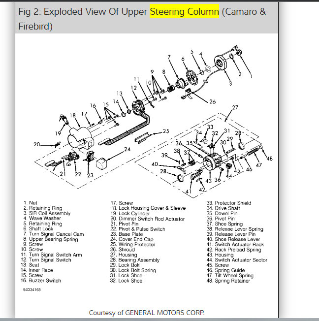

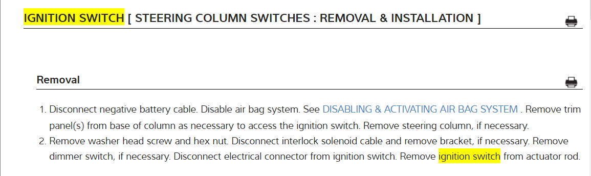

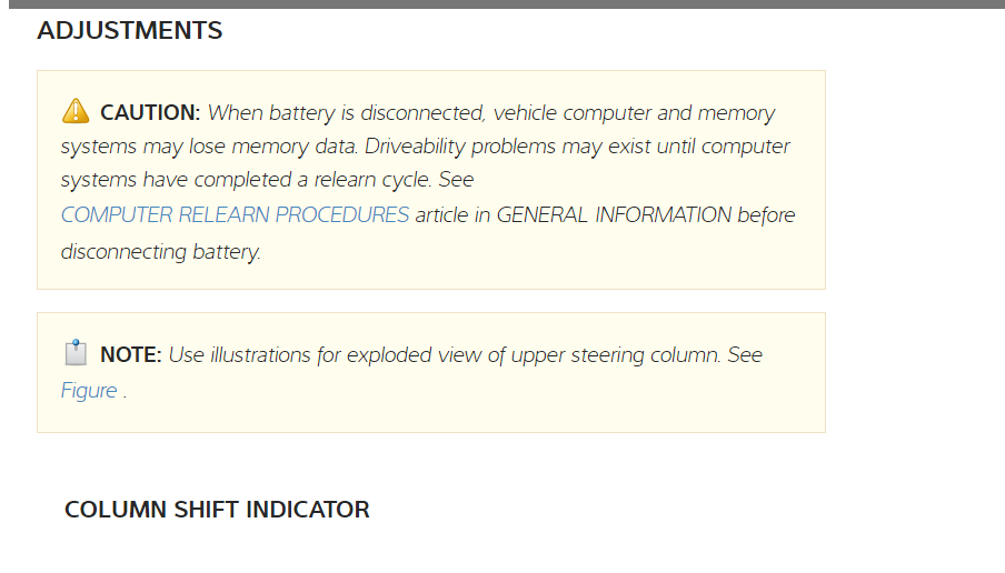

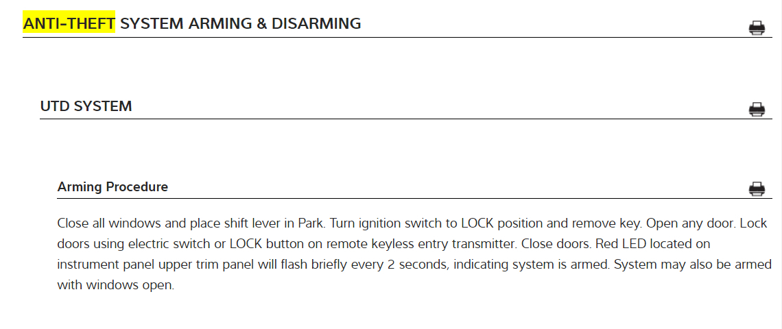

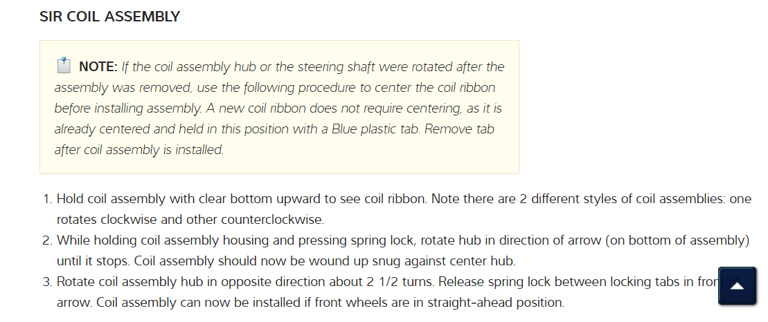

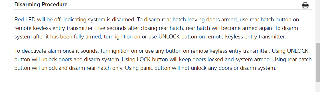

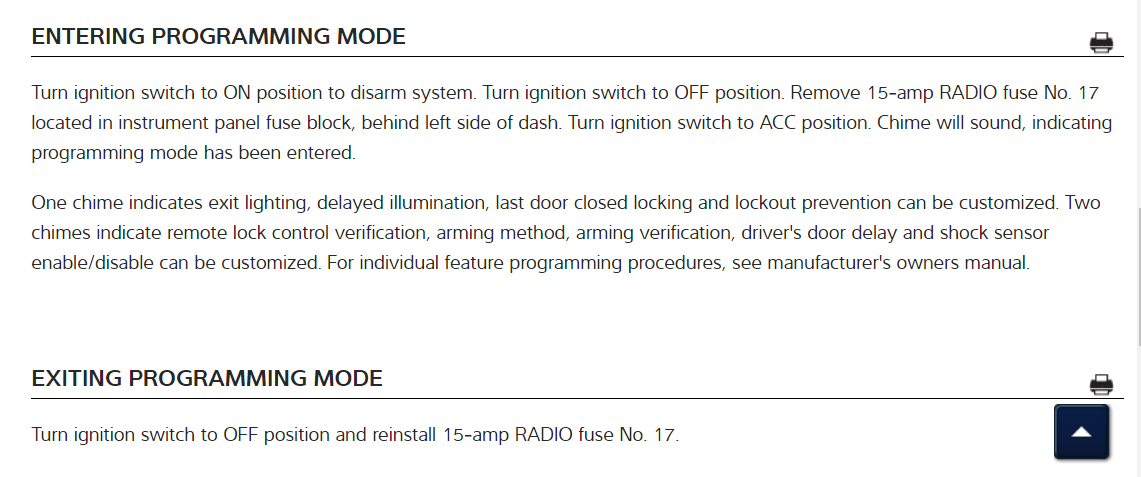

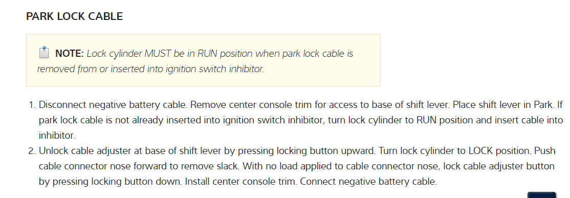

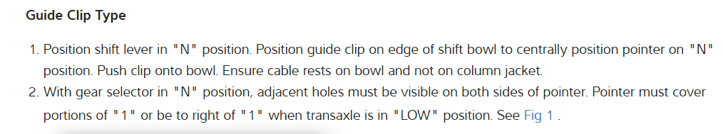

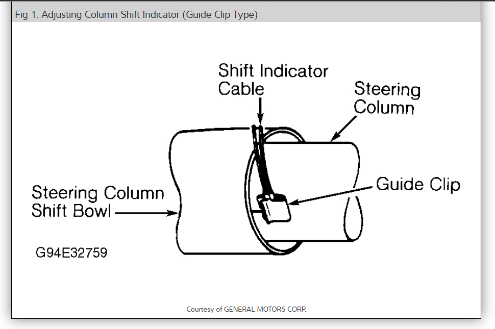

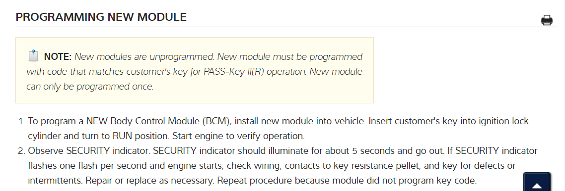

In the diagrams down below I have included the factory instructions for the removal, installation, and adjustments, and programming information for your vehicle's ignition switch. Please go through this guide and get back to us with how everything turns out.
Thanks,
Alex
