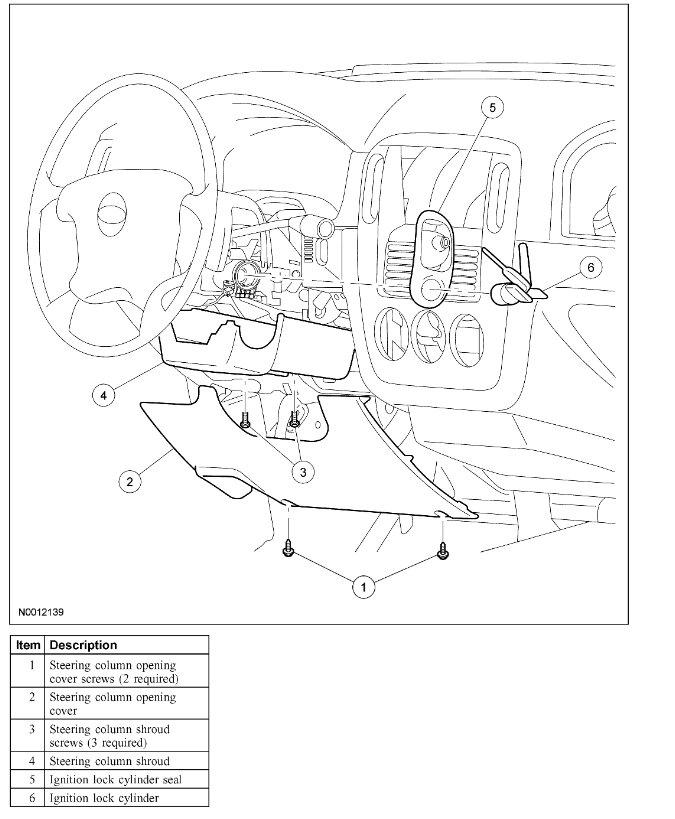

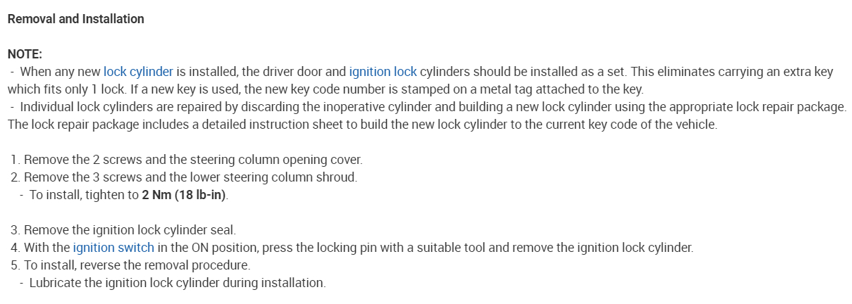

Why after I replaced the ignition switch, I put key in to try to start and it won't turn at all? If it is locked but the steering wheel is not locked. Please help me.
Aug 26, 2023 at 6:45 AM
  • 55,412 POSTS
When you replaced the lock did you use the keys that came with it? You may have a defective ignition lock, here is how to change it out correctly in the images below. Check out the images (below). Let us know what happens and please upload pictures or videos of the problem so we can see what's going on.
