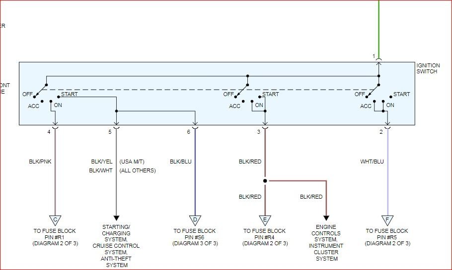

I don't know what color wire is battery or starter or ignition or accessories to connect universal ignition.
Jun 12, 2019 at 12:38 PM
Hi Tammie,
Here is the wiring diagram for the ignition switch. Please let me know if you need anything else. Check out the diagrams (Below). Please let us know if you need anything else to get the problem fixed. Thanks
