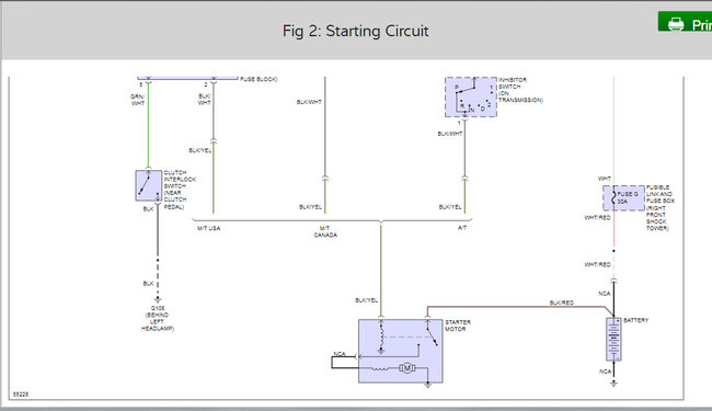

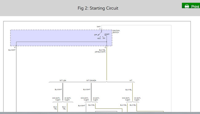

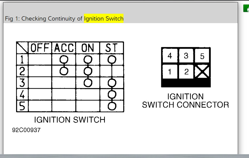

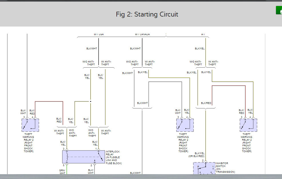

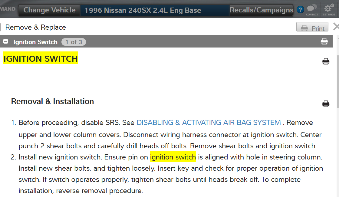

When turn key over no sound except fuel pump all dash lights come on. At first could turn key several times and would crank months later and wont crank or start even with turning key several times. Although it will push/roll start. Turn off and still wont crank or start.
May 24, 2019 at 8:24 AM
SCGRANTURISMO
  • 4,897 POSTS

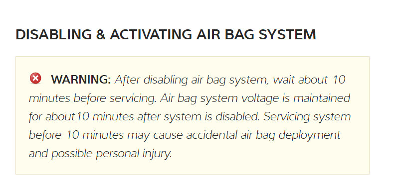

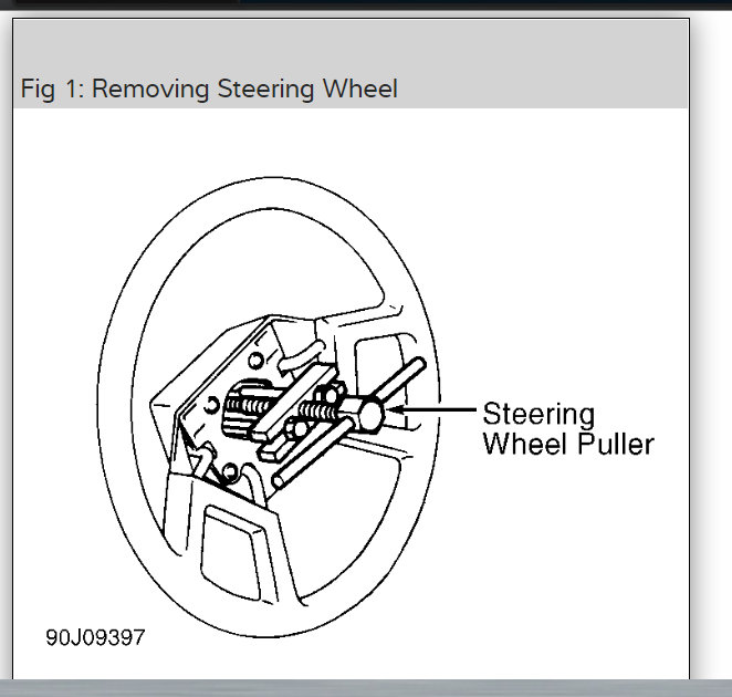

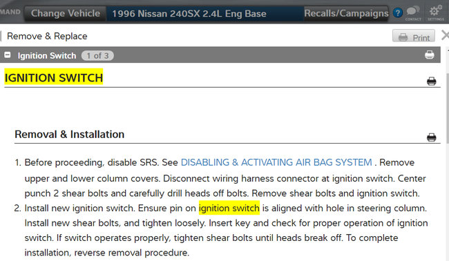

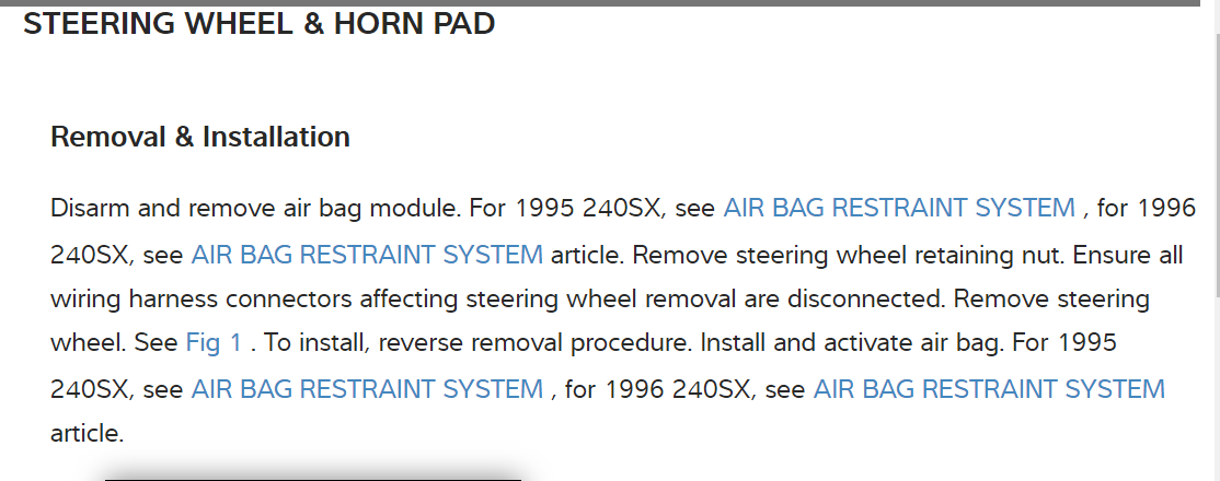

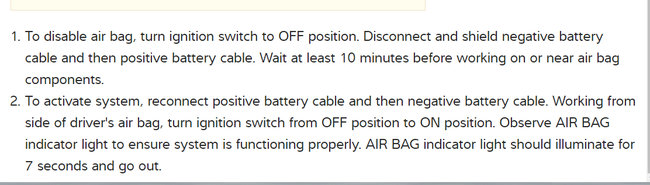

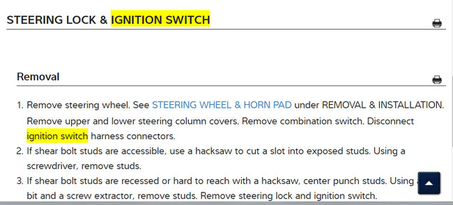

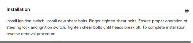

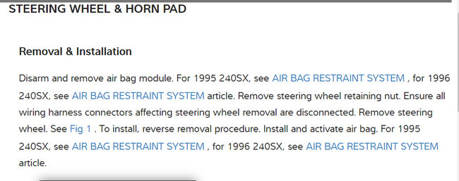

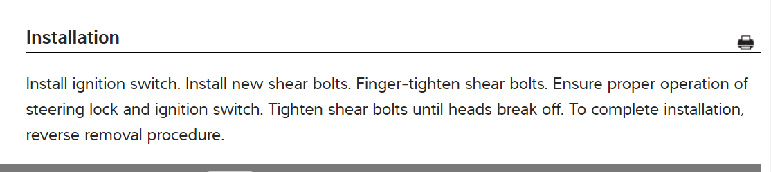

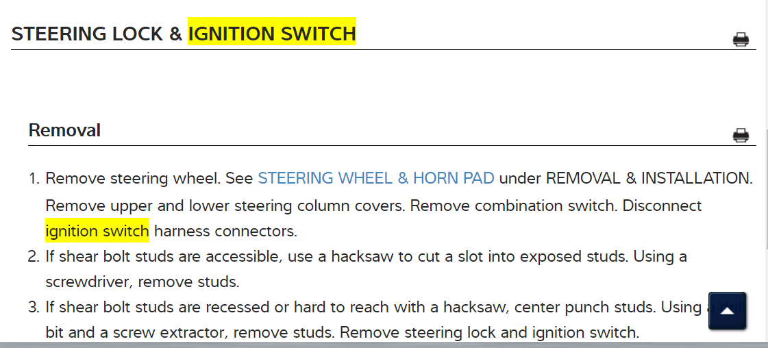

This sounds like you could have a problem with your vehicle's ignition switch. In the diagrams down below I have included instructions for troubleshooting your vehicle's ignition switch. You will need to do a continuity check and you will need a multimeter to do this. I have included a link below if you are not familiar with how to use one.
Please go through this guides and get back to us with what you find out.
