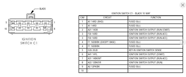

Need to know the ignition switch plug wire order from left to right to plug into my new ignition switch.

I have attached the pinout for the ignition switch below, it shows the order as well as the wire color.

You gave me a picture of the wiring, I can't tell if it's the back of the switch or the plug for it.

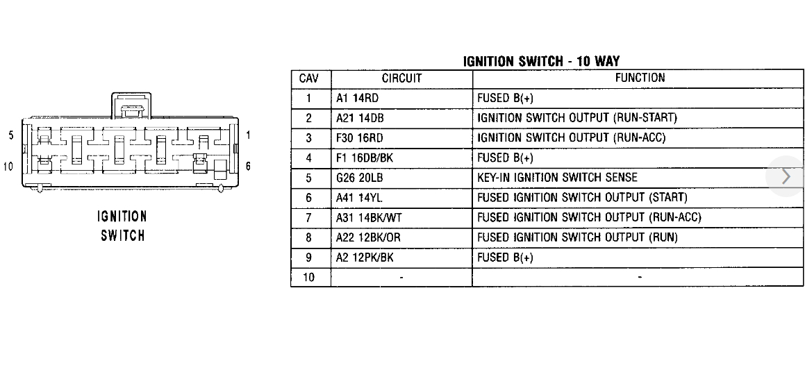

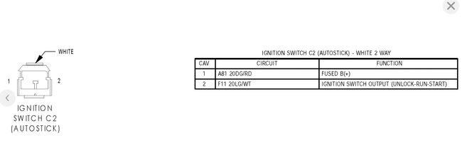

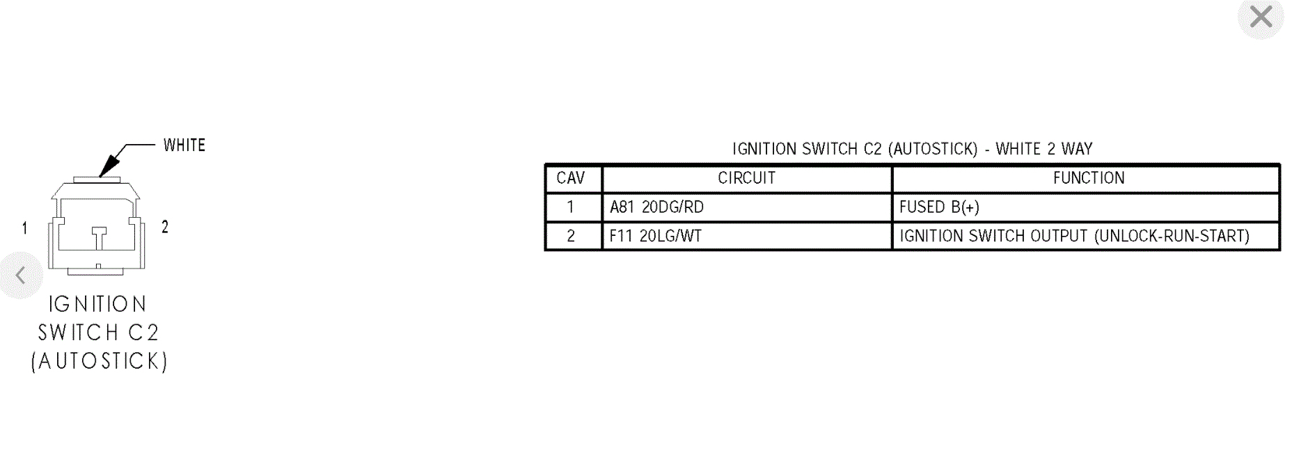

I'm not sure what was sent. However, I attached pics below showing the connectors. Let me know if this helps or if you have other questions.
See pic below.
