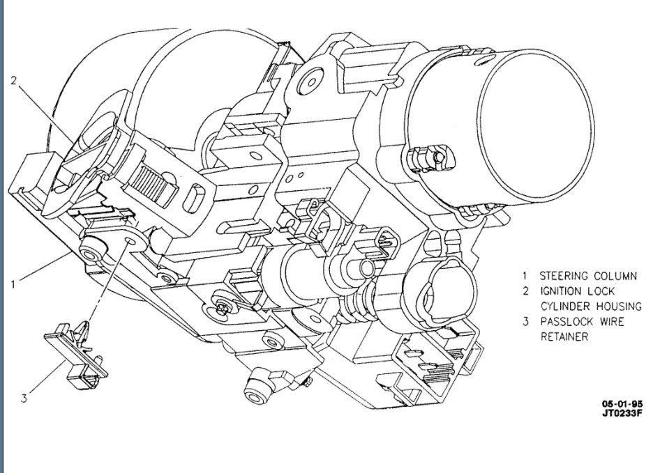

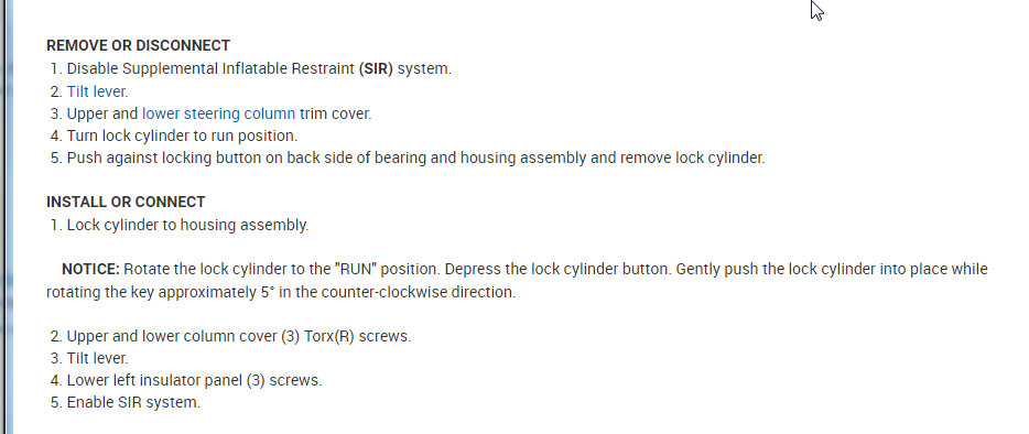

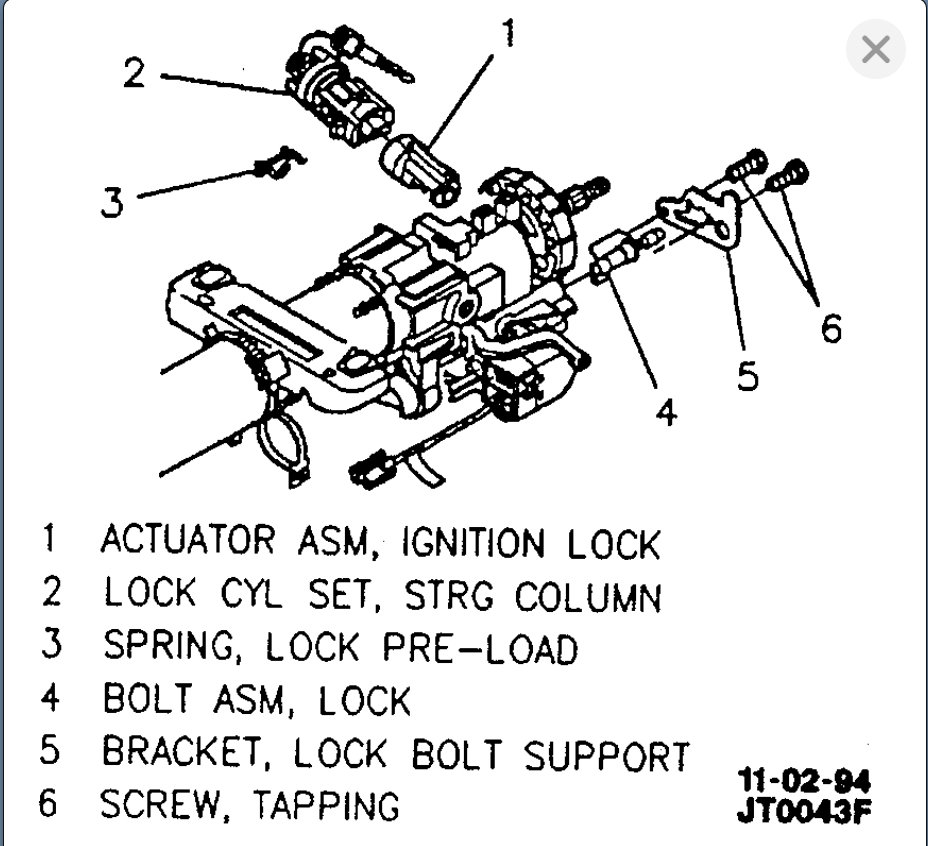

To reinstall actuator rod do you turn clockwise/counterclockwise to set actuator in securely?
Dec 23, 2020 at 11:19 AM

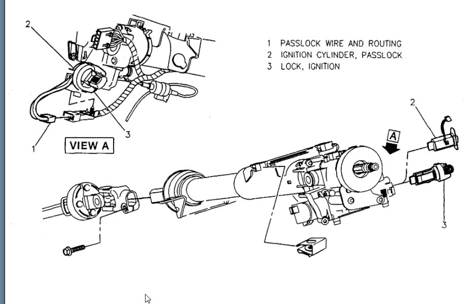

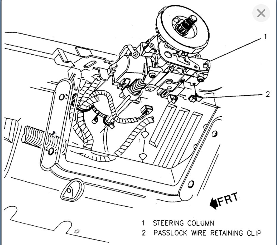

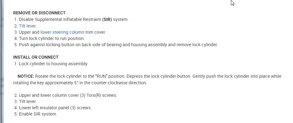

Looks like you install it counter clockwise. I am attaching the process from the manual below that gives the detail that you will need. Let us know if you have other questions. Thanks
