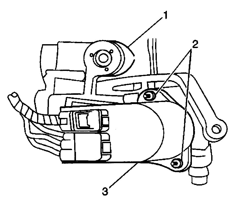

Are you referring to the ignition switch itself? If so, here are the directions for removal and replacement of the switch. The attached pics correlate with the directions.
___________________________________
1999 Chevrolet Cavalier L4-144 2.4L DOHC VIN T SFI
Ignition Switch
Vehicle Steering and Suspension Steering Steering Column Service and Repair Removal and Replacement Ignition Switch
IGNITION SWITCH
REMOVAL PROCEDURE
CAUTION: Refer to Battery Disconnect Caution in Service Precautions.
pic 1
1. Disconnect the negative battery cable.
2. Remove the steering column trim covers.
3. Remove the ignition lock cylinder.
4. Remove the 2 screws (2) from the ignition switch (3).
5. Remove the ignition switch (3) from the steering column (1).
INSTALLATION PROCEDURE
pic 2
1. Install the ignition switch (3) to the steering column (1).
Notice: Refer to Fastener Notice in Service Precautions.
2. Install the screws (2) to the ignition switch (3).
Tighten the screws to 4 Nm (36 inch lbs.).
3. Install the ignition lock cylinder.
4. Install the steering column trim covers.
5. Connect the negative battery cable.

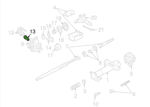

I need to remove and replace the actuator behind the ignition switch.
Mar 22, 2021 at 10:57 AM
  • 110,246 POSTS
Is it the steel linkage between the switch and the lock cylinder? If that's the case, I don't believe it's even replaceable. If you have the part, take a pic and upload it for me to see.
CHRIS ASHLEY2
  • 17 POSTS
The part number is GM Lock Actuator 26032220. It has been discontinued by GM, but I have found it on other websites for sale. It is part 13 in the attached photo.

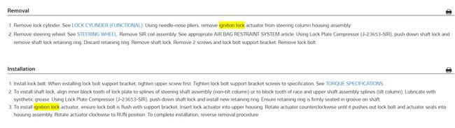

  • 110,246 POSTS
Chris,
That's the ignition lock actuator. That should be removable once the lock cylinder is out of the column. If you look at the attached pic, it explains how it is removed.
Let me know if that helps.

This is the part that keeps the ignition switch in the run position, correct? I was told replacing the actuator would take care of the ignition switch turning off. I do not want to start replacing parts just to hope something works.
  • 110,246 POSTS
Hi Chris. Honestly, that is a linkage between the two parts. I believe the switch itself holds it. In all honesty, in 40 years, I've never replaced just an actuator, but I can't see how it keeps it in the run position.
Let me know what you find.
