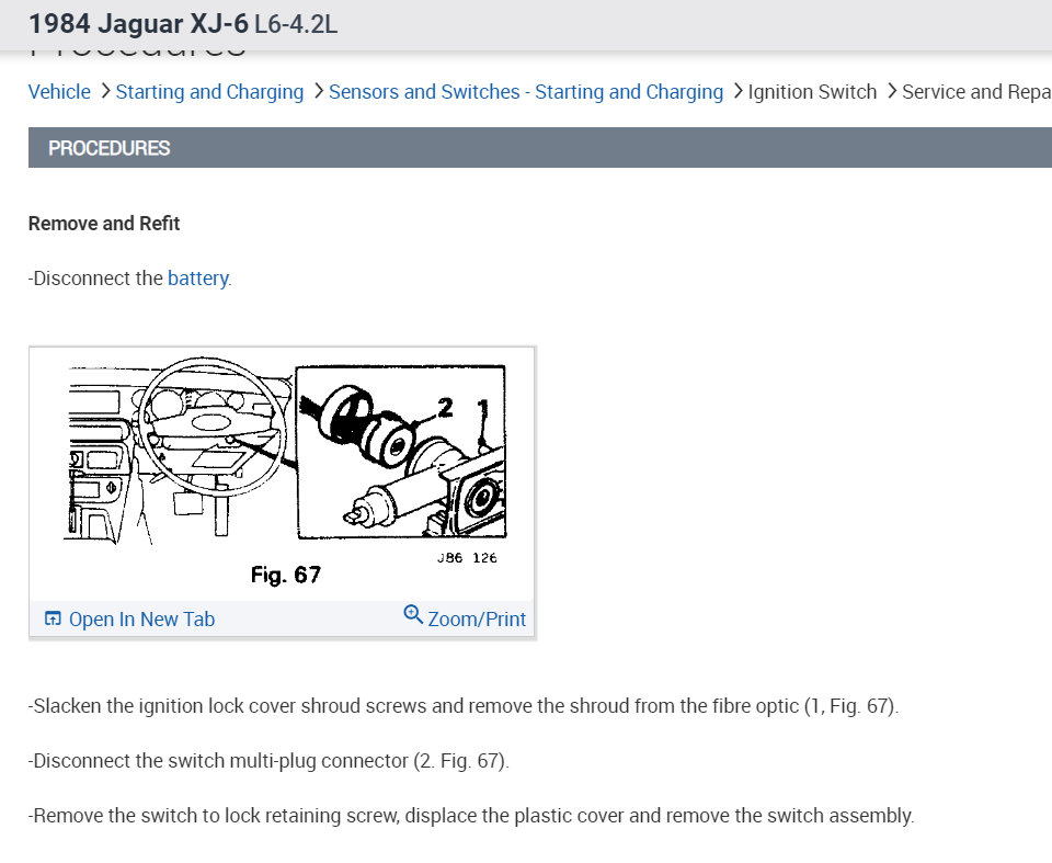

Tried no liquid 3 in 1 lube. No luck. Can’t find a replacement one. Thanks.
Jul 2, 2022 at 1:29 PM
  • 55,711 POSTS
Yes, finding a replacement might be difficult, try eBay. Here are the instructions on how to change the ignition switch out once you do find one. You might want to call a locksmith to see if they can help. Check out the diagrams (below). Let us know what happens and please upload pictures or videos of the problem.
Jul 3, 2022 at 2:18 AM
DICK CARUTHERS
Will a universal push button switch work? From eBay? Blue in color and round. Thanks.
Jul 3, 2022 at 3:06 AM
  • 55,711 POSTS
It might if you do some modifications, please upload pics so I can help you when you get the part.
