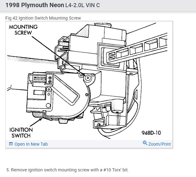

Last night it took me three tries to start the engine before it finally started, and this morning I was able to start the engine twice with just one try, but on the third time, it no longer worked. It looks like there's totally no contact in the switch.
Please advise.
Thanks.
Rey
Jun 8, 2022 at 11:18 PM
SQM
  • 6,383 POSTS

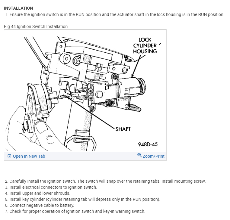

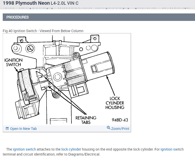

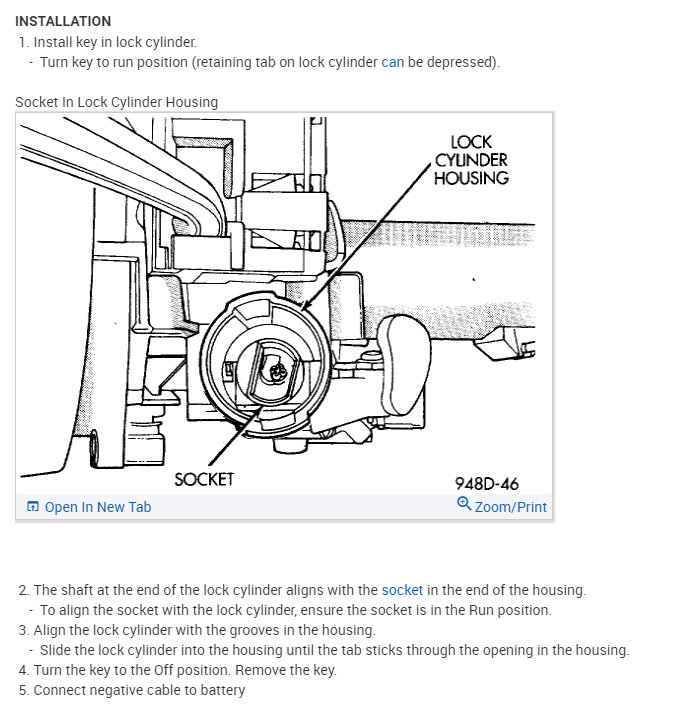

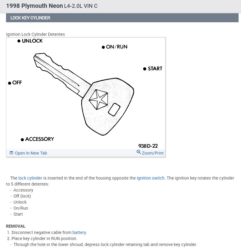

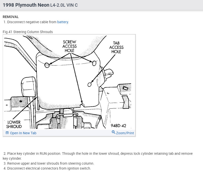

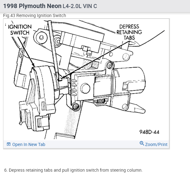

When the ignition switch goes bad, as you try to start the engine it will not allow any power to the starter, and it will not make any noise.
I have attached the lock cylinder and the ignition switch replacement procedure below for your reference.

I was finally able to replace the ignition switch yesterday, and it worked fine each time i switched the engine on. I tried it again this morning and it was okay.
This afternoon I tested it again four times but the fifth time, it didn't work. I tried several times but was unsuccessful, just like how it was before with the old switch. Every time i try to run the engine, there's nothing, no sound, and the radio light dims. The battery charge is okay, (12.7v), I just replaced the alternator last week.
Please advise.
