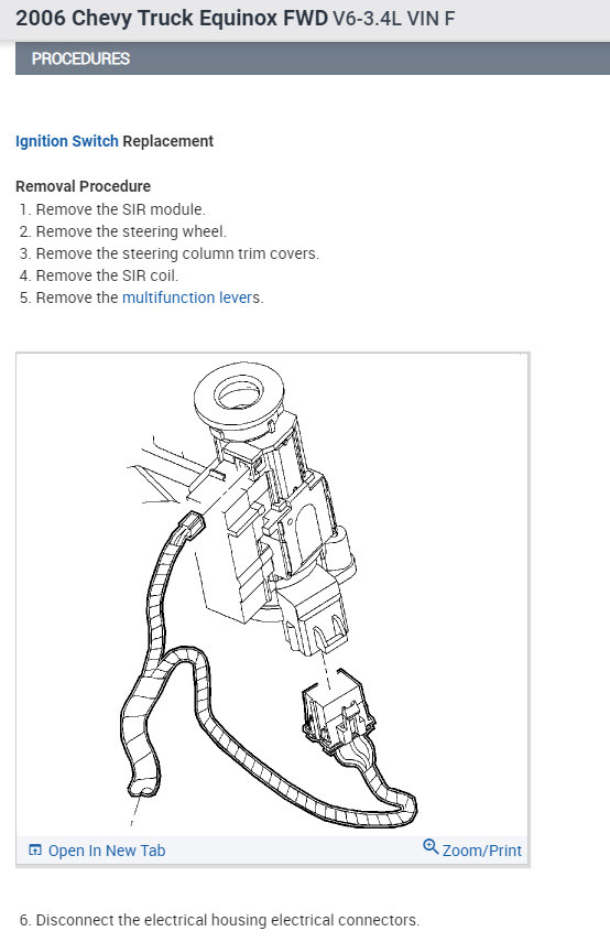

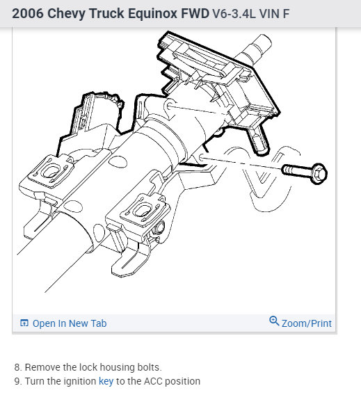

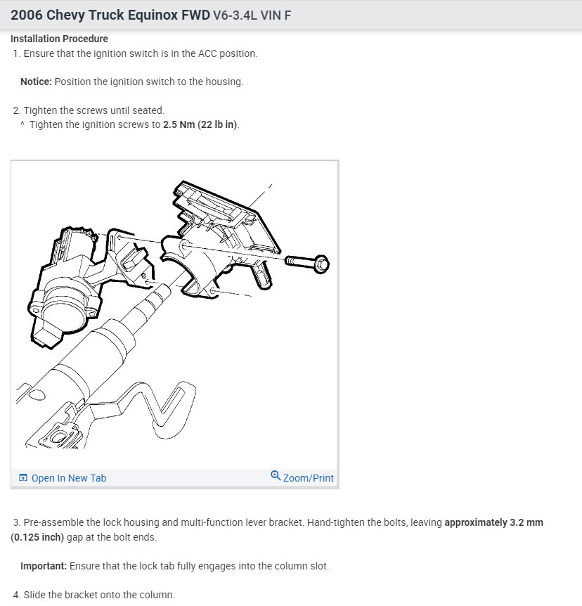

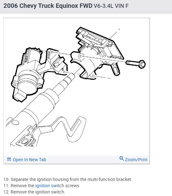

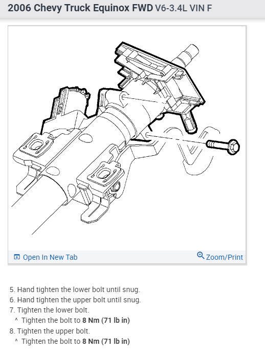

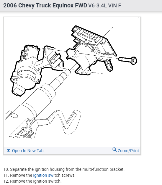

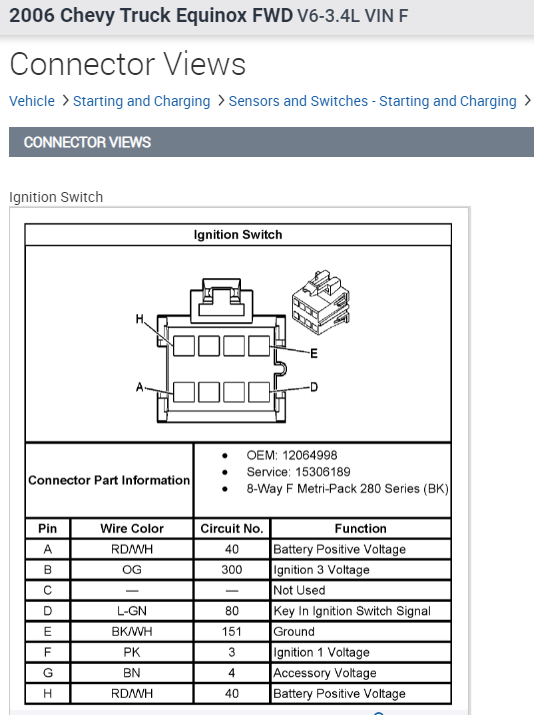

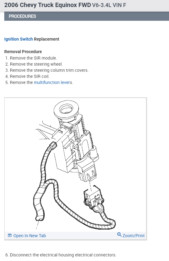

I need to know how to install my ignition switch.
Feb 16, 2022 at 6:54 AM
SQM
  • 6,383 POSTS

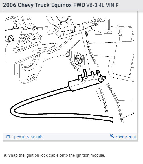

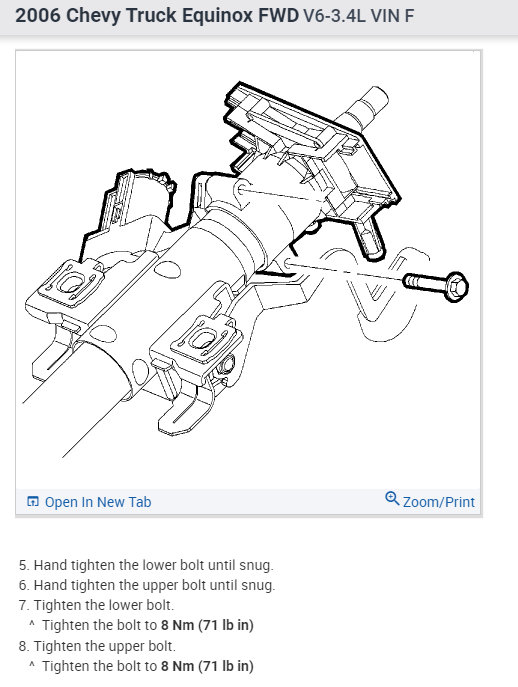

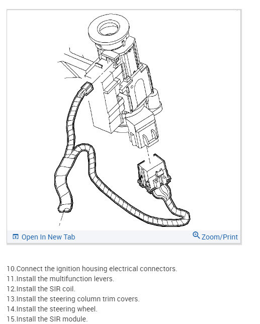

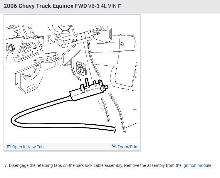

In order to replace the ignition switch, you will first have to remove the steering wheel along with the airbag module.
Be sure to take extra caution any time working with the air bag. Make sure to disconnect the battery before getting started.
Take a look at this guide, it covers the best practices of how to remove the steering wheel:
https://www.2carpros.com/articles/steering-wheel-removal

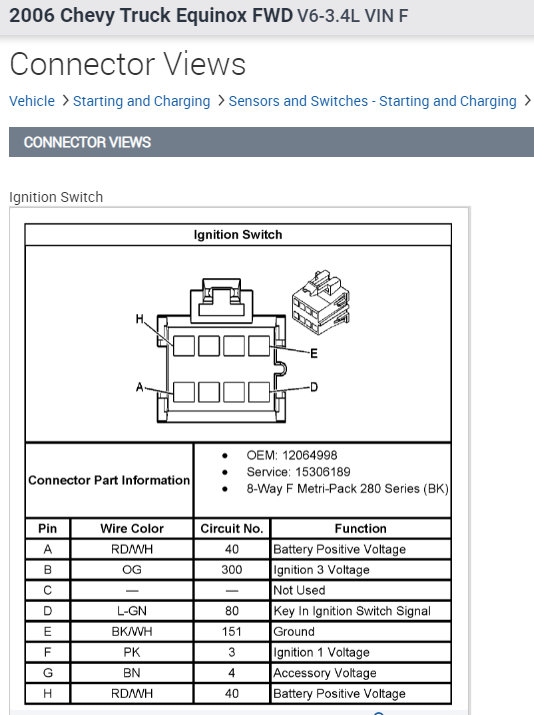

I have attached below the diagrams for your reference.
