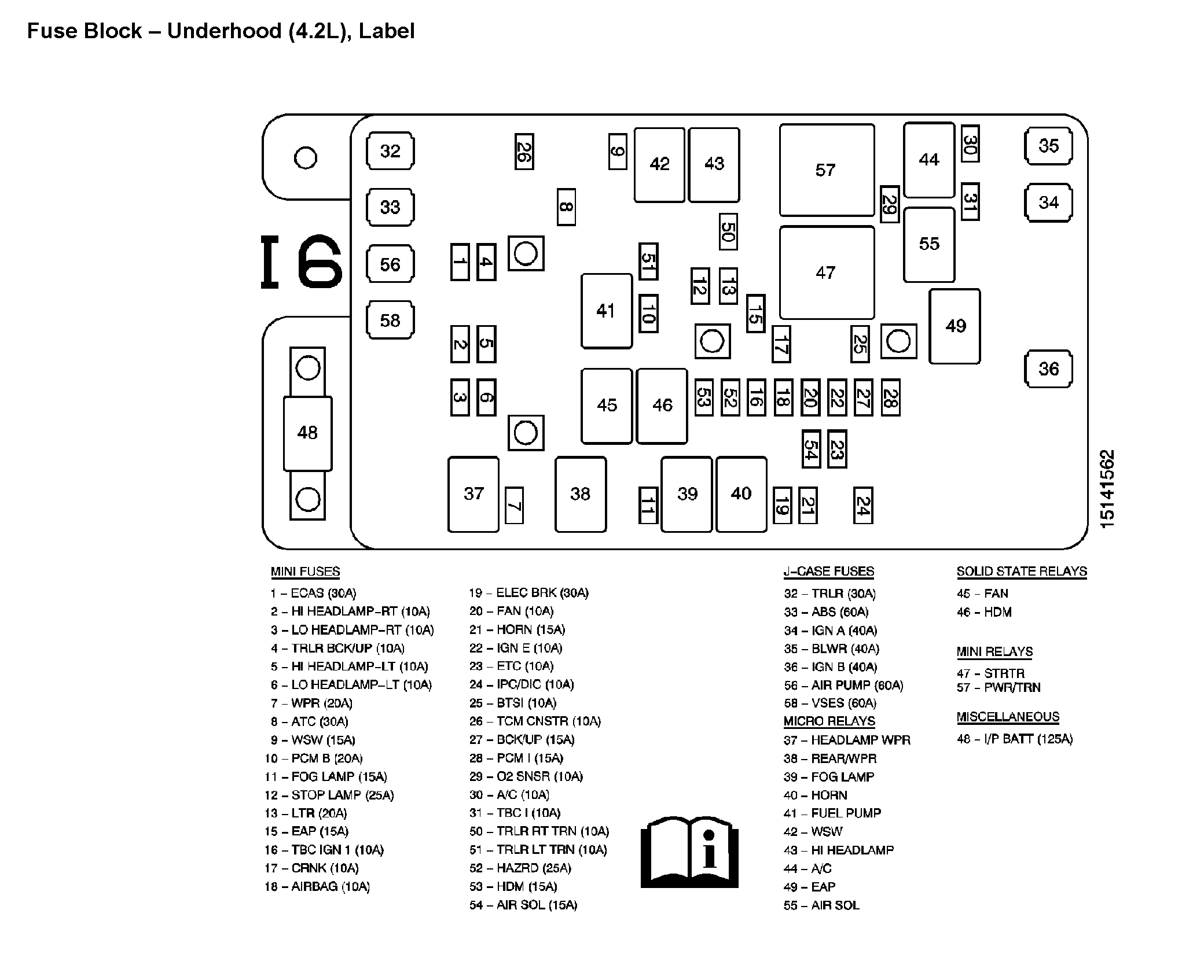

I went to leave work tonight and turned the key in the ignition and everything went black and could not turn the key back to the office position. Electric door locks won't work. Didn't check the headlights to see if they would work but the interior lights don't come on.

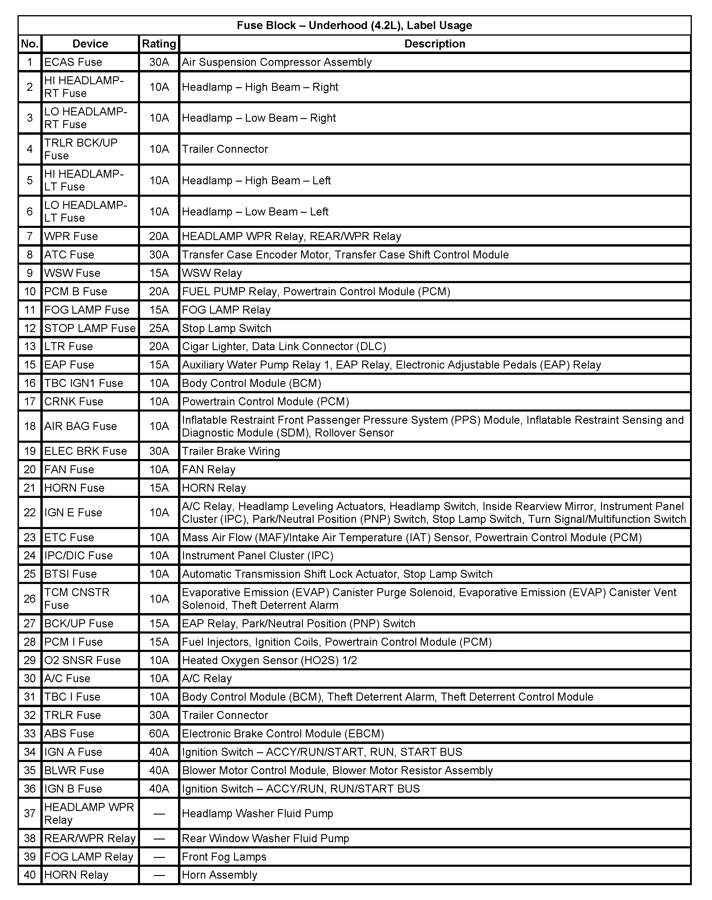

First, I need you to check fuses 22, 34, and 36 in the under hood fuse box. I attaches two pictures. One is the layout of the fuse box and the second is a legend of what each fuse does.
Here are a few links that may help:
Now, if the fuses are all good, next I need you to confirm the battery is good and the terminals are clean and tight. Follow these links.
https://www.2carpros.com/articles/symptoms-of-a-bad-car-battery
Do these things first and let me know the results.

I checked the fuses and they are okay. The battery is covered and I couldn't get the cover off to check it. I did try jump starting and although it still wouldn't start, i was able to turn the ignition switch to off and got the key out. The dome lights and alarm for forgotten keys work as well as the electric door locks. The radio doesn't come on and neither do the headlights. The starter doesn't even try to turn over.
Feb 24, 2019 at 2:05 AM

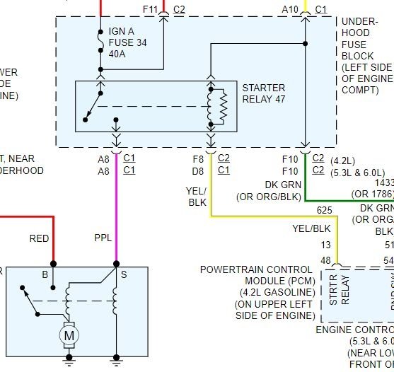

Okay, the part that has me most confused it the fact that the lights don't work. They are separate circuits. As far as the starter, did you check if there is power to the smaller wire on the starter when the key is in the start position? Did you check the starter relay? Look at picture 1. It shows where power goes on the starter. The red wire is direct from the battery. Make sure it has 12 volts all the time. The purple wire gets 12 volts only when the key is in the start position. See if that happens.
Do me a favor, see if putting it in neutral makes a difference.
Feb 24, 2019 at 9:19 AM

I really feel it is one of the main ignition fuses. Something is preventing power. Please recheck the fuses I mentioned earlier, and make sure there is power both to the fuse and out. Also, check the grounds I mentioned near the battery.

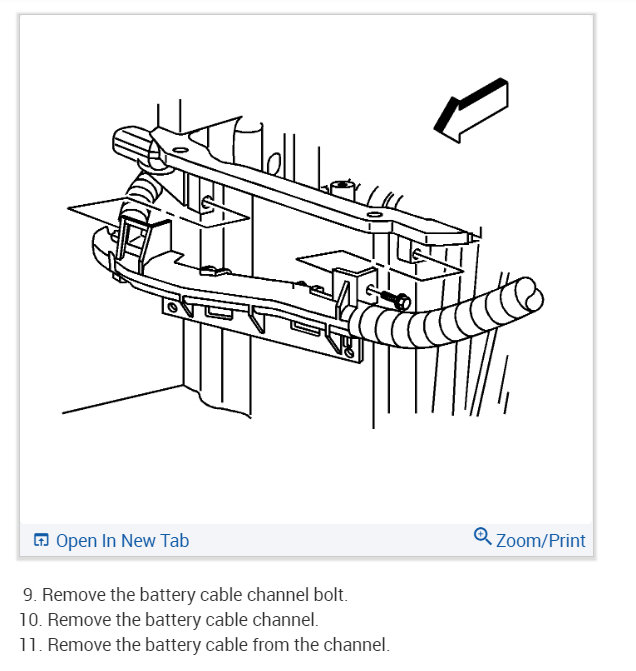

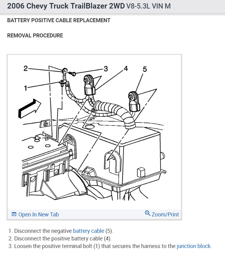

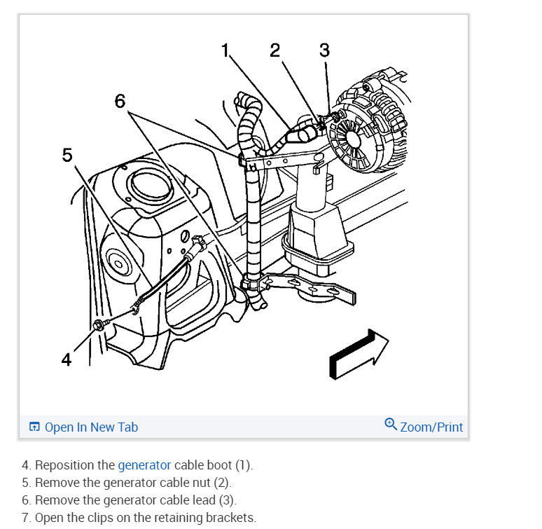

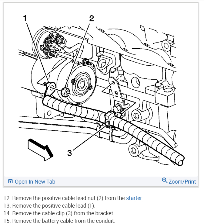

LORETTA WILLEMS
  • 9 POSTS
The grounds look good and we changed the ignition fuses. No difference.
Mar 10, 2019 at 3:23 AM
  • 55,399 POSTS
It sounds like the positive battery cable is bad and needs to be replaced here are diagrams to help. Check out the diagrams (below). Please let us know what happens.
Mar 12, 2019 at 4:39 AM

Problem solved. It was a fuse that had been removed (stolen) while I was working. Strange but was the only explanation for the missing fuse. Thanks for all your suggestions.
