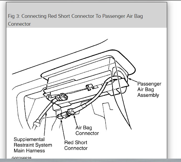

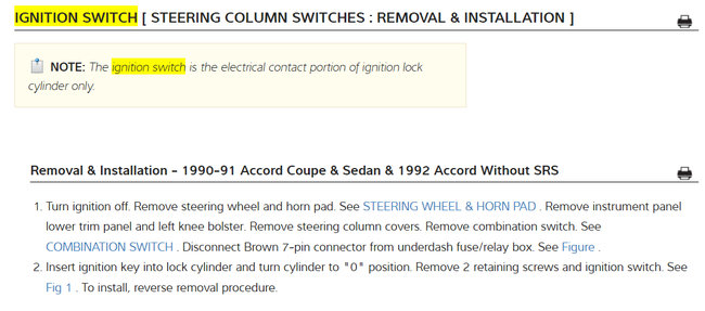

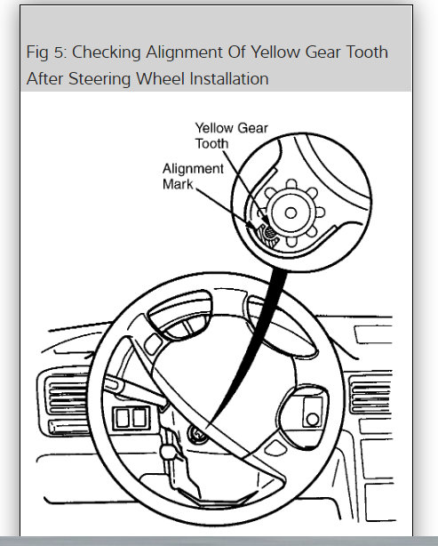

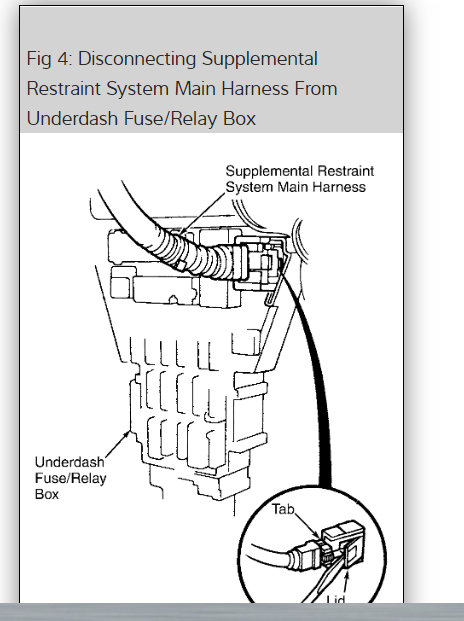

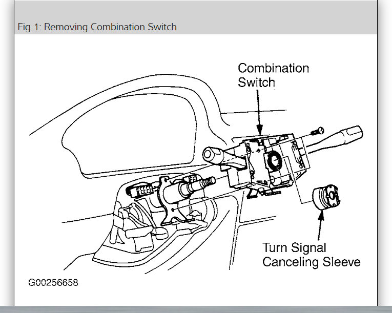

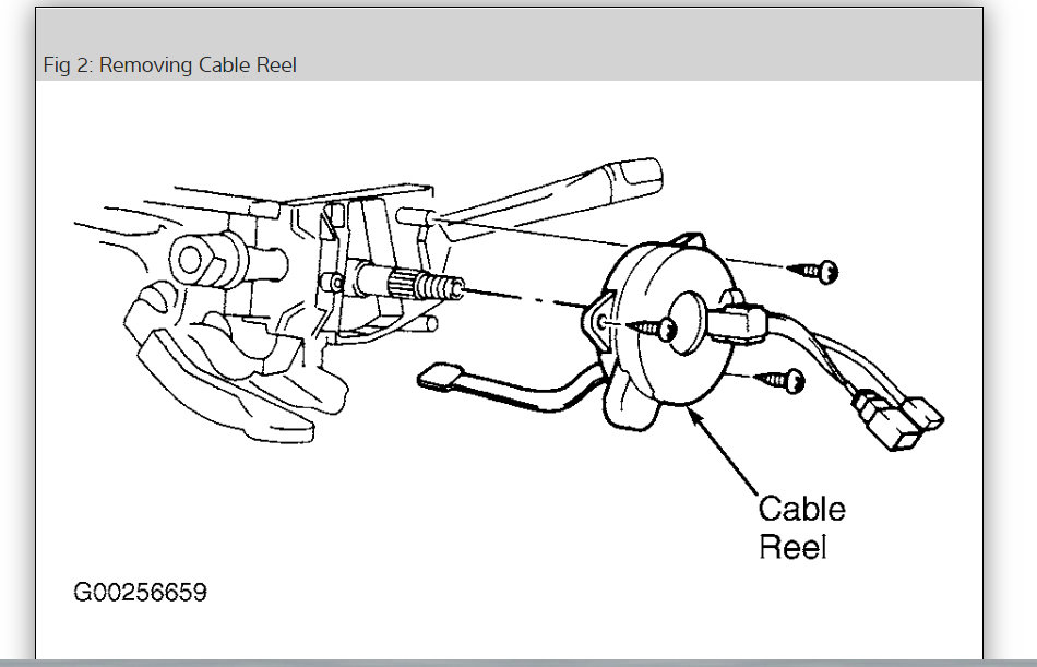

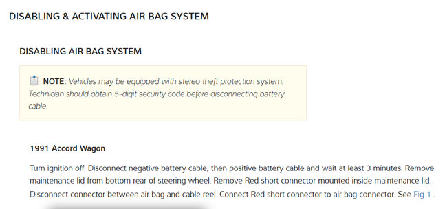

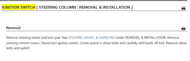

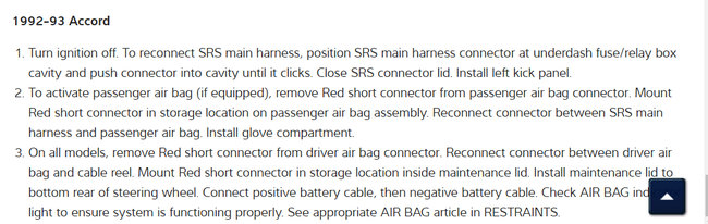

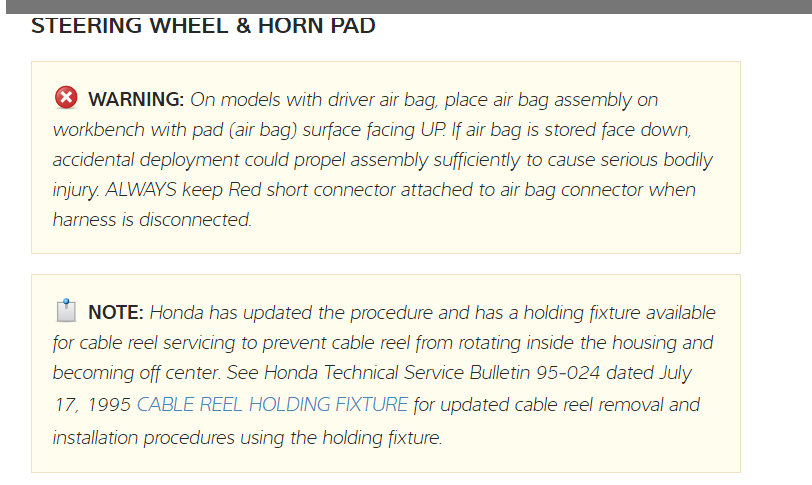

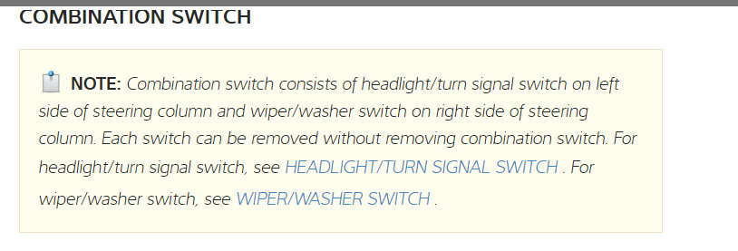

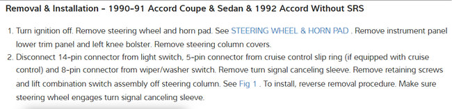

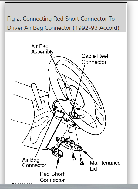

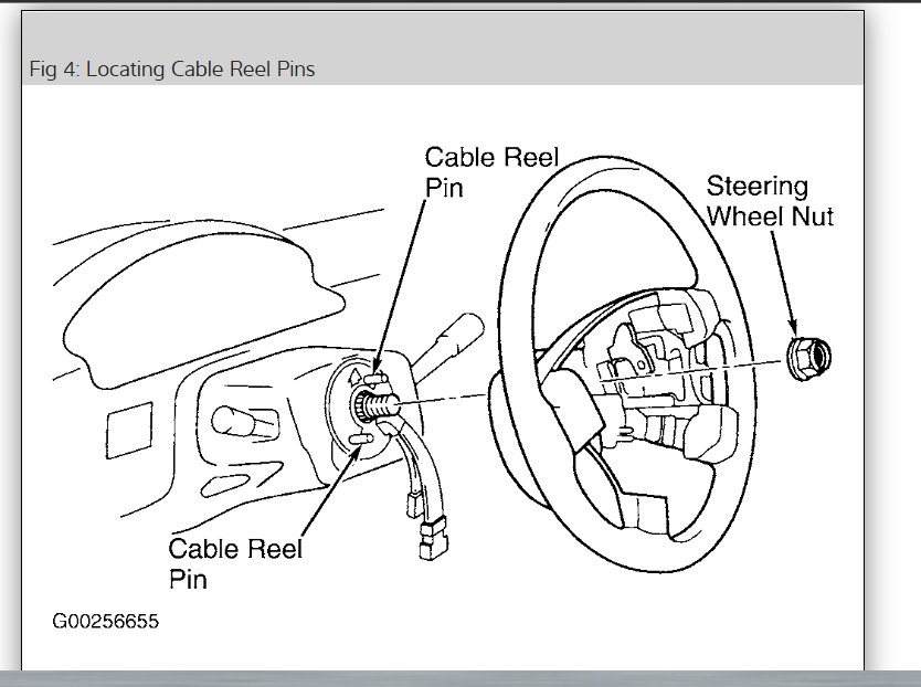

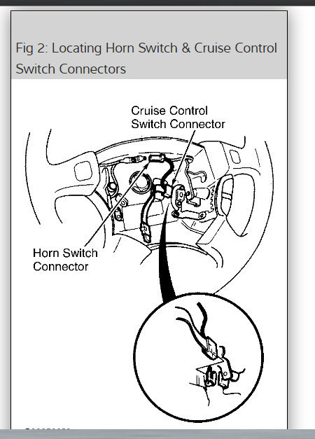

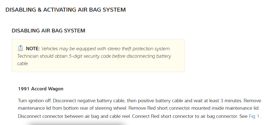

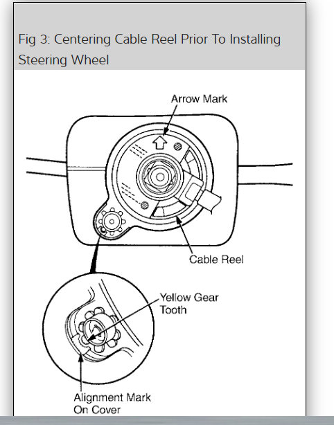

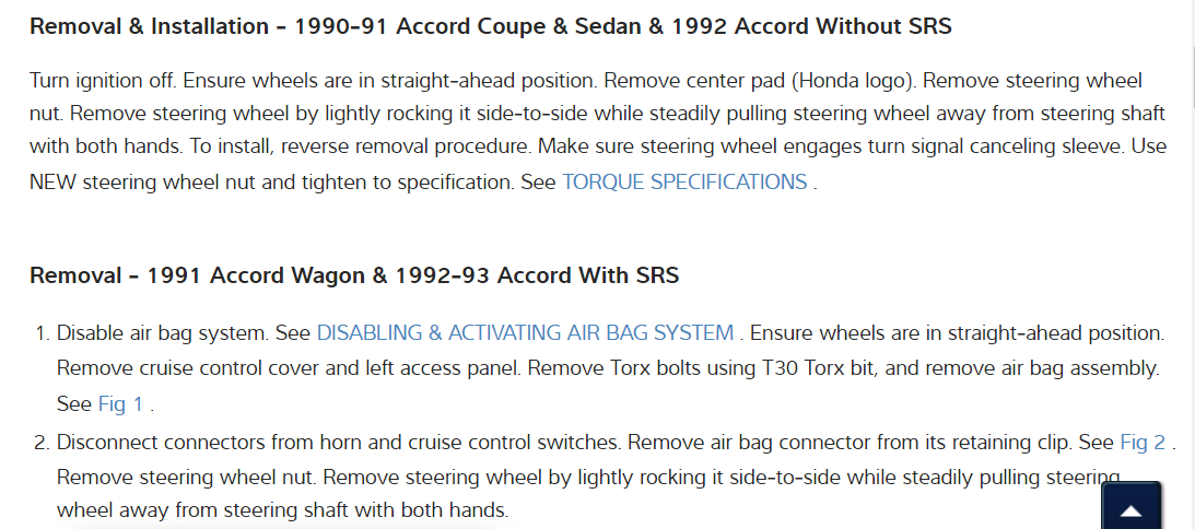

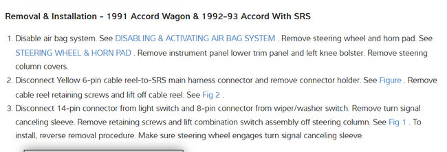

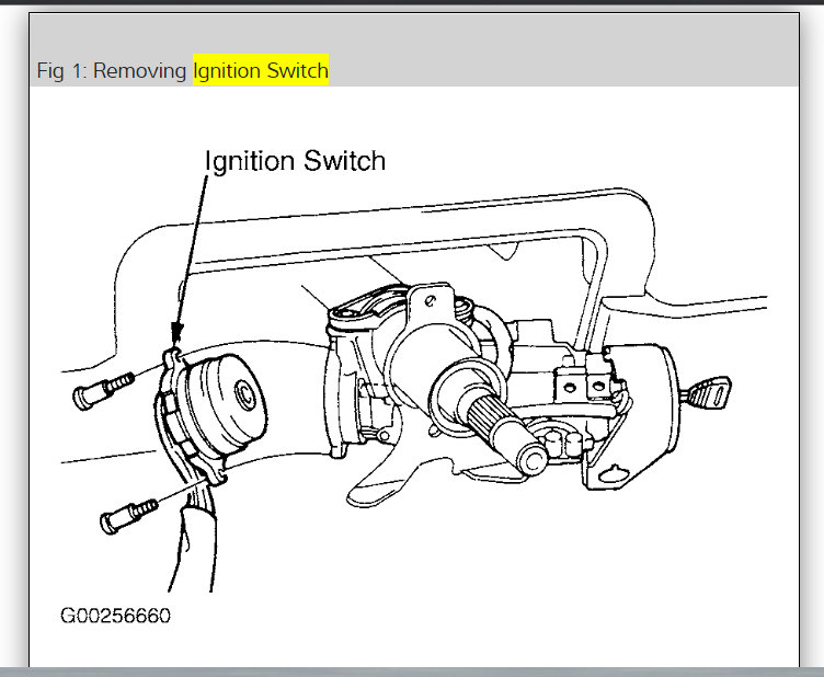

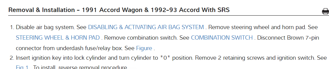

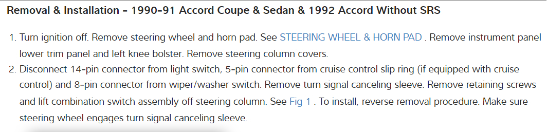

My ignition switch is stuck in position 3. I've tried other solutions and never would turn back. I have a new ignition cylinder and can't get the old one out.
Jul 17, 2019 at 7:39 AM
SCGRANTURISMO
  • 4,897 POSTS

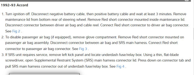

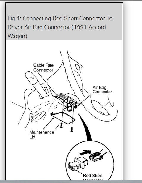

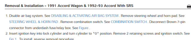

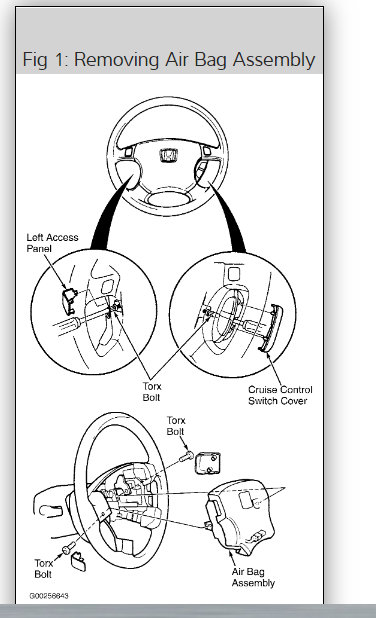

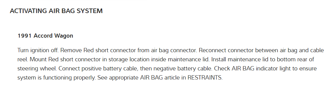

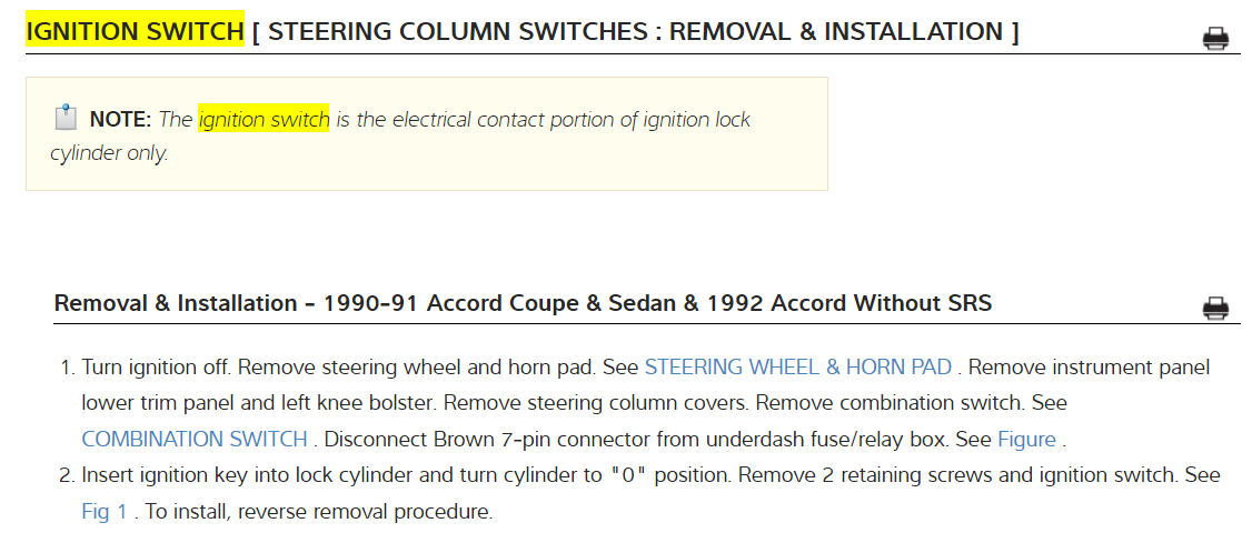

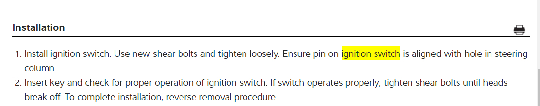

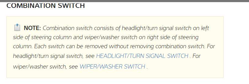

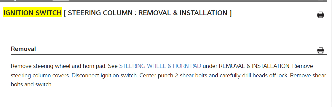

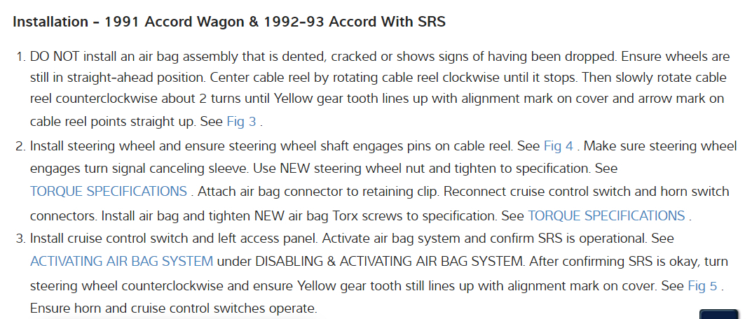

In the diagrams down below I have included the instructions from the vehicle manufacturer for the removal and installation of the ignition switch. Please go through this guide and get back to us with what you are able to find out.
