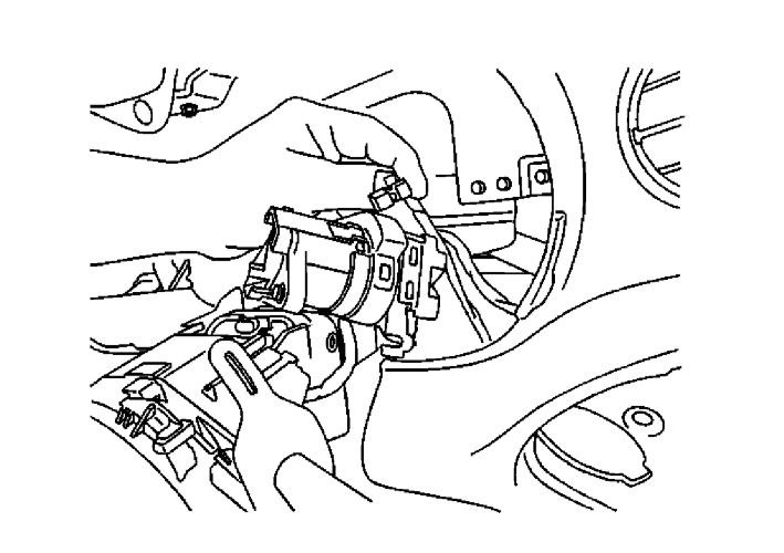

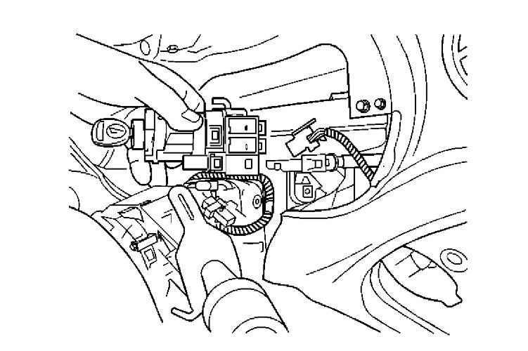

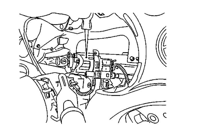

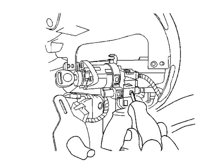

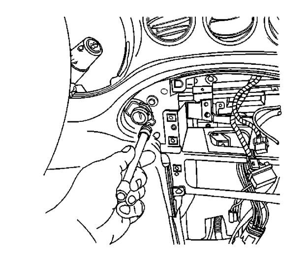

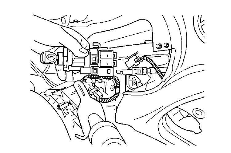

The car periodically will crank but won't start. Had the codes checked, and it said intermittent ignition failure. So I am wondering if I can replace the ignition switch myself, and if I need any special tools to do so? Thank you.
Mar 20, 2019 at 6:58 AM
Good afternoon,
Can you give me the code number? Codes never tell you to replace anything. They tell you an area of failure.
IGNITION SWITCH REPLACEMENT
REMOVAL PROCEDURE
1. Disconnect the negative battery cable.
2. Remove the instrument panel (I/P) accessory trim plate.
3. Remove the I/P cluster.
4. Remove the bolts from the ignition switch.
5. Reposition the ignition switch for ease of removal.
6. Insert the key and turn the ignition lock cylinder to the ON/RUN position.
7. Press the transaxle park/lock cable retainer to release the retainer, then pull to remove the park/lock cable from the ignition switch.
8. Remove the lock cylinder from the ignition switch:
8.1. Depress and hold the ignition lock cylinder detent.
8.2. Turn the key to the ON/RUN position.
8.3. Pull the ignition lock cylinder out with the key.
9. Disconnect the Passlock electrical connector from the ignition switch.
IMPORTANT: Remove the ignition lock cylinder before you remove the Passlock electrical connector.
10. Disconnect the electrical connectors from the ignition switch.
11. Remove the ignition switch through the I/P cluster opening.
