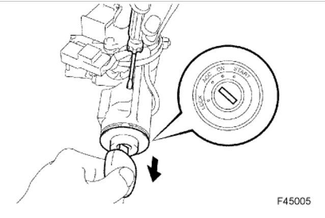

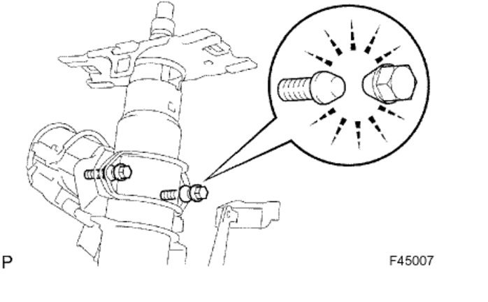

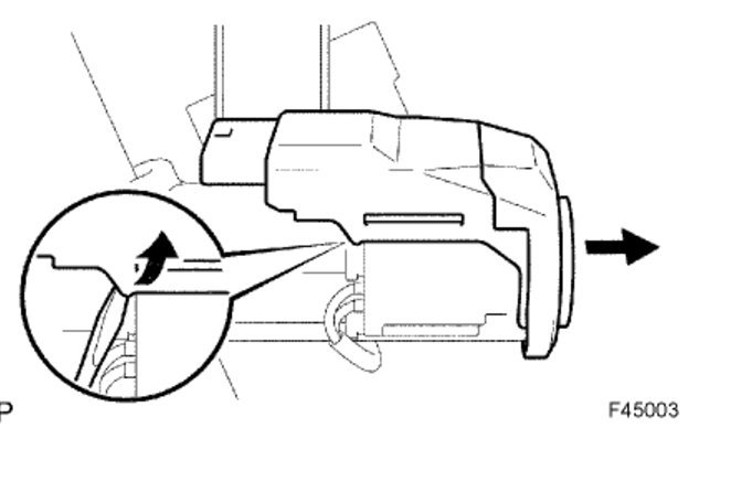

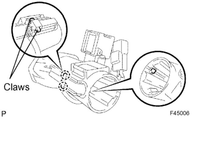

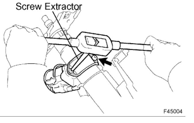

My ignition tumbler or switch is broken. when the car is running I can pull the keys out way too easily without turning car off. it also keeps my accessories on, like my stereo, which in turn drains my battery. What should I do?
Jun 22, 2017 at 10:26 AM
  • 55,711 POSTS
You have the solution, the ignition key tumbler sounds like it is worn out and needs replacement. Here are some diagrams to help you get the job done.

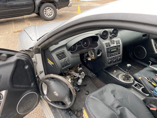

My 2004 Tiburon GT (6 cylinder) was broken into, and the person jimmied the lock cylinder with a screwdriver. Can't insert the key. I dropped the steering column to expose the assembly (image), but I can't get the little nipple to release when depressed by a screwdriver. What's next?
Jul 12, 2023 at 6:17 PM
  • 55,711 POSTS
Spray wd40 inside to help release the tumbler also you will need to try and turn the key back and forth, this should help get the key lock out. Please upload a video of the problem if this doesn't work.
