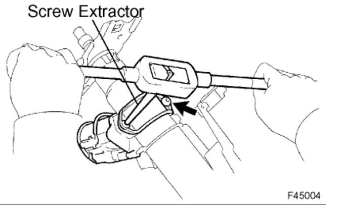

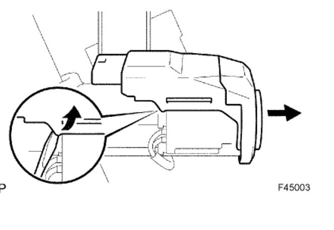

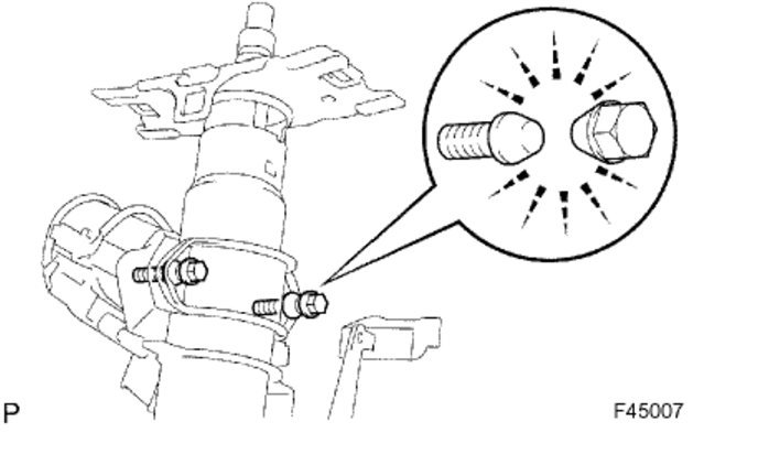

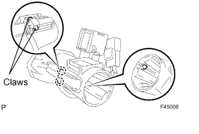

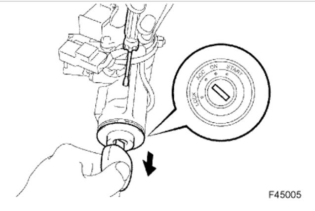

You have the solution, the ignition key tumbler sounds like it is worn out and needs replacement. Here are some diagrams to help you get the job done.

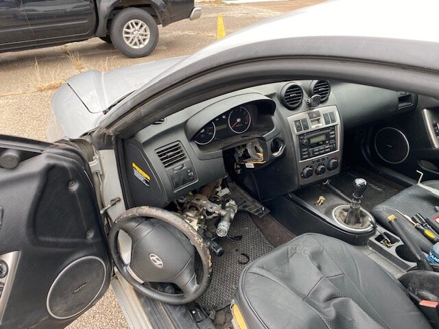

My 2004 Tiburon GT (6 cylinder) was broken into, and the person jimmied the lock cylinder with a screwdriver. Can't insert the key. I dropped the steering column to expose the assembly (image), but I can't get the little nipple to release when depressed by a screwdriver. What's next?
Jul 12, 2023 at 6:17 PM
  • 55,423 POSTS
Spray wd40 inside to help release the tumbler also you will need to try and turn the key back and forth, this should help get the key lock out. Please upload a video of the problem if this doesn't work.
