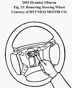

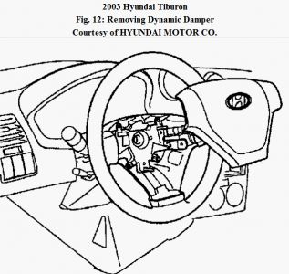

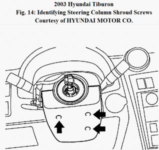

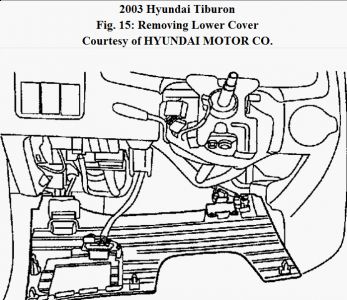

The key broke off in the ignition switch. A locksmith tried to get the broken key out (switch still in the dash) without success, but not too sure how competent this locksmith was.
1. How do I get the switch out of the dash?
2. Once out, can the broken key be removed by a locksmith?
3. If not, then I will purchase a new lock/switch assembly but can a locksmith fix it so I can use the original key? If not, then I guess I will end up with two keys, one for ignition and another for doors?
Any help you can offer will be appreciated.

The plastic part of your key has a transponder chip in it, and you will need to either use an original key, or have Hyundai program a new key for you. REMOVAL & INSTALLATION 1.Disconnect the negative battery terminal. 2.Remove the air bag module. 3.Loosen the tapping screw and lift up horn pad and remove it. 4.Remove the lock nut and the washer. 5.Pulling the dynamic damper forward, lift it up and remove it. Fig. 12: Removing Dynamic Damper Courtesy of HYUNDAI MOTOR CO. 6.Install the special tool (09561-11001) and remove the steering wheel. 8.Remove the lower cover. CAUTION:Do not hammer on the steering wheel to remove it. Fig. 13: Removing Steering Wheel Courtesy of HYUNDAI MOTOR CO. 7.Remove the steering column lower and upper shrouds. Fig. 14: Identifying Steering Column Shroud Screws Courtesy of HYUNDAI MOTOR CO. Fig. 15: Removing Lower Cover Courtesy of HYUNDAI MOTOR CO. 9.Disconnect the connectors and remove the multifunction switch. 10.Remove the mounting bolts and separate ignition switch from steering column. Page 1 of 1 CAUTION:The SRS system is designed to retain enough power to deploy air bag for about 30 seconds even after battery has been disconnected, so serious injury may result from unintended air bag deployment if service is done on the SRS system immediately after battery cable is disconnected.

Follow my earlier instrution, then after you have the trim panel off, leave the wheel on unless the screw head is on top, then the column would need to be removed, if the screw head is accessible from the bottom, it will look like a smooth head, Hyundai says use a punch they have and punch a groove into the head, then use a screwdriver and remove the retaining screw, remove switch and cylinder.

The info I am giving you is to try to make it easy, Remove the under dash panel and LOOK. ou should see the cylinder piece you want to remove? If you see the screw head, and this head is BLANK, no slot or philips star, then use a chisel and make a notch in it that a screwdriver will fit into, remove the screw, then the cylnder, unplug the connector, and take the whole thing with your VIN to Hyundai, they will cut a blank and program the chip and remove the broken piece. Or if it starts, drive to Hyundai or an expierinced locksmith, and let them do the entire job....This is all the advice I can provide, this is what the Hyundai manual says to do...
