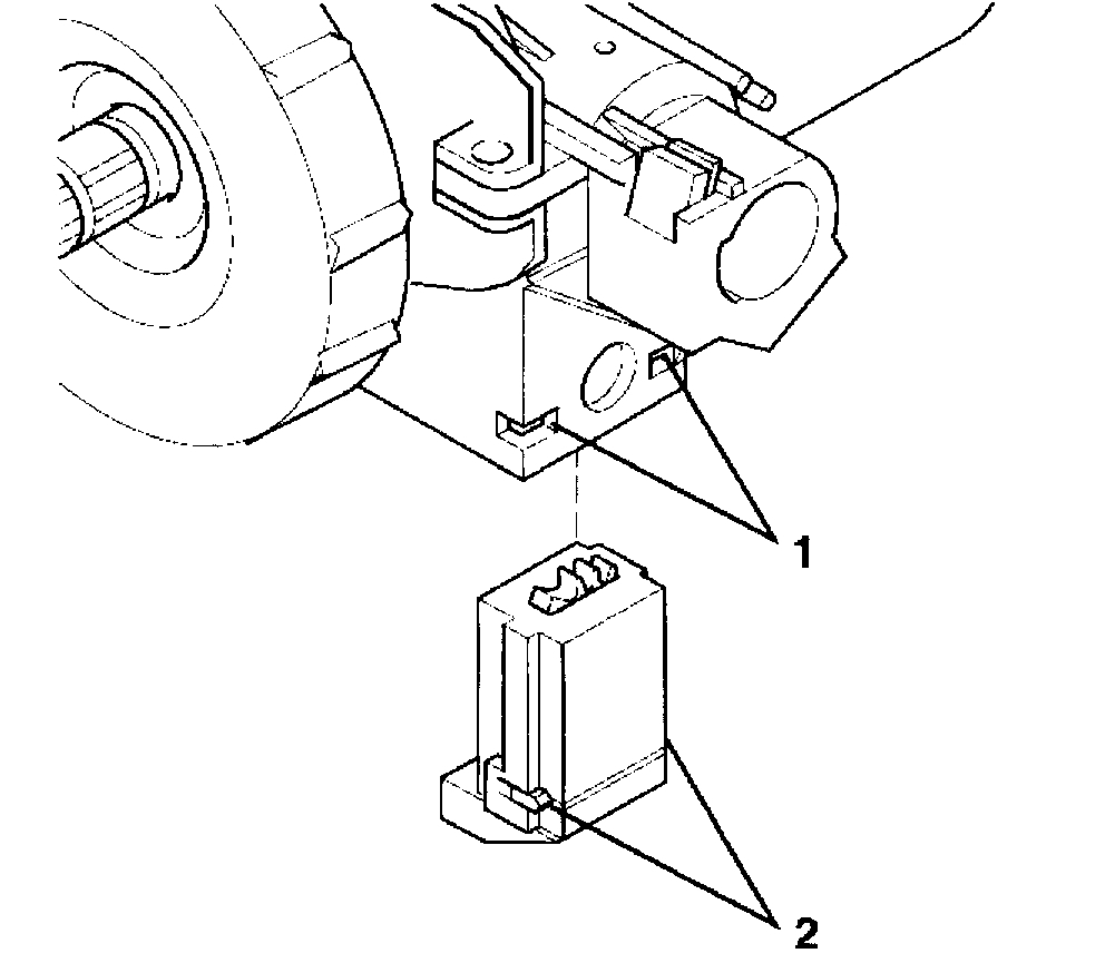

when i turn my key off I can with the key out slightly move the switch so the battery light and odometer come on which can drain the battery.
I replaced the tumbler and the switch below it.
it seems like the spring that makes the key come back has lost its power to hold.
I am guessing as the tumbler fits into a slot on this. what is that part?

Are you referring to the part the key tumbler goes into? If so, it is the lock cylinder housing. There really isn't anything there to go bad.
Take a look through these directions. They explain the directions for replacing the tumbler/switch. I believe you already replaced these parts, but check to see if there are any parts you missed. The attached pics correlate with the directions.

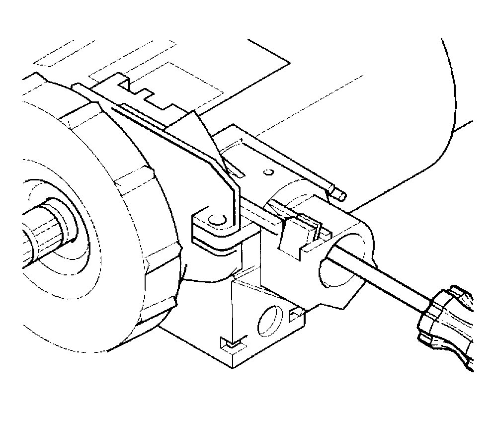

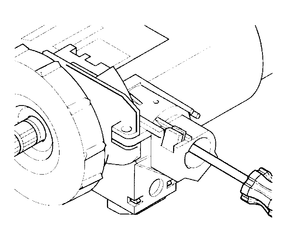

5. With the key installed, turn the key to the RUN position.
6. Install an alien wrench into the hole on top of the lock cylinder housing.
Push down on the alien wrench to release the tab on the lock cylinder inside the lock cylinder housing.

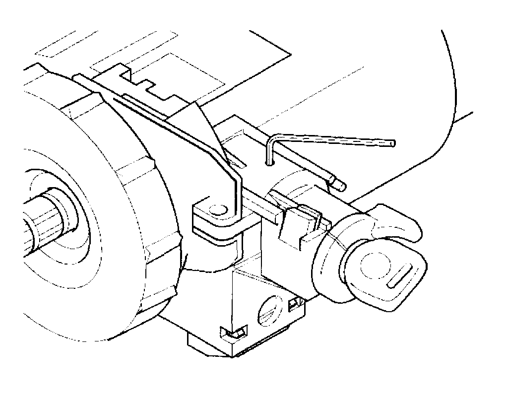

pic 2

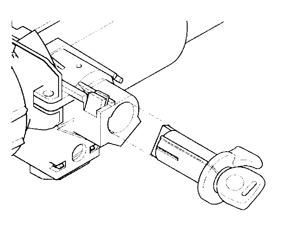

7. Slide the lock cylinder out of the lock cylinder housing.
8. Disconnect the PASSLOCK and key buzzer from the lock cylinder housing.

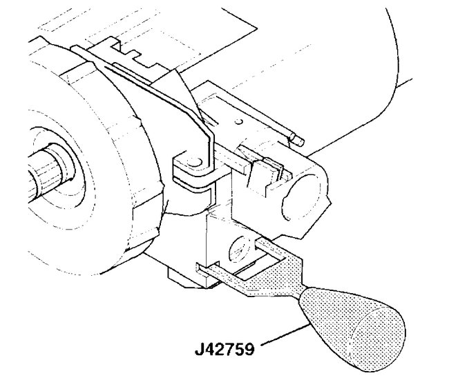

pic 3
9. Insert J 42759 into the lock cylinder housing to release the tabs on the ignition switch.
10. Pull the ignition switch out of the lock cylinder housing.
11. Disconnect the connector from the ignition switch.

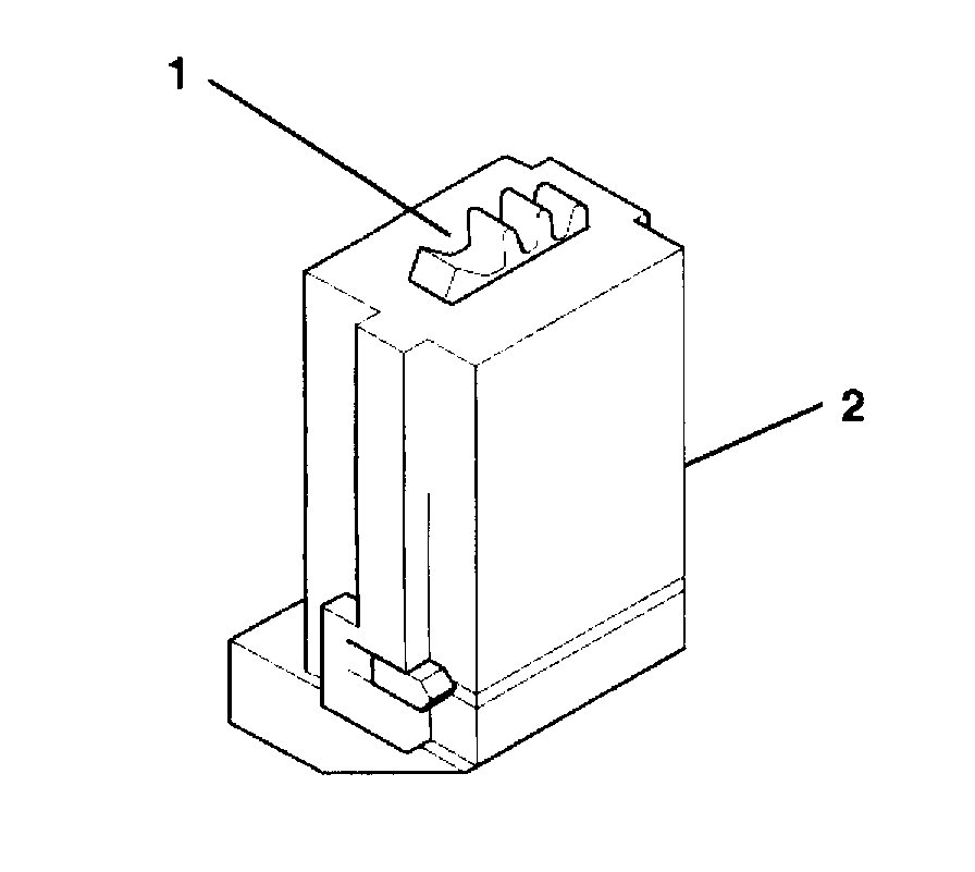

Important: The gears between the ignition switch and the lock cylinder housing must be in the correct position. Failure to do so will cause a misalignment of the gears in the ignition switch and the lock cylinder housing, which may result in a NO START or BATTERY DRAIN.
1. Verify the alignment of the gear (1) in the ignition switch (2). If gear (1) not in position shown, turn gear in ignition switch (2) until you reach the correct position.

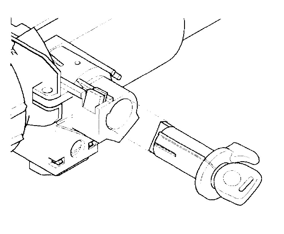

pic 5
2. Use a screwdriver to rotate the lock cylinder housing gear counterclockwise until it hits a stop.

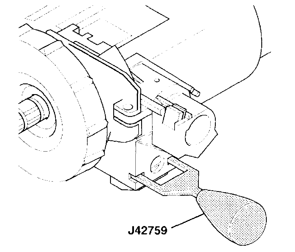

pic 6
4. Insert the ignition switch into the lock cylinder housing. The tabs (2) on the ignition switch MUST be seated inside the lock cylinder housing (1) for proper installation.

The part you show that turns with the screw driver appears to be spring loaded
that is what is was wondering about that may be weak.
I turn the car to off take the key out but if i touch the little wings outside where the key goes it goes slightly forward enough to turn on battery light and odometer mileage display seems to me this should be off and not be able to do this.
any thoughts? could it be that the tumbler is missing that slot ?
Mar 31, 2020 at 6:32 PM
  • 110,194 POSTS
The only thing I can think of is of the gear between the switch and tumbler isn't properly aligned and allowing the switch to energize with very little movement. Was that properly aligned when you installed everything?
