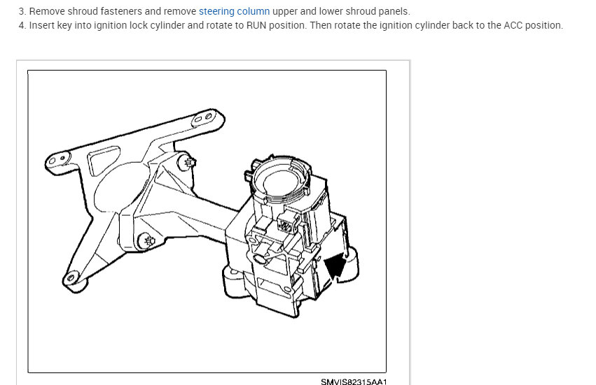

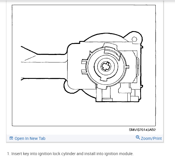

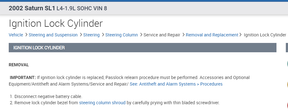

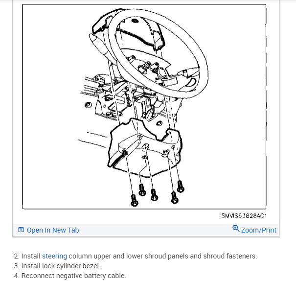

Put in new ignition switch and key goes to acc but doesn’t go any further.
Jul 2, 2023 at 12:06 AM
  • 110,240 POSTS

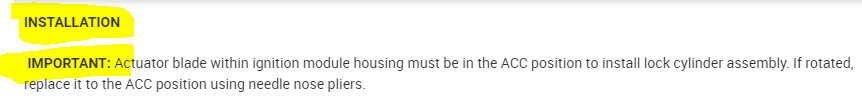

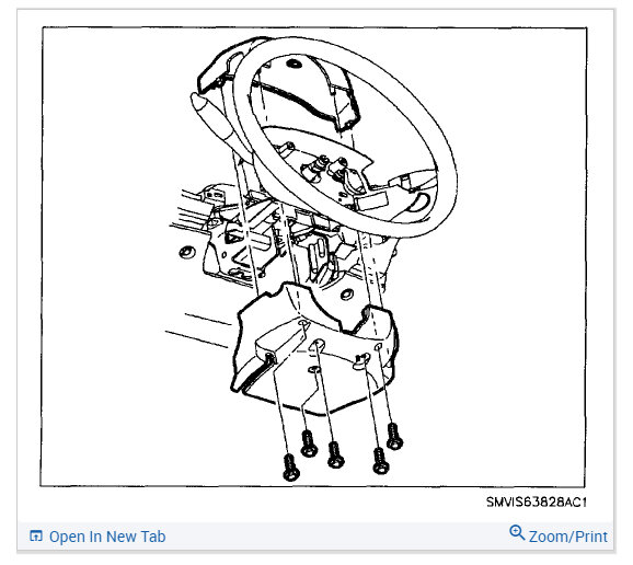

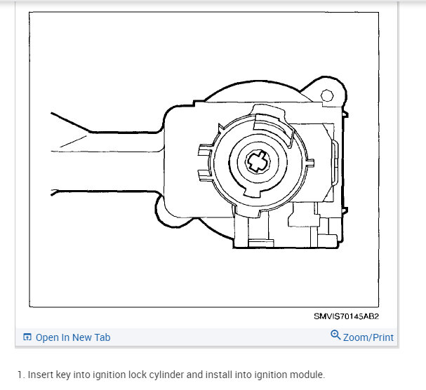

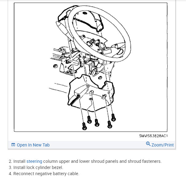

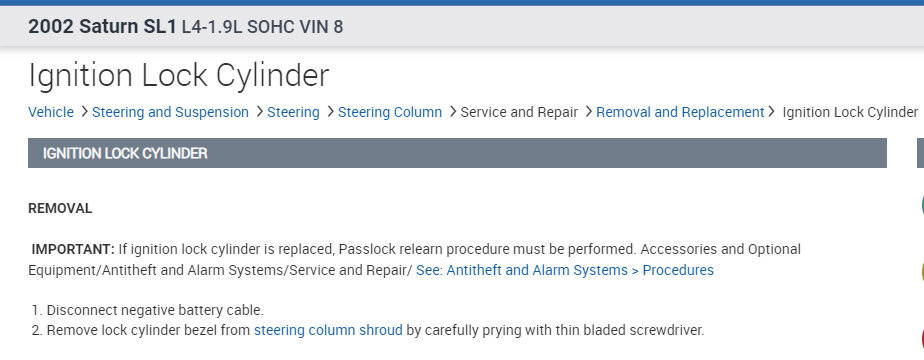

It sounds like the actuator blade wasn't properly aligned. Do me a favor. Take a look at the directions I attached below. See if there is anything you may have missed.
Jul 2, 2023 at 1:52 PM
KAT82
What is the actuator blade and where is it please?
Jul 3, 2023 at 7:13 PM
  • 110,240 POSTS
The actuator blade is where the lock cylinder and the actual ignition switch (electrical portion) joint together. Let me know if you are able to locate it.
