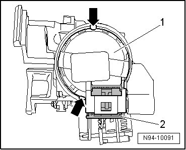

I cannot get the key turn but it will start again.
Nov 27, 2019 at 12:45 PM
  • 110,190 POSTS
If I understand correctly, it turns from off, to run to start, but you can't turn it fully off to remove the key. Is that correct? You say you can restart it, so I assume you are able to turn it off.
Since it has a manual transmission, it isn't related to a park interlock. So, it is most likely related to the switch itself and not the lock assembly.
Here are directions for replacing the switch (not the tumbler/lock assembly). You may need to remove the present one and see if something has come apart or is damaged.

- Disconnect the connector - 2 - from the Ignition/Starter Switch (D) - 1 -.
pic 1
- Release the Ignition/Starter Switch (D) with a small screwdriver - arrows -.
- Remove the Ignition/Starter Switch (D) - 1 - from the steering lock housing.

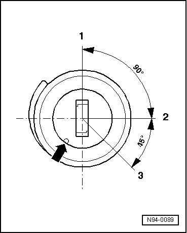

- Insert the ignition key into the lock cylinder and turn the key to the "Run" position.
Lock Cylinder Key Positions
pic 2
1. "Off" Position
2. "Run" Position
3. "Start" Position

Let me know if this helps. Also, let me know if I misunderstood what you are experiencing. One last thought, make sure none of the ignition fuses are blown.
