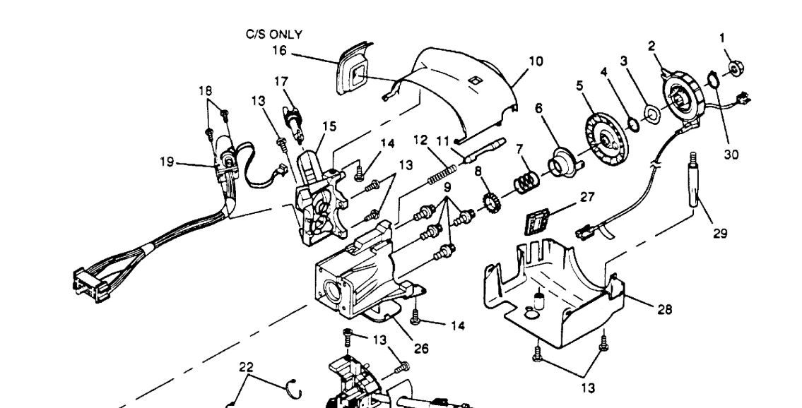

Steering column broke found an S10 steering column and put in it. The wiring harness does not match up with what is under the dash. Do I need to purchase new ignition switch with harness for the GMC Sonoma?

Yes, get the correct switch for your truck so the harness will mount directly to it. Check out the diagrams (Below). Please let us know if you need anything else to get the problem fixed.
