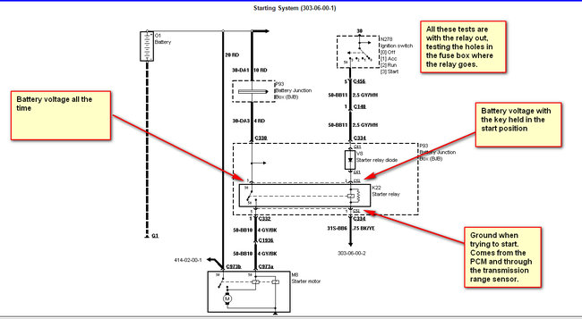

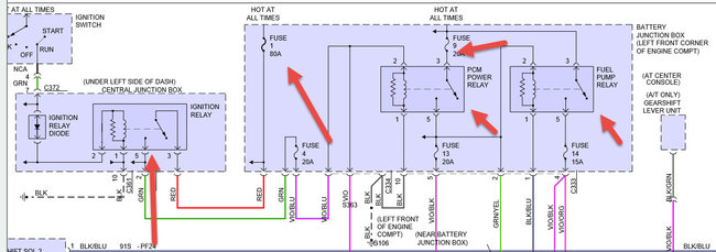

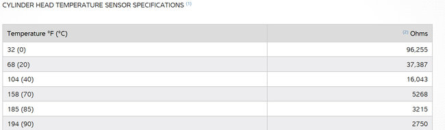

HMAC300
  • 48,601 POSTS
check ECT resistance it will be similar to cylinder head sensor in picture as temperature goes up on car resistance goes down. then check start relay under hood if not turning over see if power goes to both places. if no communication check fuses under hood and in car may have a blown fuse. check all items in pictures marked with arrows. also, check inertia switch behind left hand kick panel.

KEEZY DON HUNCHO
  • 11 POSTS
I used my multi-meter to test the starter relay in the power distribution box and it has readings that rose as high as .855. I used and old wire to connect terminals 85 and 37 and it cranks my starter. The fuse is not blown.

KEEZY DON HUNCHO
  • 11 POSTS
My Conjunction box has no slot for number five it is not in use in my manual. In my engine compartment (power distribution box) The Fuse number one is my main power supply it was giving my a rising reading when I connected my positive lead to it, and the negative lead of the multi-meter to the battery. My fuse number nine is my engine management and ten is starting, ignition, and headlamps. Those fuses did have resistance, and when i switch to check the current they did have power. I tested the fuel pump relay as well which I believe was the last arrow. left me a bit confused but I tested the relay as well as the terminal. I used a wire to run together terminals 85 and 37 and I can hear the fuel streaming threw the check valve located above the radiator hose.

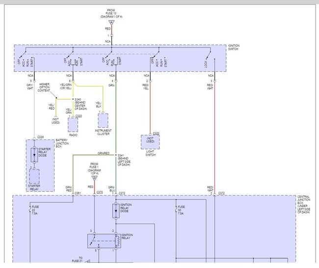

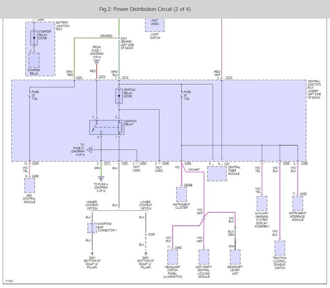

  • 55,051 POSTS
Hello KEEZY,
I will be taking over this question. Using you voltmeter test the input and outputs of the ignition switch to make sure it is working here is a wiring diagram to help you.
Test the power going in and the power going out once the switch is turning on. I believe the switch is down on the column.

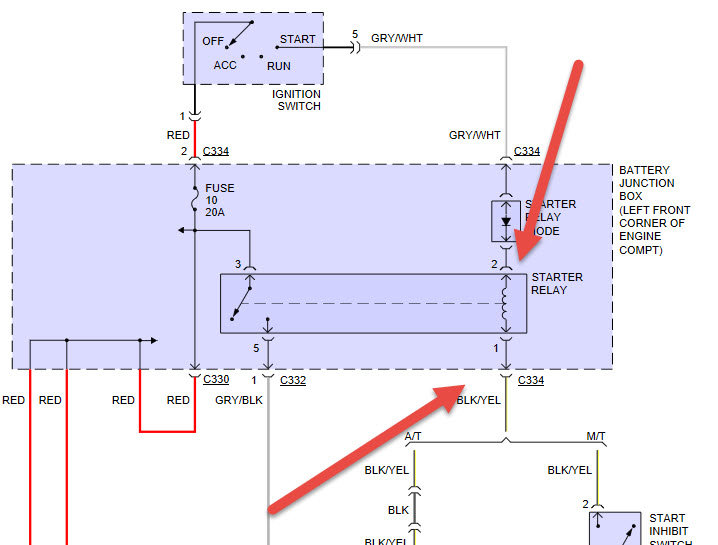

KEEZY DON HUNCHO
  • 11 POSTS
this is the diagram I used for the starter.
Feb 20, 2017 at 7:44 AM
  • 55,051 POSTS
Pin two having 2.6 volts is the problem if the key is in the crank position. It needs to have 12 volts.

  • 55,051 POSTS
Check fuse 10 in the fuse panel for voltage, and then pin 4 of the ignitions witch it leads right to the relay.
Feb 21, 2017 at 4:21 AM
KEEZY DON HUNCHO
  • 11 POSTS
Fuse 10 has voltage so do pin #5 on ignition switch relay
