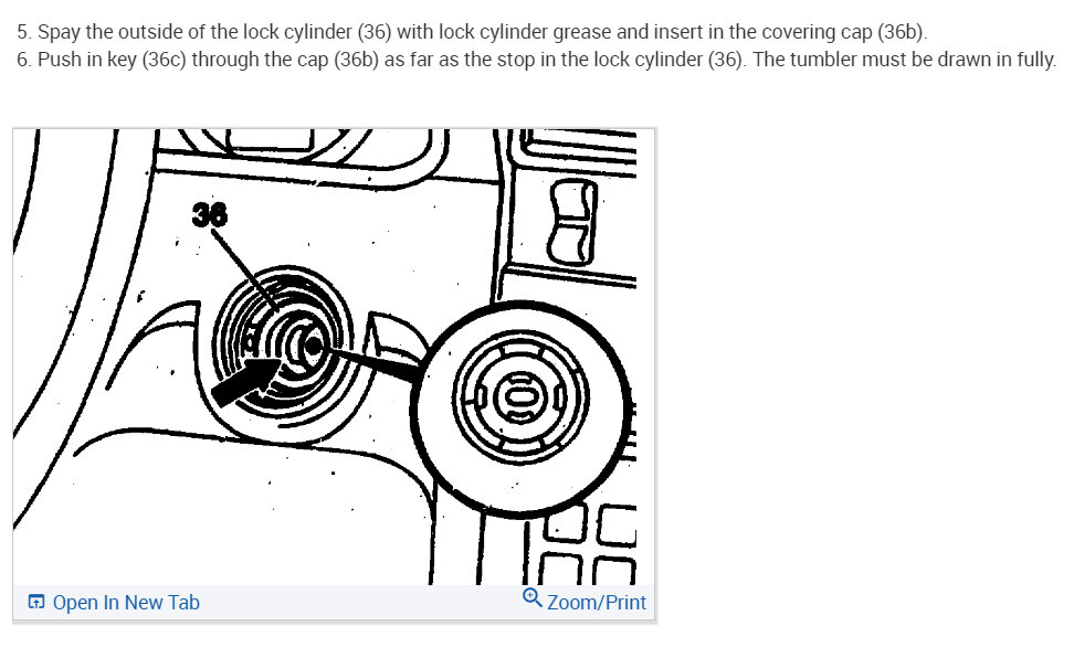

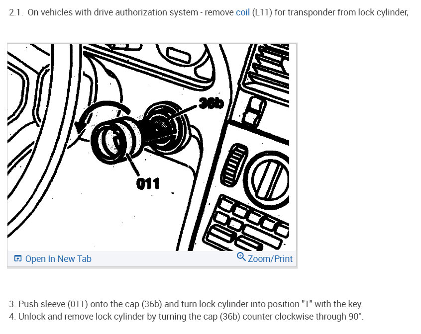

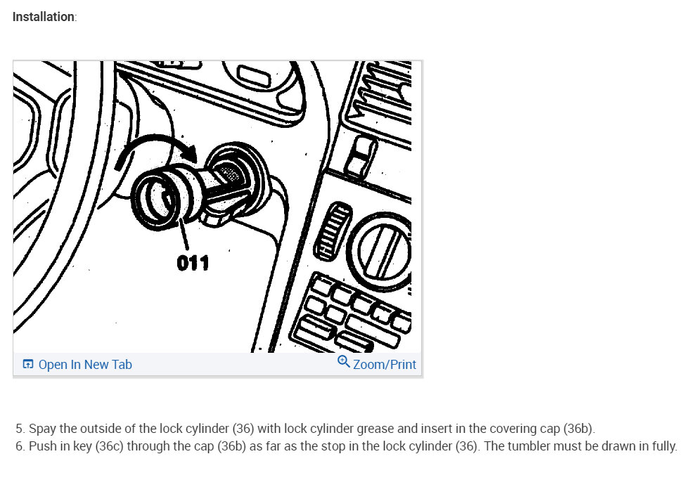

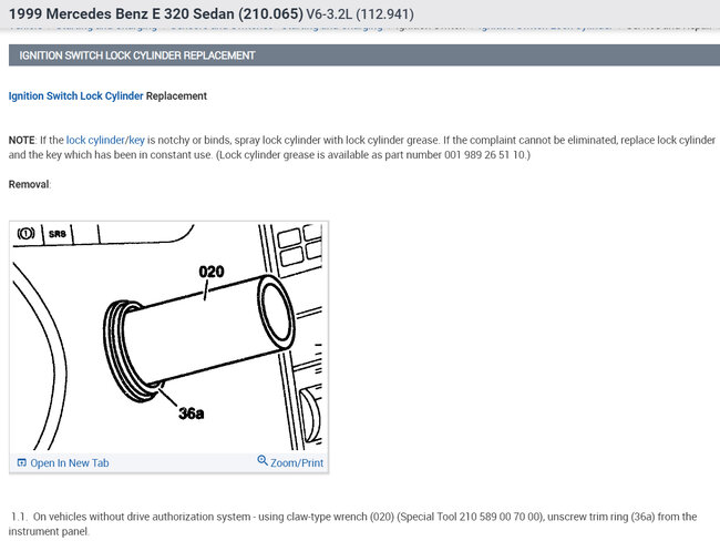

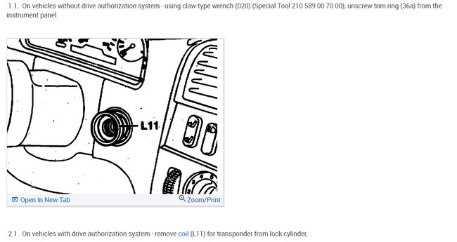

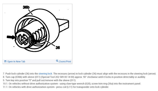

I lost the key and found someone that made a key, they pulled out the switch and now we can't put it back together.
Aug 11, 2023 at 8:07 AM
  • 55,711 POSTS
It looks like there is a special tool that is needed for the job but you might be able to rig something, please look at the ignition switch lock replacement images below. Please let us know if you need anything else to get the problem fixed.
