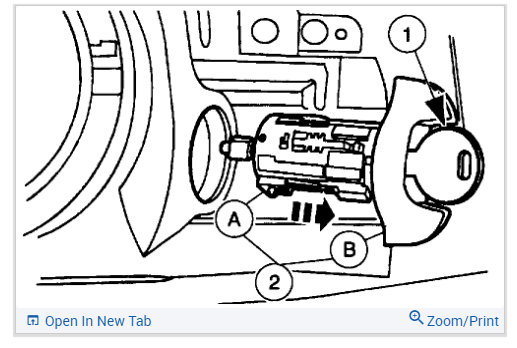

Are you referring to the pin behind the ignition switch? Meaning the pin that the tab at the end of the cylinder turns to start the vehicle? See the picture below.
If you can get a picture of what you are dealing with if this is not it, we can get on the same page. Thanks

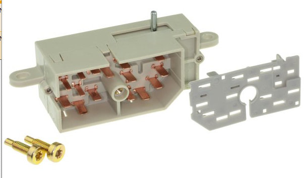

No, the pin on the rectangular white part (ignition switch) that has electrical cords plugged into it under the dash. When you turn the key it pushes the plastic ignition actuator which pushes the pin on that white plastic rectangle (ignition switch) that i described above. Can i unscrew the white rectangle ignition switch from under the dash and push the pin to start the truck?
Aug 13, 2020 at 11:59 AM
Sorry but I think we are calling things by different names, so I am not on the same page. Is this the part that you are referring too? If not, can you get a picture of it?
Aug 13, 2020 at 1:08 PM

I have never tried this but in theory that should work as the key cylinder moves this switch to engage the starter. As for the steering lock being released I am not sure about that because I have not done this. But again this should work but I have a feeling that Ford put in some redundancies that may prevent this. Again I am torn on this and would just say to try it because I am not sure what the difference would be from your finger versus the lock cylinder with the key. The only thing I can think is there is a circuit completed when you insert the key.

I did it and pushed the ignition switch forward (white rectangular box under dash) and it started right up. Steering wheel was free. Got to destination then pulled switch back and engine shut off. Weird how easy it would be to steal a 250 with just 2 screws.
