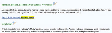

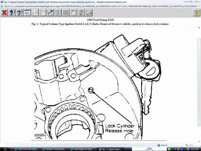

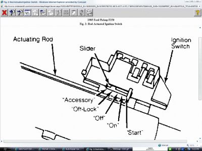

I need to replace my ignition switch. I want to do it myself. I need to know how its done.
Friday, December 21st, 2007 AT 12:28 PM
MERLIN2021
MECHANIC
17,250 POSTS
That's for the cylinder The instructions are for the switch....if switch only, don't remove sterring wheel!
