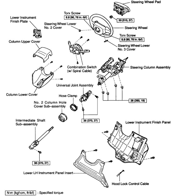

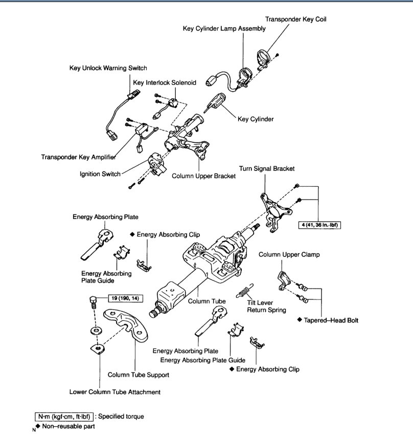

Removed key in accessory position, reinserted key and it will not move.
Aug 20, 2018 at 11:00 AM
  • 55,224 POSTS
It sounds like the key tumbler is bad and needs to be replaced. Here are diagrams to help you see what you need to do. You will need to get the part from the dealer they will program the key before they give to to you so have your VIN number ready.
