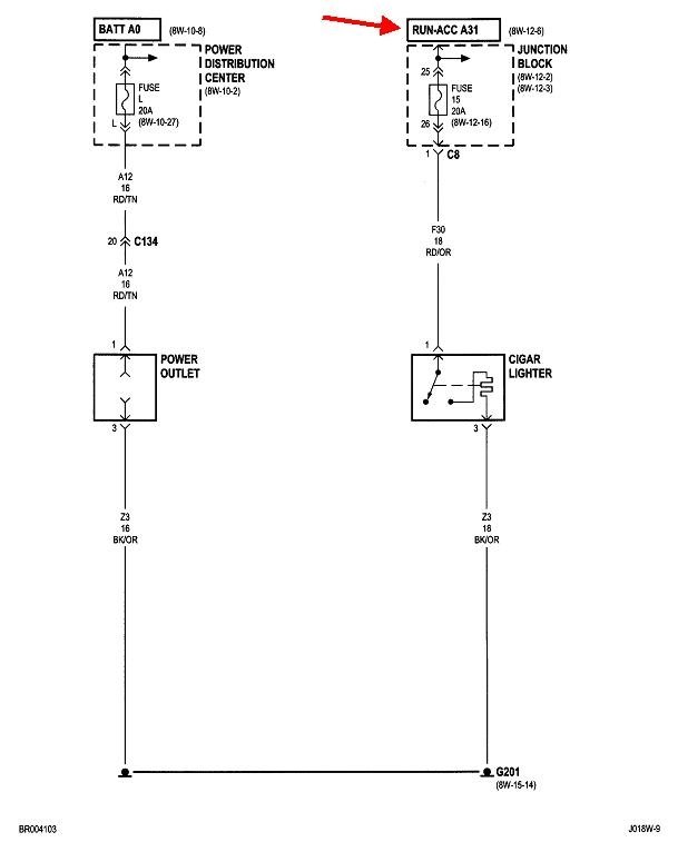

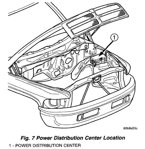

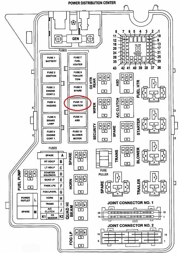

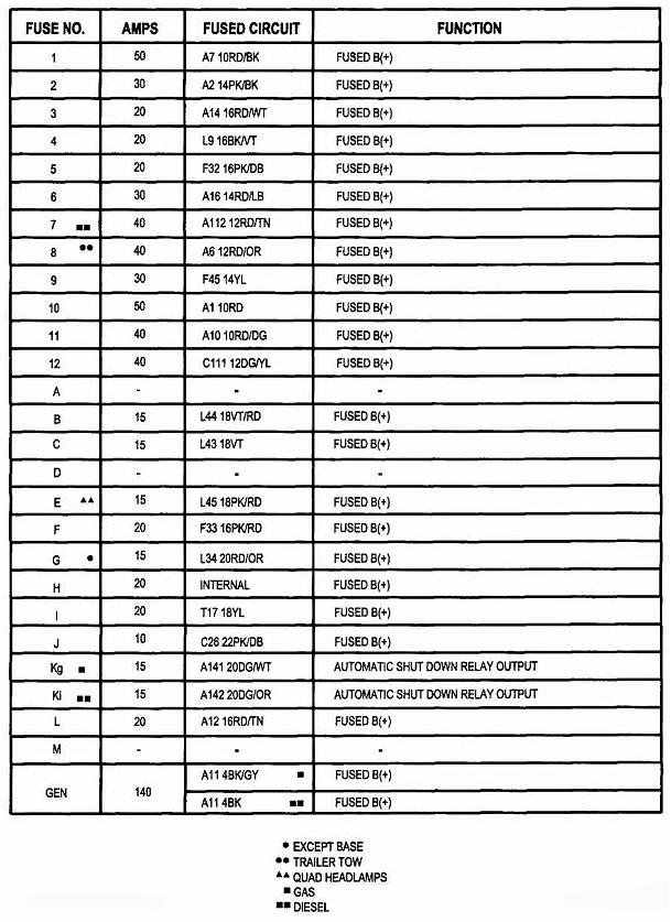

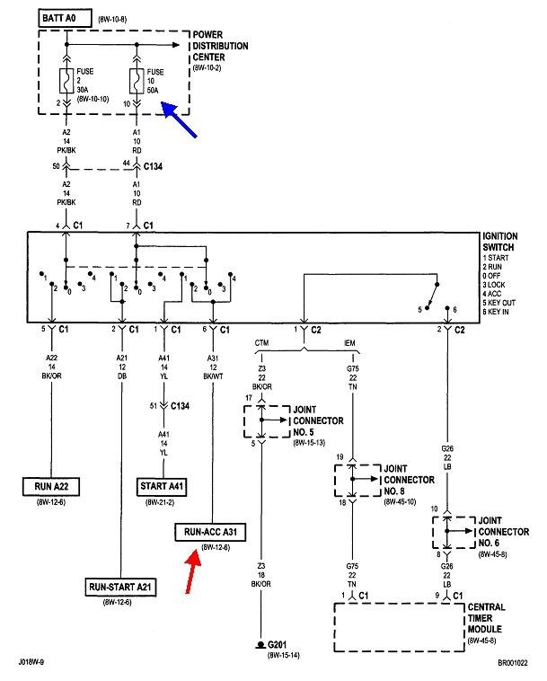

When so many things aren't working, it's easiest to just pick one circuit and concentrate on that. I picked the cigarette lighter circuit. If you follow the first diagram up to where it shows "Run-ACC A31" as the feed circuit, then it is continued on the next diagram coming out of the ignition switch. That section of the switch is fed from the Power Distribution Center on fuse # 10, a large 50-amp fuse. Check that fuse first, then tell me what you find.
Oct 21, 2019 at 11:33 AM
TLPITCH81
I was poking around before it got dark tonight and discovered there is no power on the red wire- which from what I can tell is the 50 amp breaker you mentioned. I was pouring over the wiring schematic and concluded exactly what you proposed. Yesterday I put an ohm meter on that fuse and got a good connection, but I will inspect it again.

The fuse you circled (#10) was the culprit! So glad that was a cheap fix!
I checked this fuse initially with an ohm meter, but it checked good. I decided to go back and check it again, it still checked okay but I noticed there was a rattle inside.. I took another 50a fuse (I think #1) and swapped them. Instrument cluster came on. Ran to the store and bought a new one, and now we're back online.
