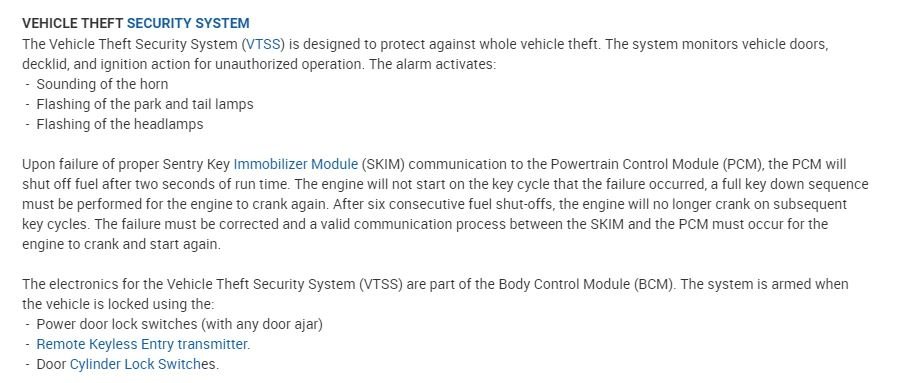

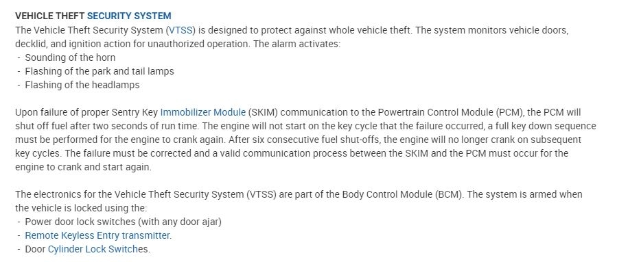

My security system light is on and my car won't start. what is the first step? I keep trying to reset it to start my car. then maybe next step after the diagnostic reads no number codes. How to just reset it?
Feb 23, 2020 at 6:57 AM
Good morning,

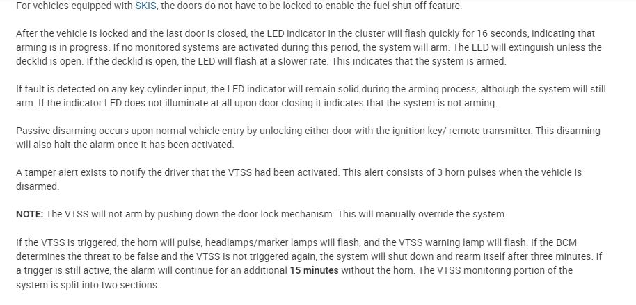

Do you have another key to try? It may be the key that is the issue.
https://www.2carpros.com/articles/how-to-reset-a-security-system

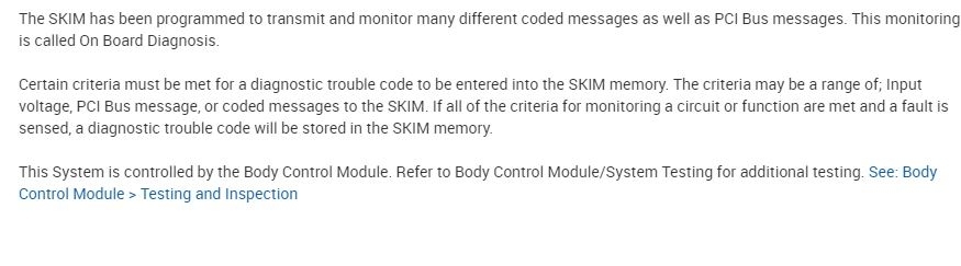

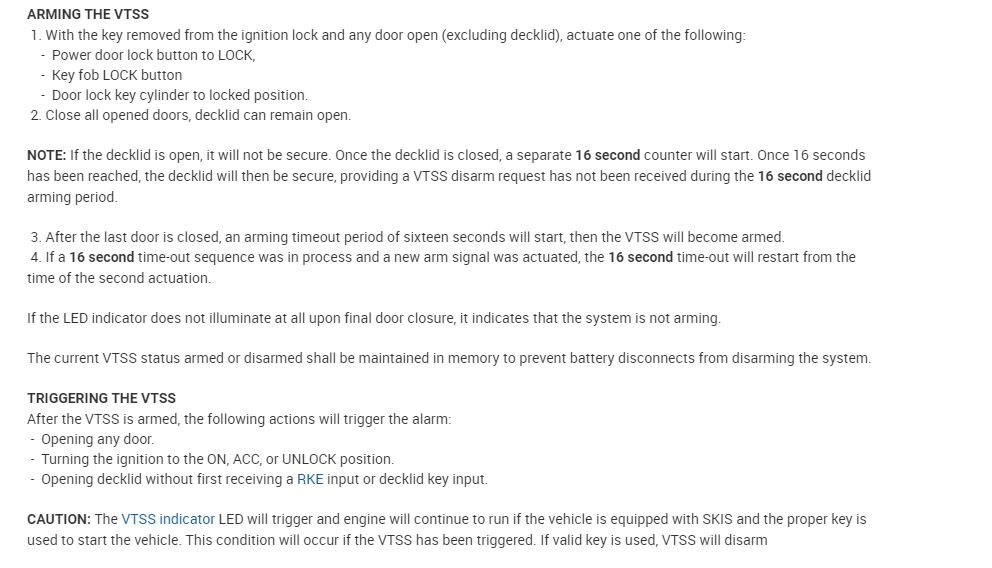

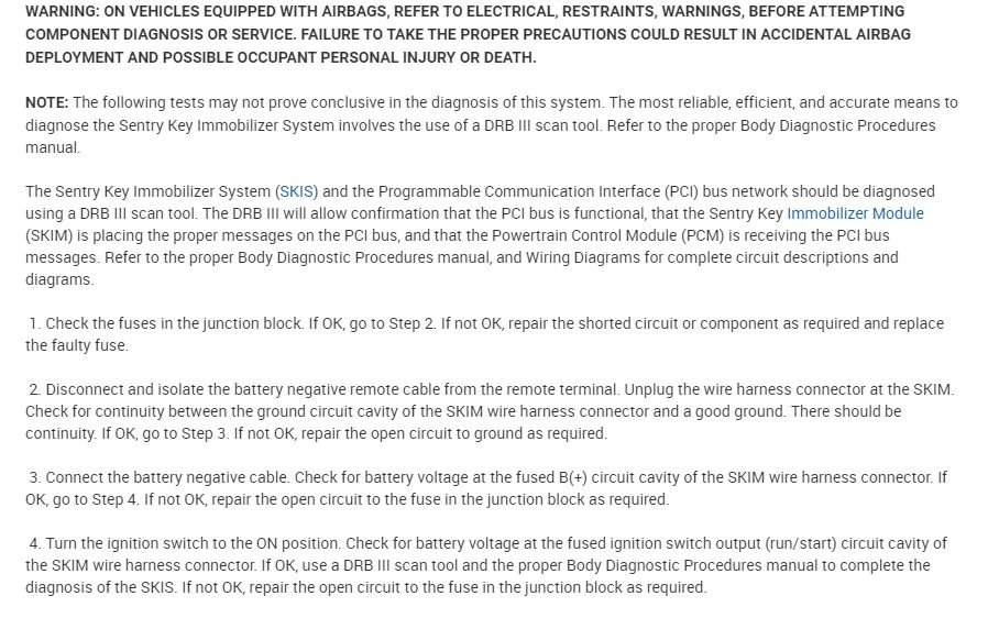

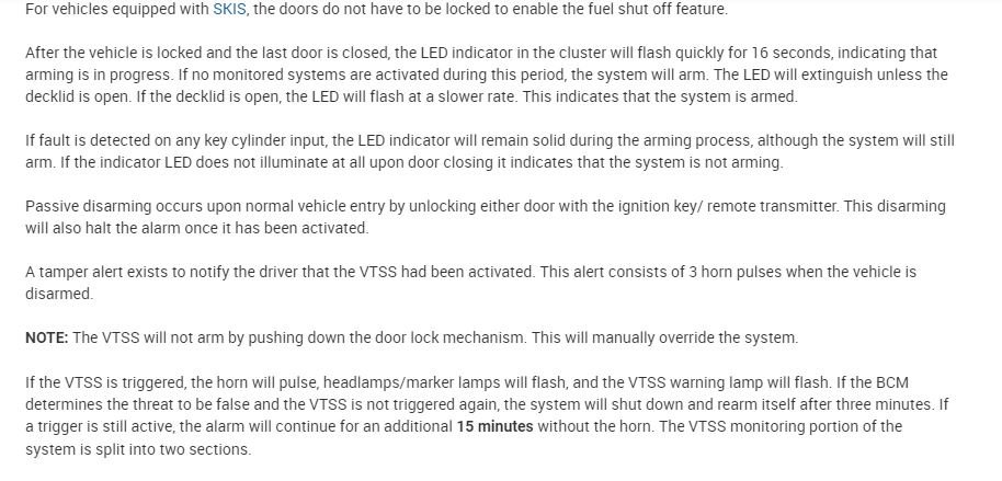

I attached a description of the system and some diagnostics to perform.
