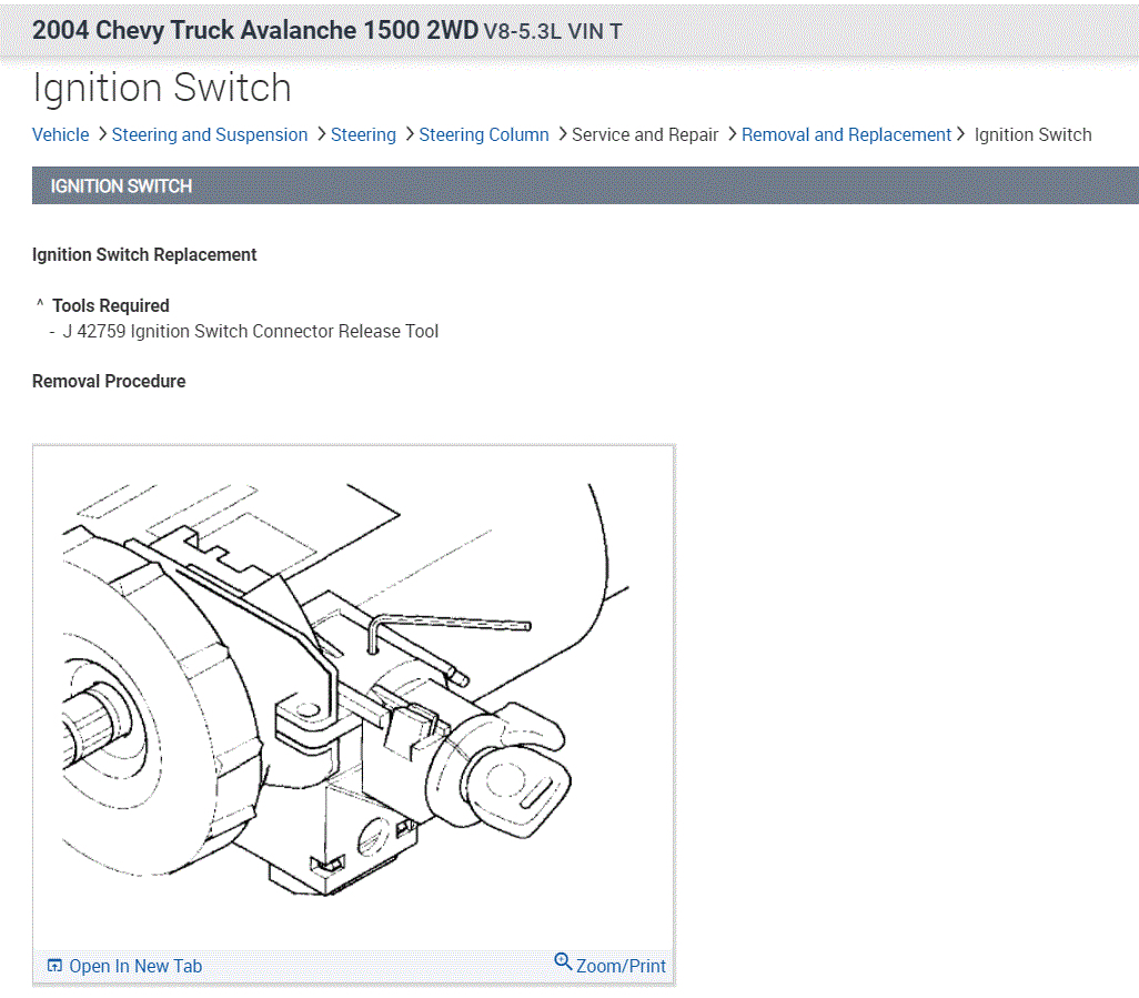

Ignition replacement without key how to do?
Dec 13, 2021 at 5:33 AM
  • 110,240 POSTS

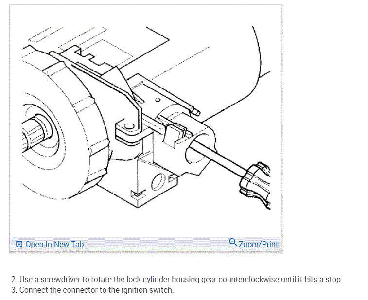

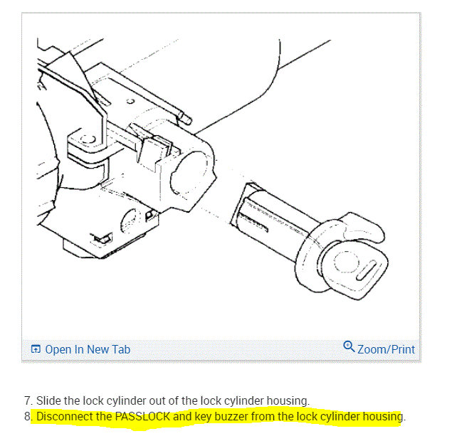

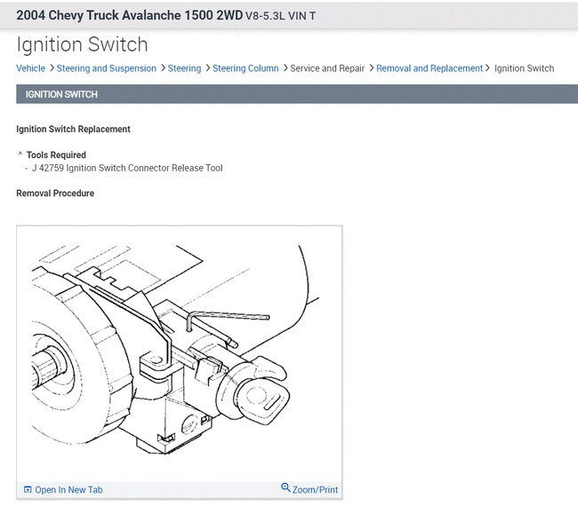

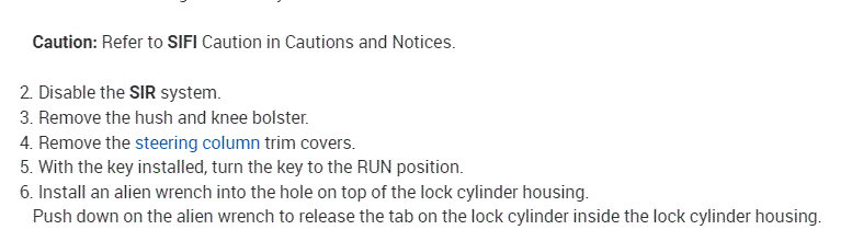

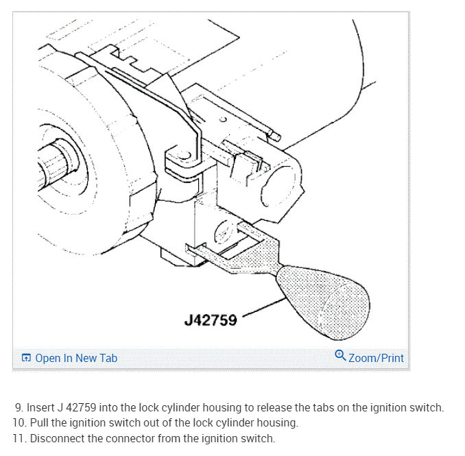

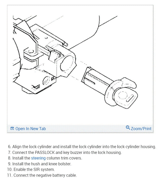

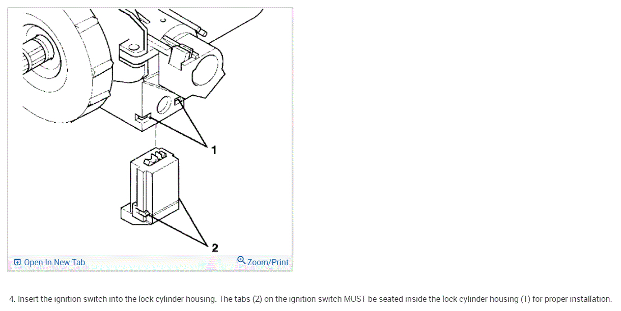

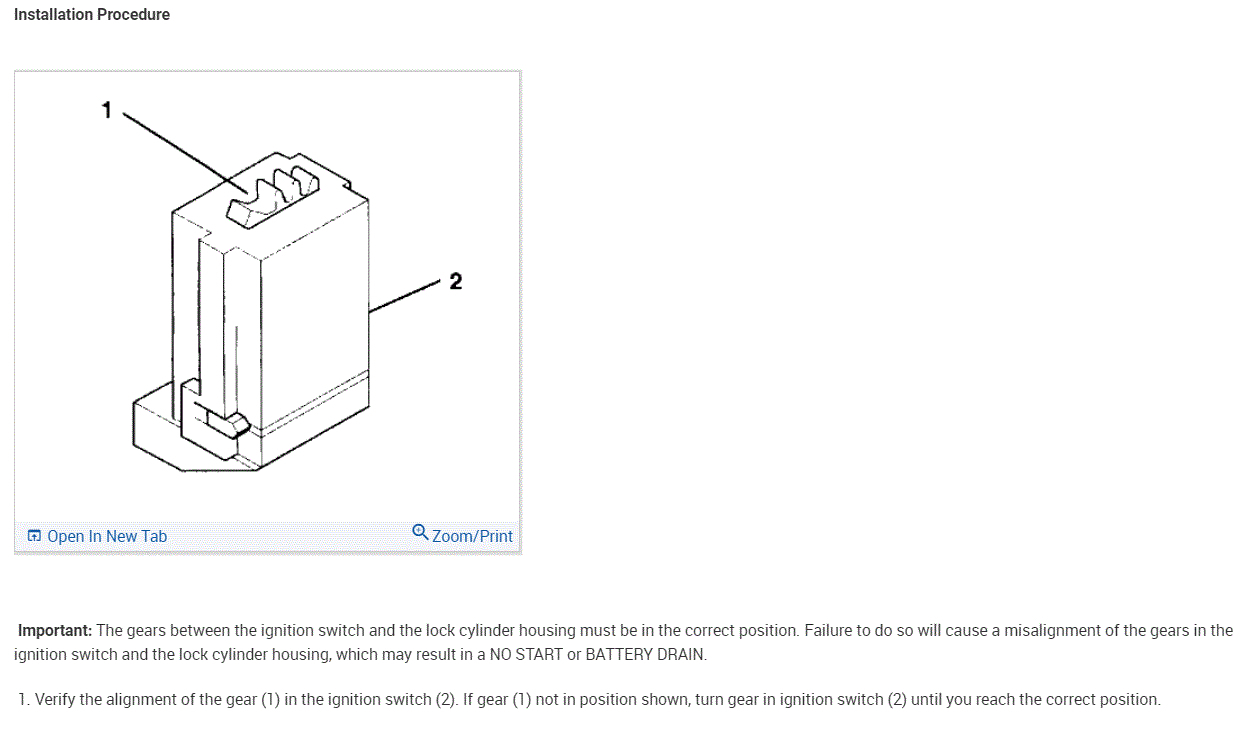

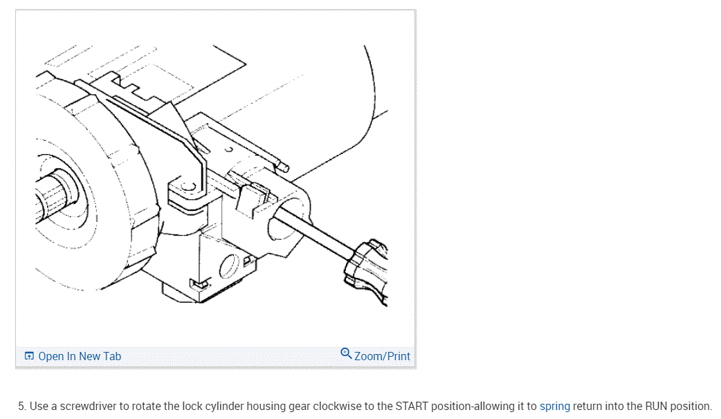

Since this vehicle has anti-theft, here is what I suggest: Have a cheap key made by a locksmith so you can turn the ignition lock cylinder. If you try breaking it to turn, it could damage other components and lead to more problems.
I attached the directions below explaining how to replace the ignition switch. If it was the lock cylinder that needs to be replaced, let me know.
