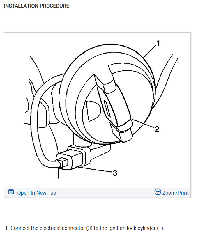

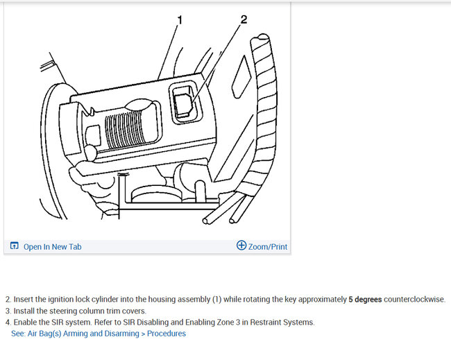

Yep, the ignition tumbler gears need to line up for the switch to activate correctly. If you can upload images of the problem, it will help me to see what needs to be done. Here are the instructions on how to reinstall the new key lock tumbler for the ignition switch. Check out the images (below). Let us know how it goes.

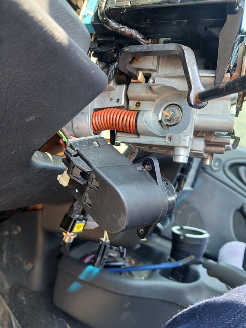

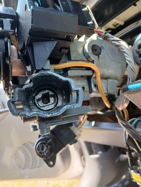

Okay, I have removed the ignition switch, but that middle piece still won't come out. So, as it's sitting right now the key and lock cylinder are out and so is the ignition switch. What are my next steps?

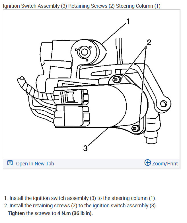

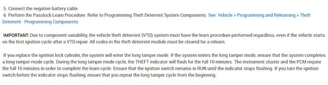

Thanks for the images. I would reinstall the ignition switch part (first picture) two screws. Next, use a long, large standard screwdriver and work the ignition key tumbler engagement slot to confirm the switch is working correctly. Next, orientate the tumbler so the slot and the tab of the tumbler line up and then install the tumbler, and you should be good to go, make sure to install the pass lock sensor or the security system will not disable. That brings us to the programming:
Turn the key to the ON position (do not crank) and leave it ON for 10 minutes.
The security light will stay on. When it turns off, continue.
Turn the key to OFF for 5 seconds.
Repeat steps 2 and 3 two more times for a total of 3 cycles / 30 minutes.
If this does not work, you will need to be done by a locksmith for about $150.00.
Please upload pictures or videos in your response of any problems.
