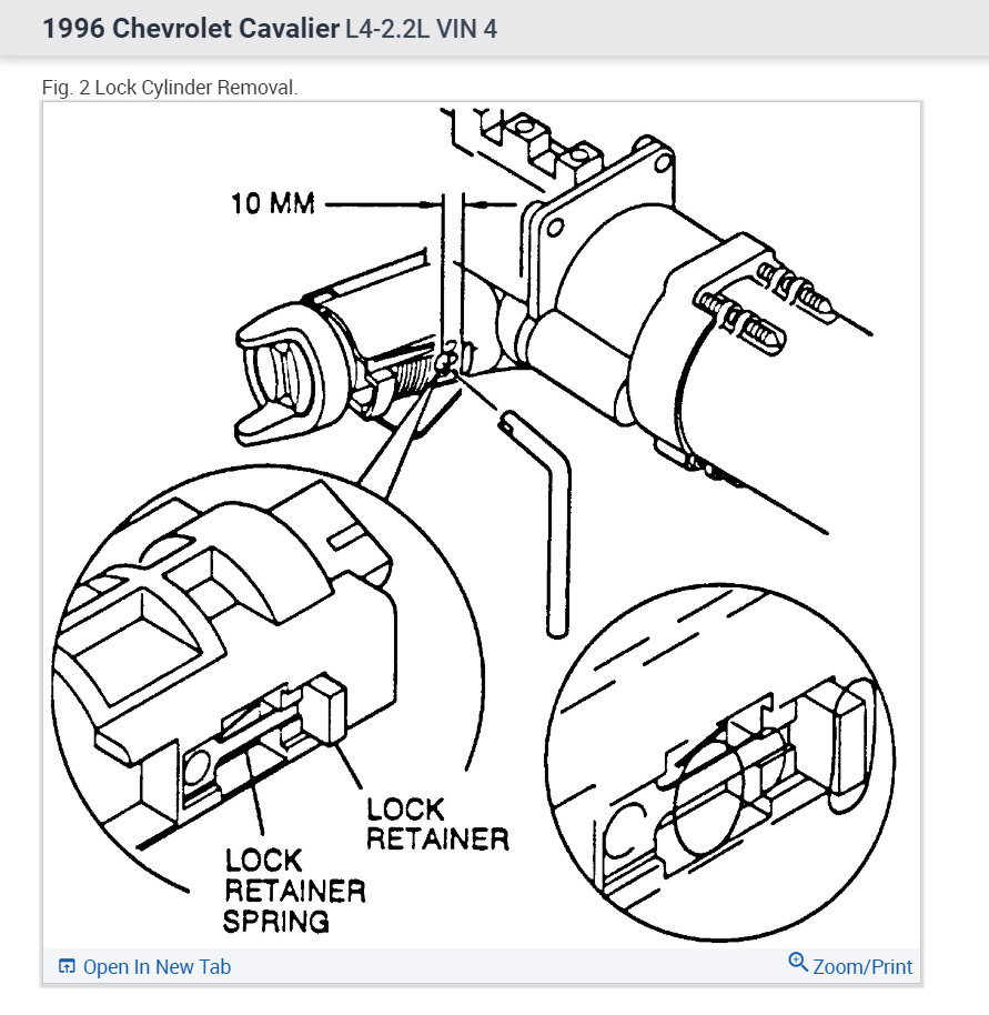

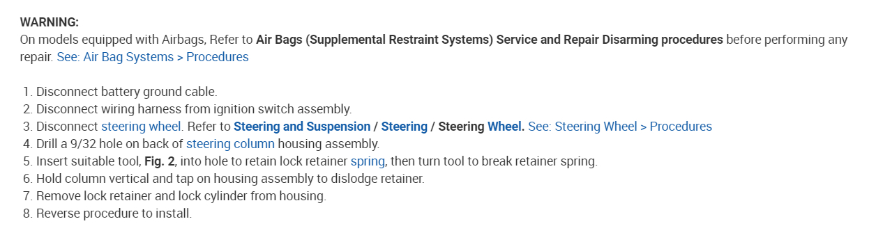

Lost the only ignition key.
Oct 17, 2024 at 6:29 AM
  • 55,423 POSTS
No problem, here is how to change the ignition lock out with a new key, you can get a replacement from amazon. Here is a link for $16.00:
https://amzn.to/4f60WwK
Here is how to install it. Check out the images (below). Let us know if you need anything else.
