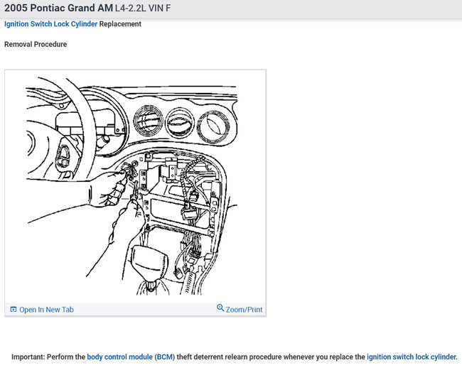

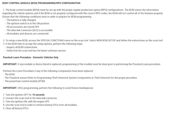

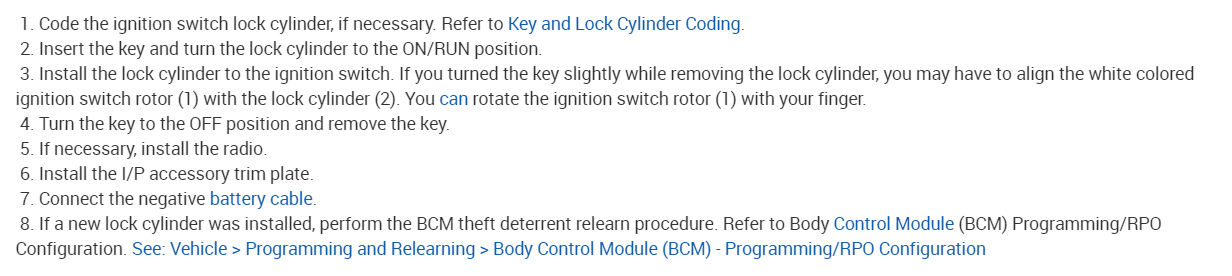

We were able to remove it. Got a new ignition and key. Put it on. We noticed the dash does not light up at all with the new ignition and key. We tried to follow the 3-step cycle for the re program without the light flashing. But it did not work.
Jun 30, 2023 at 9:18 AM
  • 55,456 POSTS

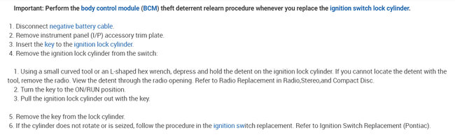

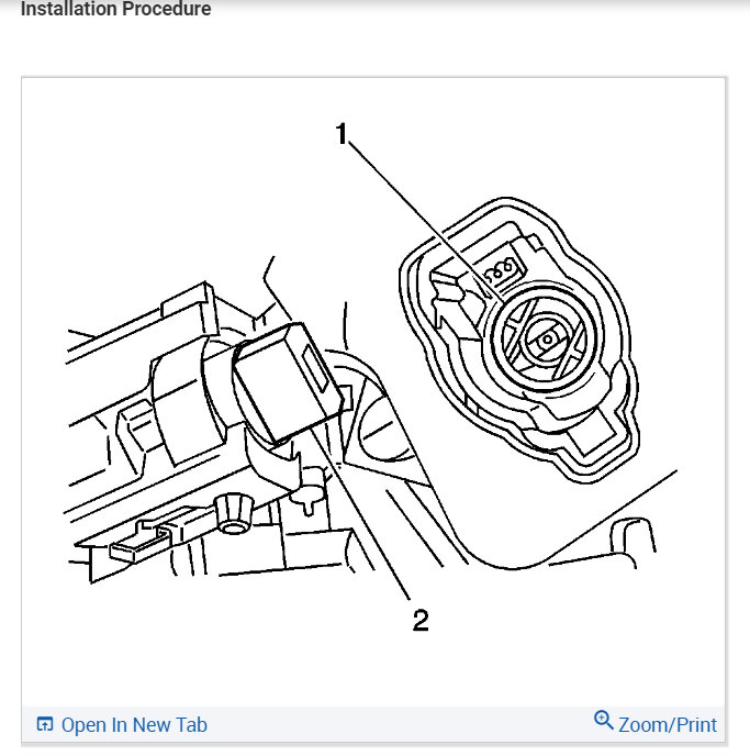

So, there is a gear that needs to be reset within the switch when you are replacing the ignition lock, or the switch will be fully activated. Here are the instructions on how to correctly replace the switch. Also, when you installed the new switch was the key programmed before installation. Check out the images (below). Let us know what happens and please upload pictures or videos of the problem so we can see what's going on.
