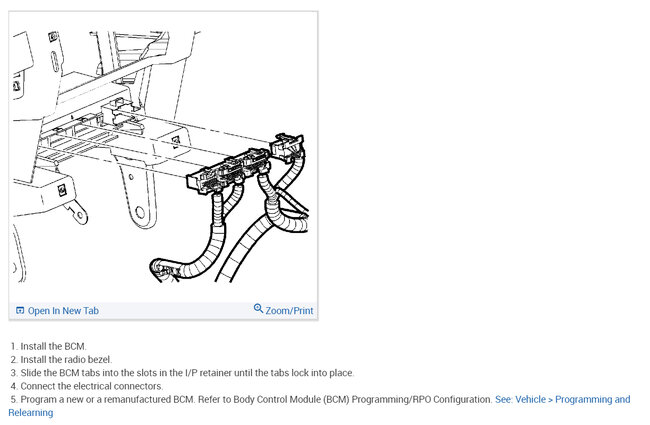

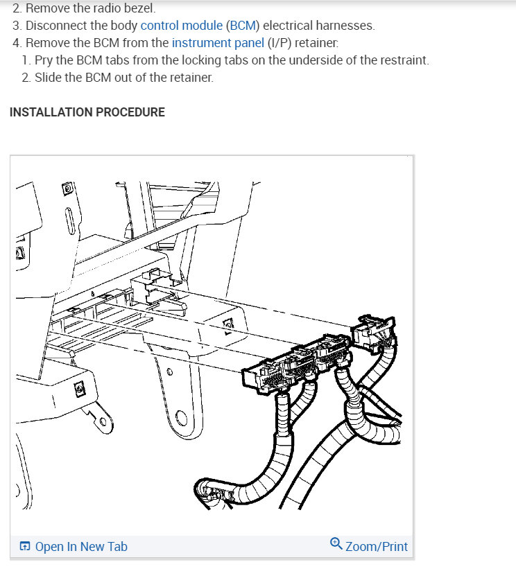

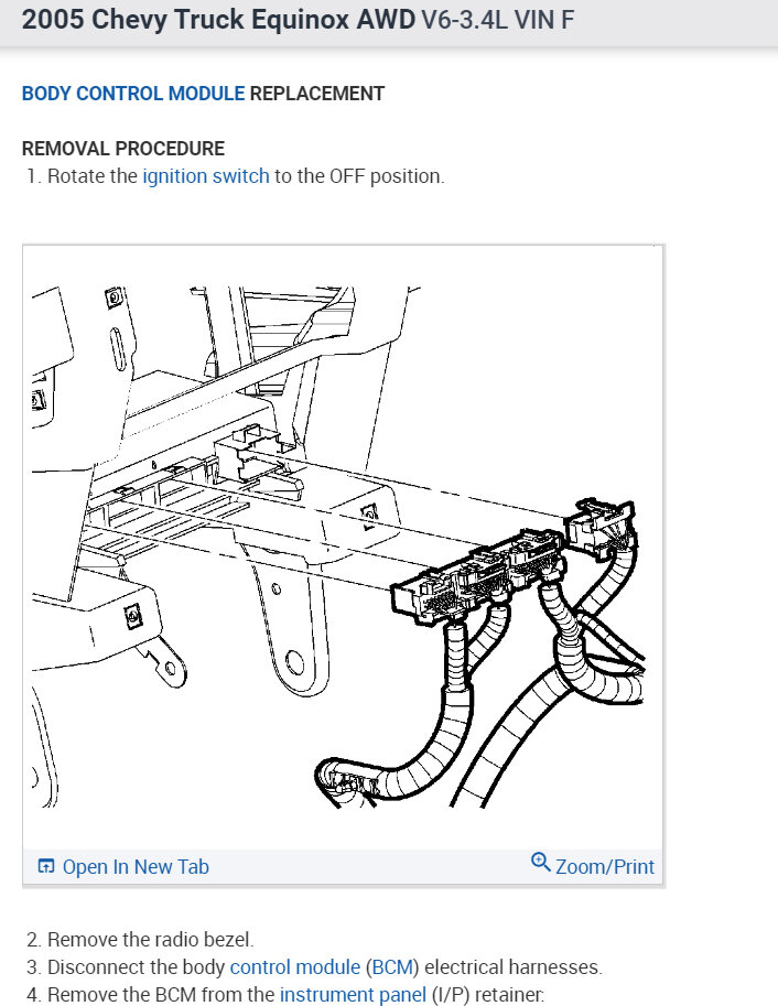

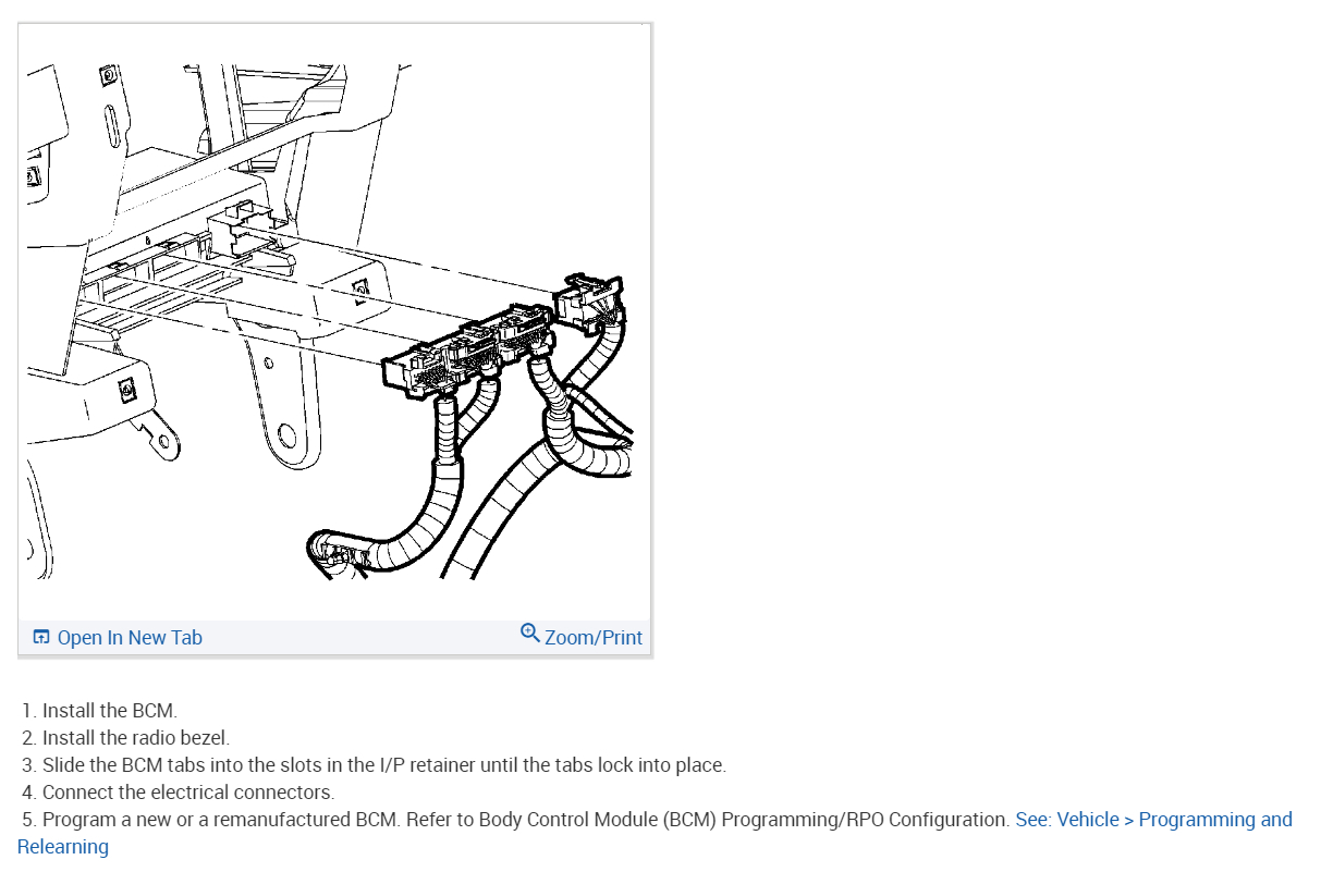

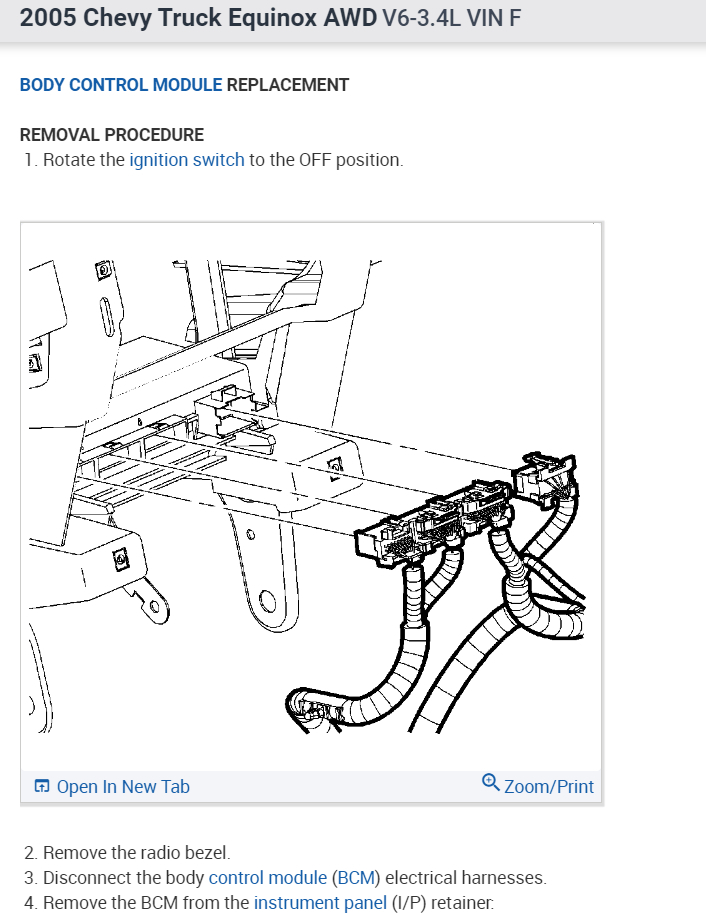

The fact that the BCM has 71 codes means it is bad, here is how to change it out, you can get a preprogrammed unit by searching Google or Ebay. Check out the images (below). Please let us know if you need anything else to get the problem fixed.

Okay. That does make sense.
It just seems strange that the vehicle was having all sorts of engine-related issues. Codes for the camshaft position sensor, crankshaft position sensor, shifting issues, ignition circuit issues. And many other codes. I finally had to do something when the car went into limp mode!
I used an XTool D9 scanner schematic to learn that the BCM is full of codes. But do you still think it's the BCM, even though the symptoms are engine-related?
Thanks so much Ken.

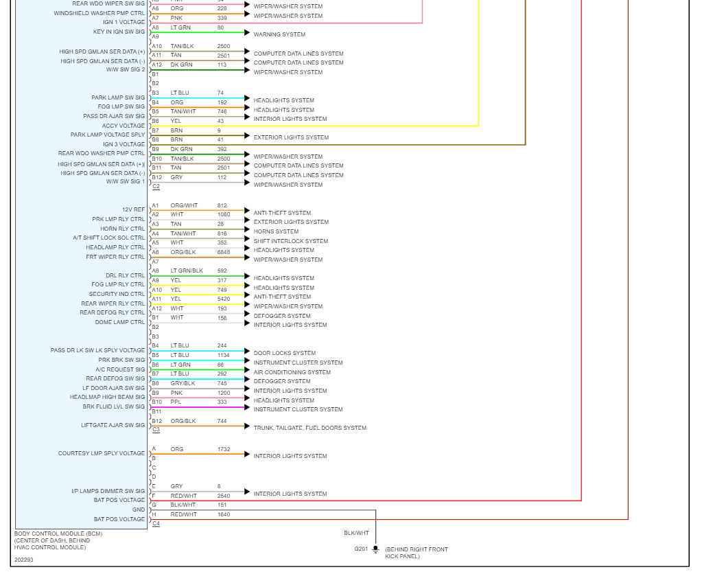

Yep, I understand, yes, the BCM can cause issues within other systems inside the CANBUS. The fact that it has so many codes, it sounds like the BCM is bad, but you may want to check the ground and power circuits.

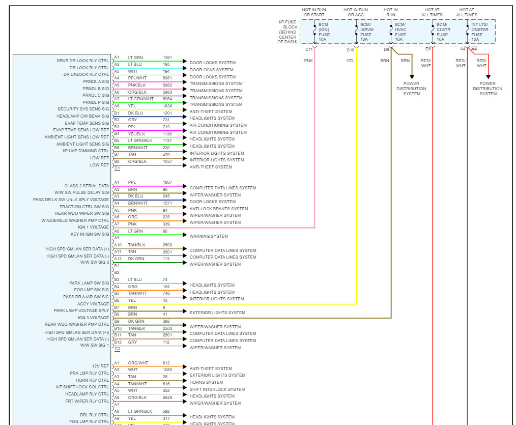

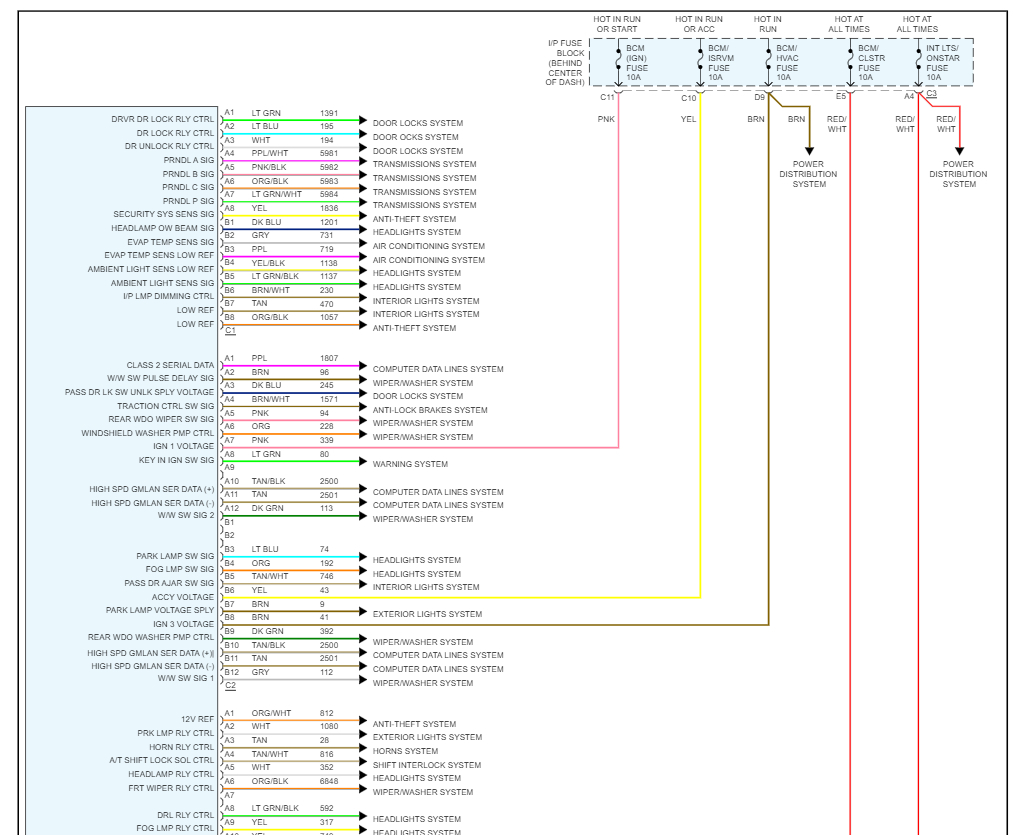

here is a guide to help and the BCM wiring diagrams below which will show you which wires to test:
The ground is behind the right kick panel. Check out the images (below). Please let us know what happens.

I cleaned the ground and confirmed that we've got a solid ground from the BCM to the chassis.
I tested the "IGN 1 Voltage" and the "IGN 3 Voltage" coming from the fuse box. I don't know what these designations mean, but both the pink wire and the brown wire coming from the fuse box are carrying good voltage.
The two red "Battery Positive Voltage" wires are also carrying good voltage.
I'm guessing my next step is to send in the BCM for testing.

I sent in my BCM for testing, and they said that it was bad. They replaced it with a remanufactured BCM.
I installed the new BCM and went through the relearning or reprogramming process (a series of turning the key to the start position and waiting and repeating). From what I recall, there was a lock light on the dash immediately after I installed the BCM, but the lock light disappeared after I went through the process. However, the car still does not start. I am not able to jump it anymore either. It fires up, but then dies after about 2 seconds. I had a mechanic friend of mine look at it. He put his computer on the vehicle and found very confusing results. The computer could communicate with some modules, but not with others. We also found apparent aftermarket components and repairs in the electrical system/security system.

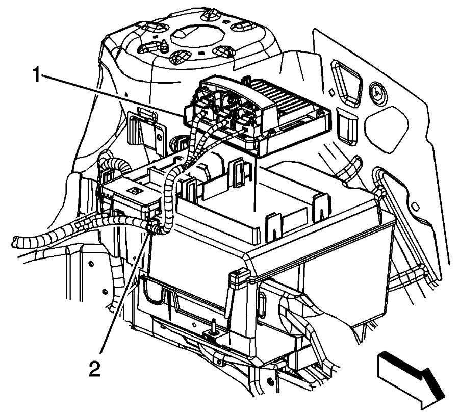

You might want to send out the PCM as well, also was this car in a flood? Here is the location of the PCM so you can send it in as well. Thanks for getting back to us. Check out the images (below).
