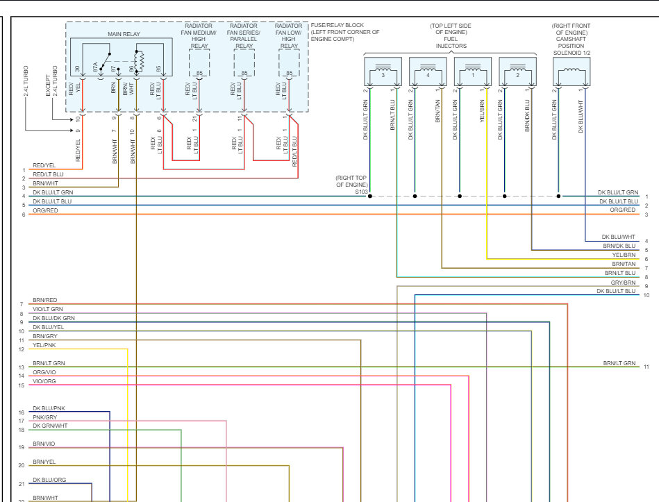

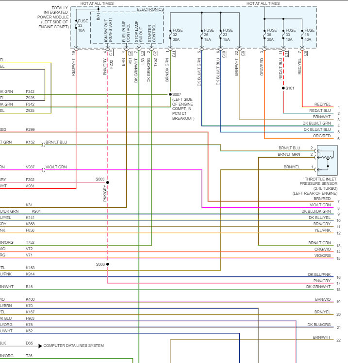

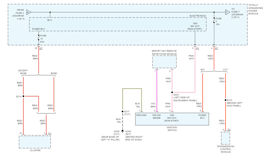

ignition relay wiring diagram needed?
2008 DODGE CALIBER
190,000 MILES • 2.0L • 4 CYL • 2WD • AUTOMATIC
POSSUM0459
The relay box was smashed, and I had to rewire the relays. replaced the relay after this and got car started but did not connect all wires as do not know where they go. need a wire diagram as I cannot find one online.
Sep 17, 2023 at 11:27 AM
  • 55,433 POSTS
I don't not see an "Ignition relay" so I am not sure what you are talking about, here are the relays that run the system. Check out the images (below). Let us know what happens and please upload pictures or videos of the problem so we can see what's going on.
