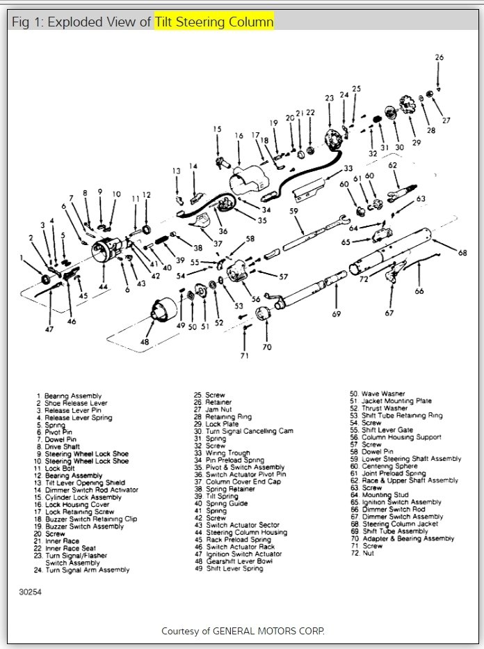

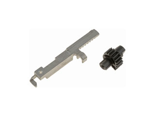

Ignition rack broke on my 1/2 ton two wheel drive no tilt. I found a replacement part but it is not a exact fit. The Dorman 83221 looks right but is too wide. Any suggestions?

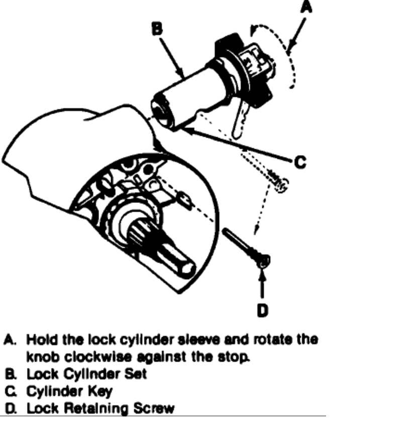

Here is some diagrams on what you are in for, you will need a special puller to the the tilt pins out and the steering wheel off.
Let us know how it goes.

I have the column apart and have the broken rack/actuator out can't find the right replacement part.

You may need to go to the dealer, they are the only ones that have the correct parts for the column.
