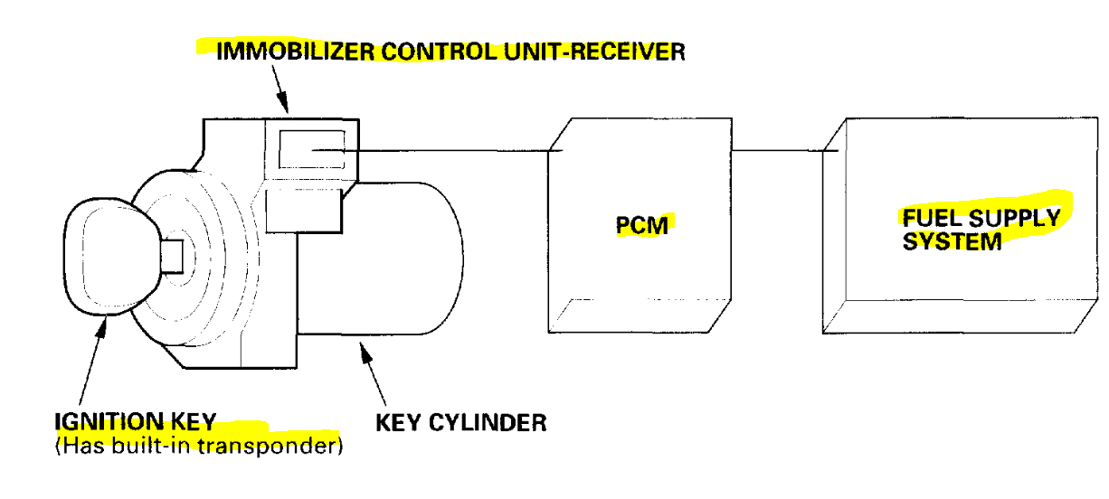

I replaced the ignition lock cylinder and the keys that came with it will turn the car over but won’t run.
Apr 1, 2023 at 10:09 AM
  • 110,248 POSTS
If you replaced the key cylinder, that means you have a new key. If it isn't programmed to be recognized, the engine won't start. See pic 1 below.
In this case, either the vehicle's immobilizer needs to be programmed to recognize the new key. That will require either a locksmith or a dealership.
Let me know if the programming has been done or not.
Apr 1, 2023 at 12:33 PM
SHANERODEN96
No, it hasn’t, I did it myself.
Apr 1, 2023 at 12:34 PM
  • 110,248 POSTS
That is the issue. Are you able to get it taken care of? Also, just FYI, it is usually less expensive to have it done by a locksmith, but you would need to check where you are located.
