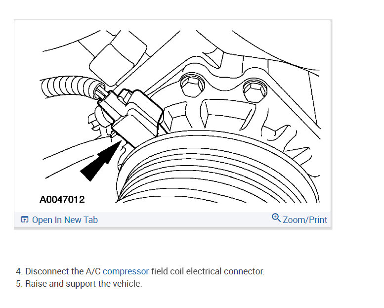

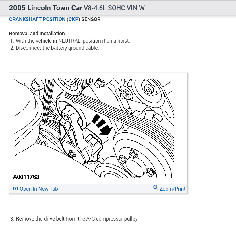

Where is the Ignition pulsator ring located?
2005 LINCOLN TOWN CAR
162,786 MILES • 4.6L • V8 • 2WD • AUTOMATIC
JASONREILING
Jan 28, 2023 at 3:40 AM
  • 55,423 POSTS

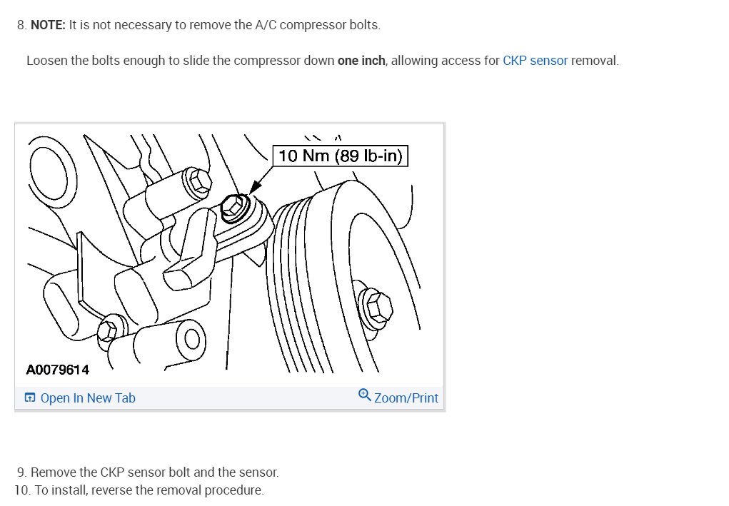

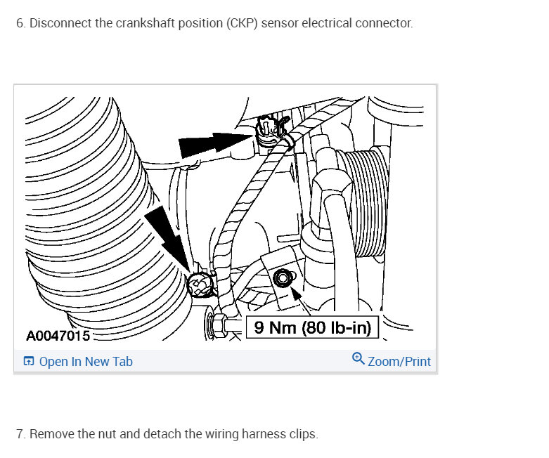

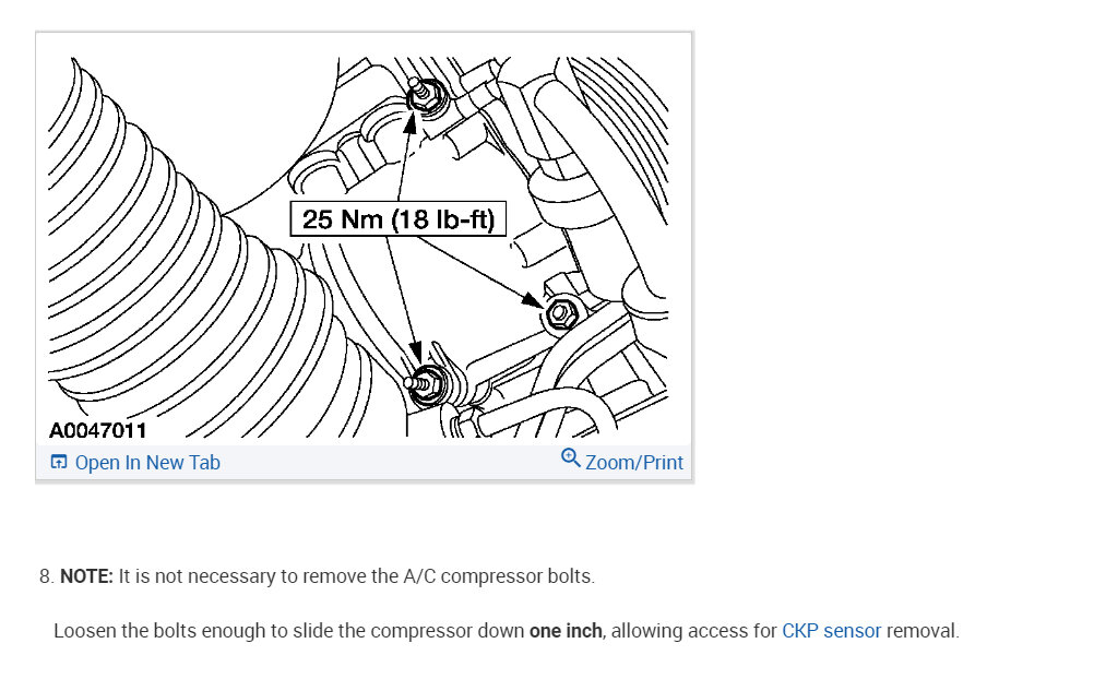

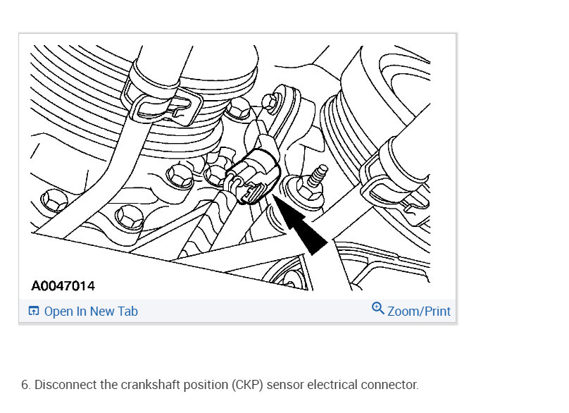

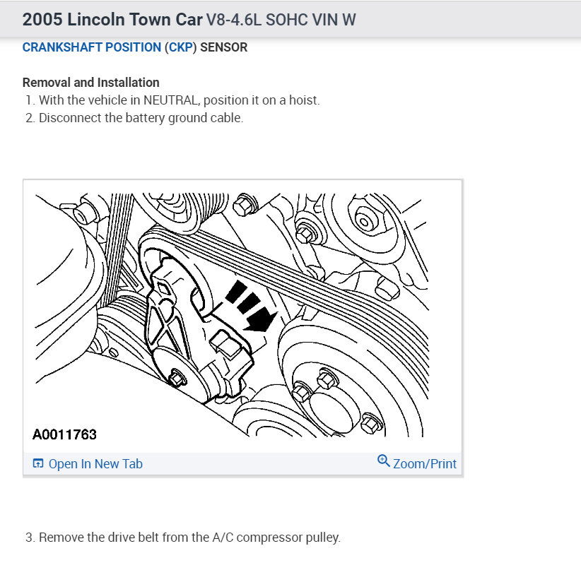

We are not sure what you are saying "Ignition pulsator ring" is it for the ignition system or the ignition key? Here is the crankshaft angle sensor location and replacement instructions in case this is what you meant. Check out the images (below).
