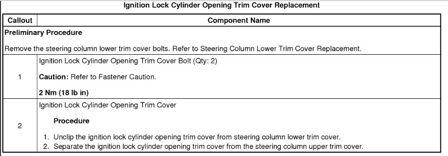

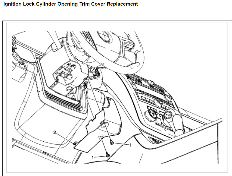

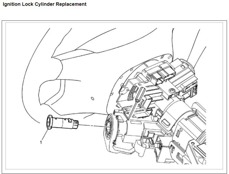

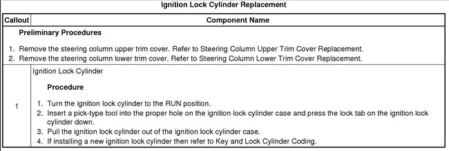

Here are diagrams to help you change out the ignition tumbler.
