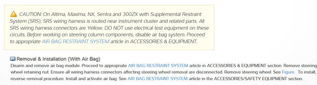

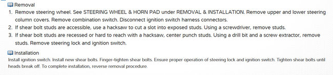

How do I remove and replace my ignition switch with a new one?
Tuesday, December 6th, 2016 AT 3:41 AM
HMAC300
MECHANIC
48,601 POSTS
See pictures. If you have an airbag it has to be disabled and it is highly recommended you have a professional do this.
