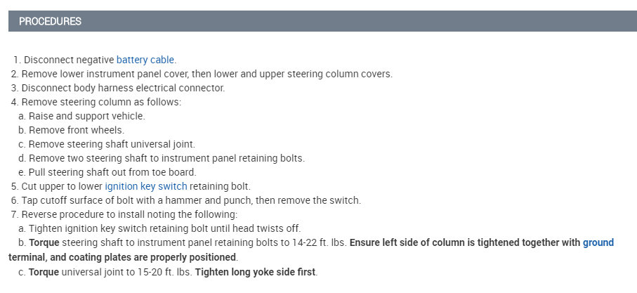

When I turn the ignition on,there is nothing. There is no power. if I turn the ignition on again,and leave it in the “on” position for about three seconds,it fires up,and runs fine. what could be causing this?
Oct 30, 2019 at 10:13 AM

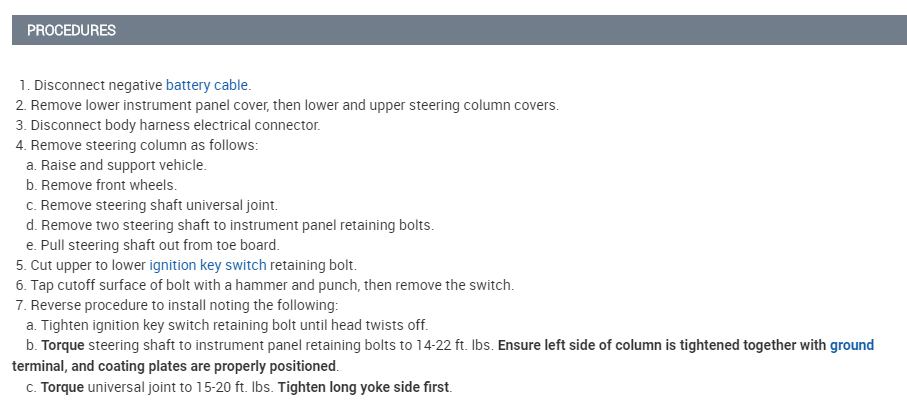

This does sounds like an ignition switch issue. Leaving it on for 3 seconds sounds like a control module issue but I am not sure how that would be the issue so I would suggest replacing the ignition switch and go from there.
I attached the procedure. Let me know if you have question.
