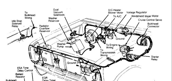

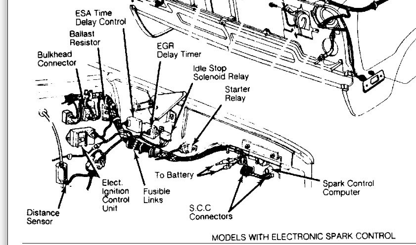

I got this old Dodge previous owner races drag cars so is more mechanically inclined than myself. I cannot find the ignition module to replace it. Is there a way to jump past it or not? because it seems every diagram I look up I cannot find it on the truck.

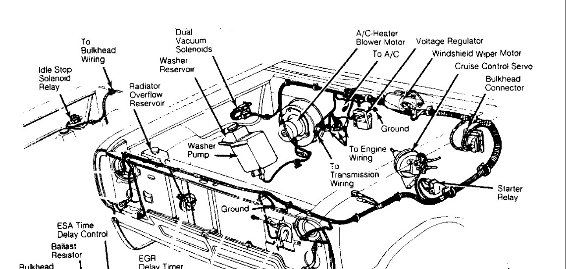

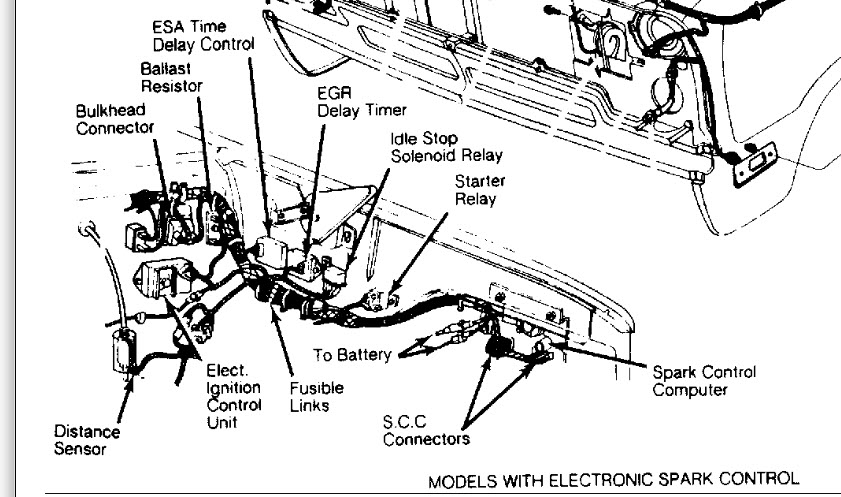

I gave you most of the stuff under hood it is on passenger side and has a screw holding it in with a five way connector. See pictures.
