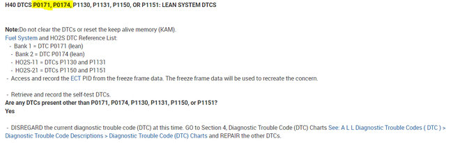

Based on the codes and your description, it sounds like a fuel pressure issue or there are more vacuum leaks you are missing.
If you haven't already, check fuel pressure. I have a feeling it is going to be low. If you look at that attached pic, it is a portion of the diagnostics. It indicates a lean condition on both banks. So, either we have low fuel pressure, a false reading from the ECT, or there is another vacuum leak.
Recheck for other vacuum leaks. Here is a link you may find helpful:
Next, here is a link that shows how in general to test fuel pressure:
Because it is a lean mixture, I don't see it as a problem related to the ignition.
