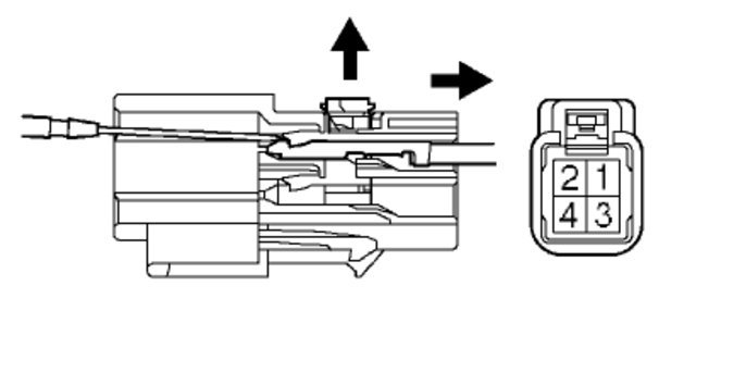

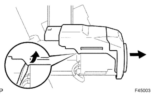

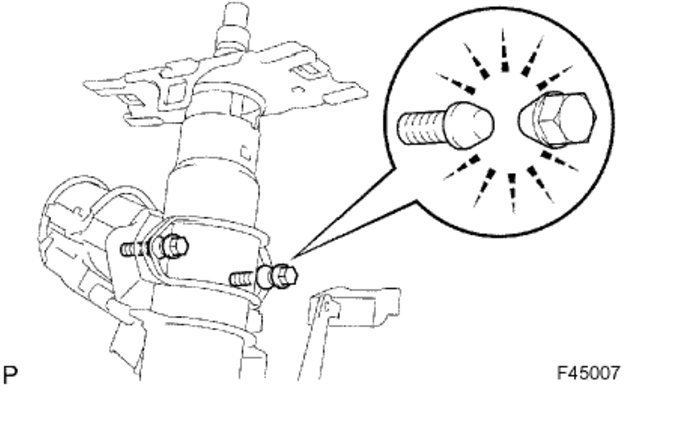

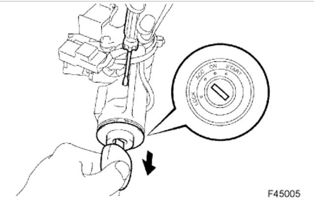

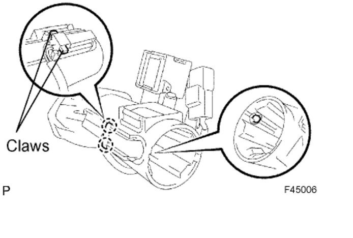

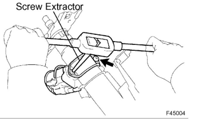

This is common when the ignition cylinder goes out. I would get a new one from the dealer while you give them your VIN number so they can code it for you before installation. Here are instructions and diagrams to help you get he job done. Check out the diagrams (below). Please let us know what happens.
